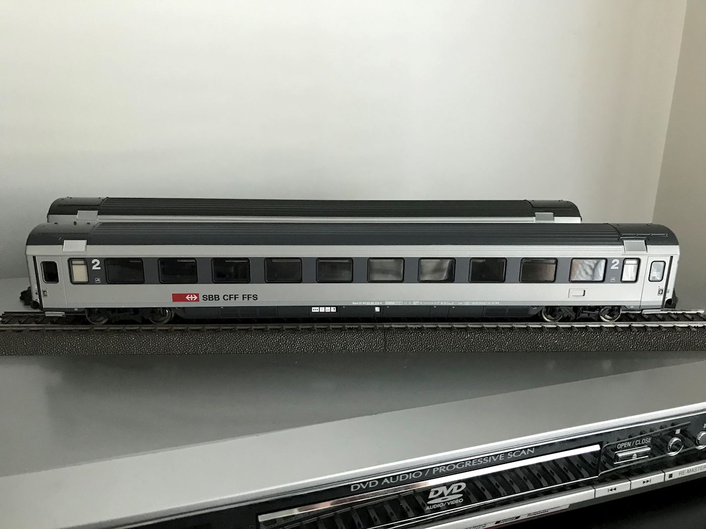

Here are more photos from the web and mine:
LSM (L) and Roco (R) Bpm in ex-Cisalpino livery. You can clearly see the Gray Band on the Roco model.
You can also see that the LSM model includes a representation of the sealed waste tank located at the coach end(s).
LSM (L) and Roco (R) Apm in ex-Cisalpino livery. You can see the Gray Band on the Roco model.
You can see the differences in the details of the bogies as well as the slight difference in height of the models

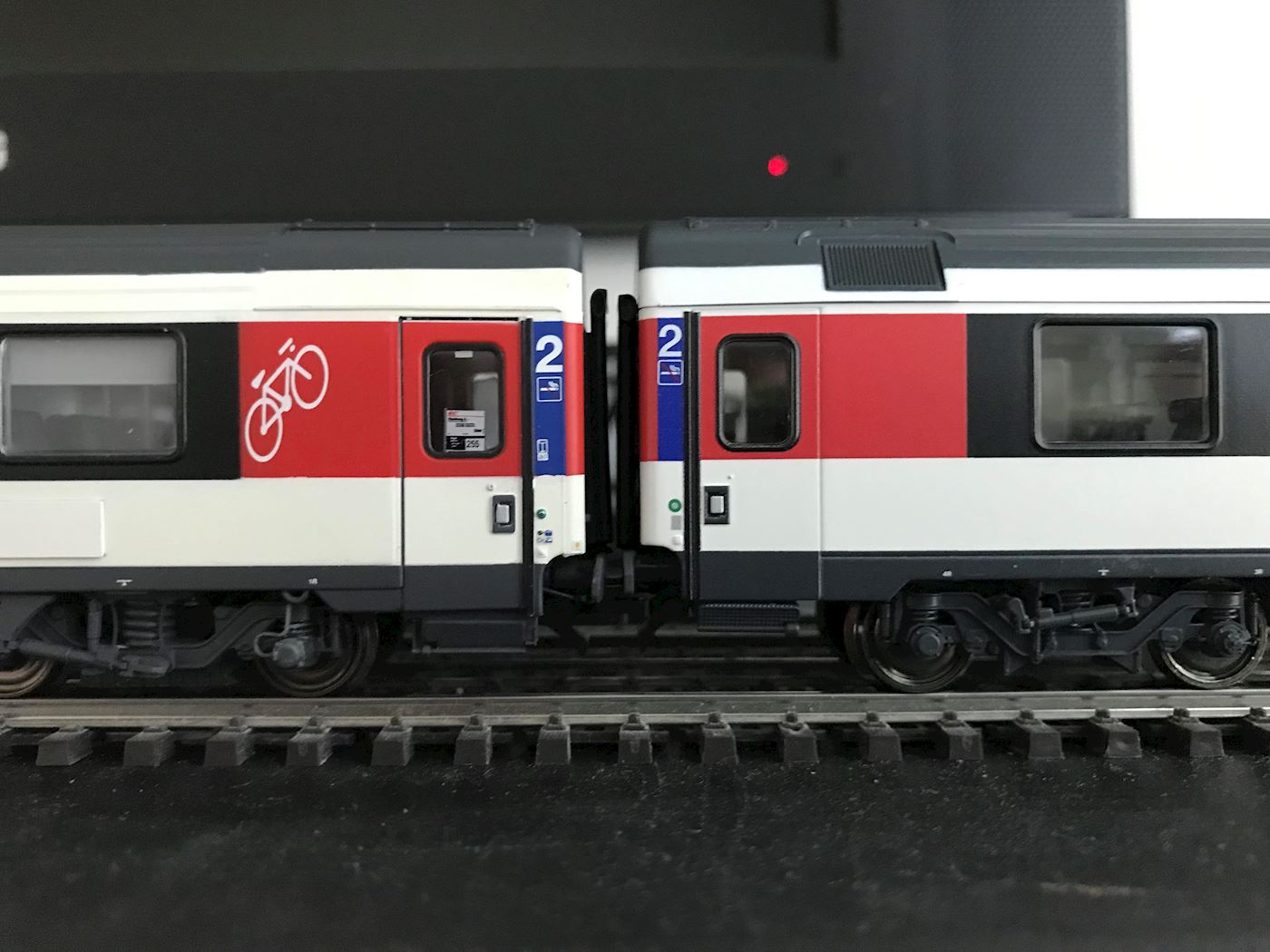

Roco (L) and LSM (R) Bpm in so-called ICN livery. You can see the additional vent on the LSM model, added for operation with diesel locomotives on the route to Munich
LSM (L) and Roco (R) Bpm in the ICN livery. You can see the bike logo on the LSM model as well as details of the bogies. Note the height difference (again)
