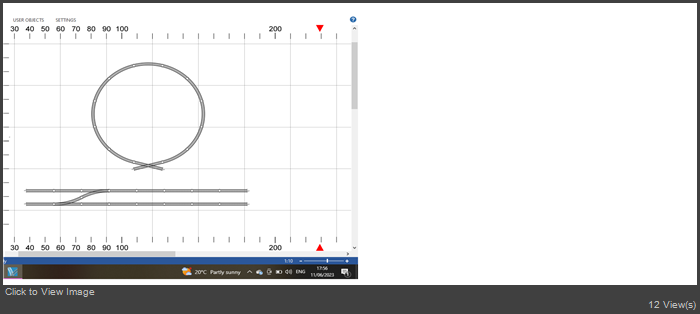

running double main line and looking to send trains to hidden station its a passing loop and storage loop main line is visible the loop hidden working with marklin M track would be nice if i could run trains from both directions and right hand traffic digital

its throwing traffic from the right back out to the left but left is getting sent onto incoming traffic side

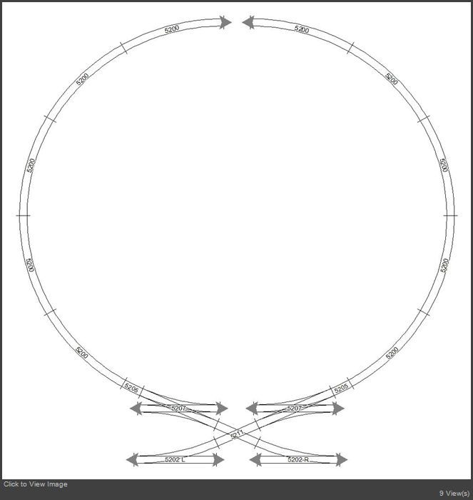

How about this? It's from SCARM; I didn't figure out how to close the gaps with M tracks, but the measuring tape can get you the solutions.
I hope it helps!
Brian

5129 on any rail i think it 360 grate plan ccranum need to check depth of main line might have to wide
