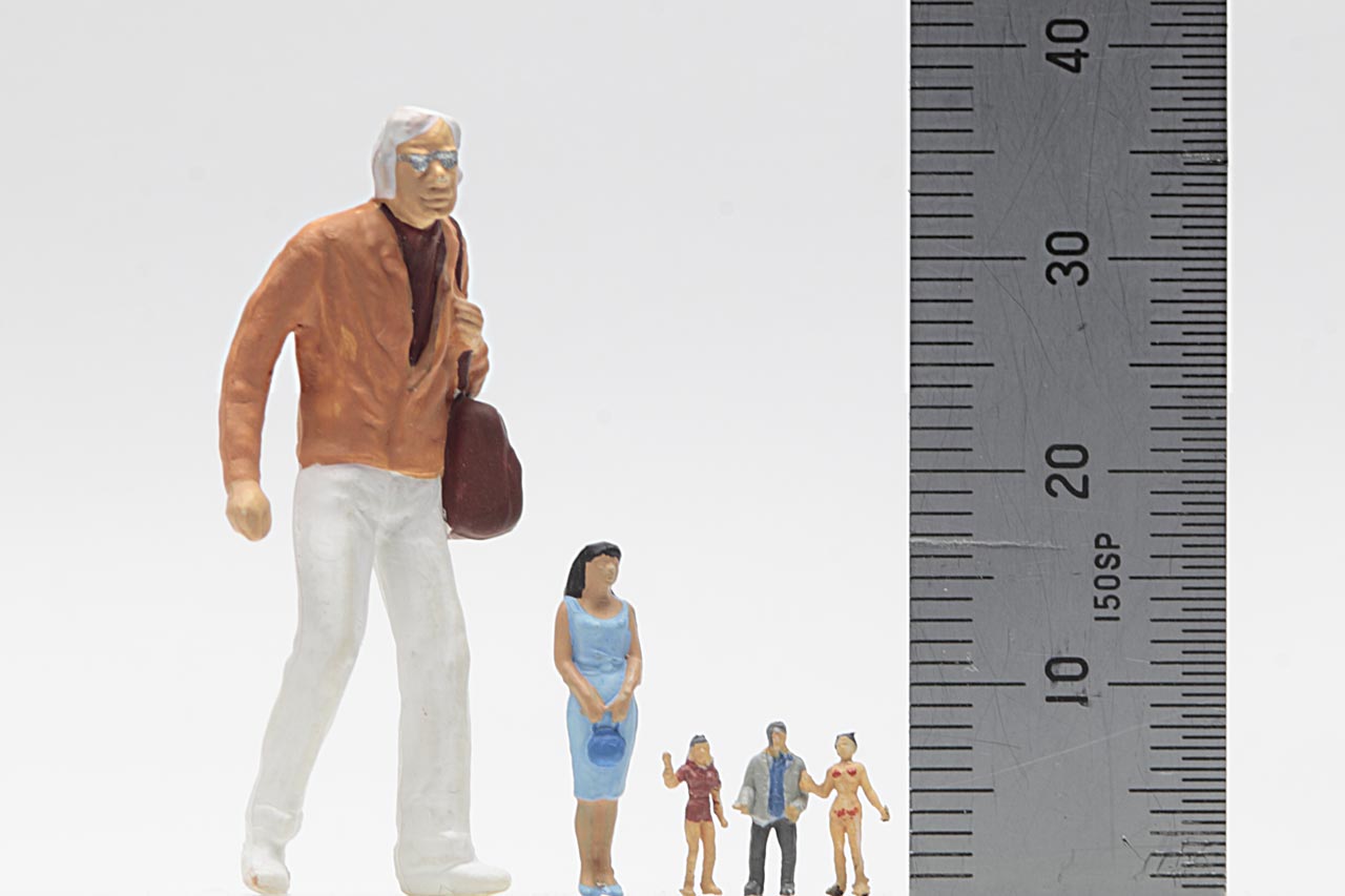

"The scale of the problem"
A comparison between 1:50, 1:100 & 1:220 (I don't have any HO scale figures). I have some 1:500 "nude" Preiser figures, but that is "taking a rope" territory!
Unless one has worked with Z gauge you don't realise the small scale issues. The Sable tail bristles on the Winsor Newton Series Seven 000 brush are 6mm long.
My painting is a bit rough in relation to the pre-painted figures, but from normal viewing distance & with my glasses, whether a bikini is worn or not is only an issue depending on desired outcome!
