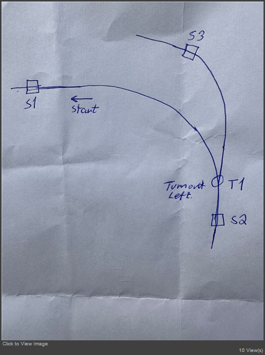

Hi,I'm trying to make a shuttle train event.see picture.The event start with switch/Circuit Track ,S1.The train change direction and drive towards turnout T1,T1 change to left position.When train passes S2,it stops.turnout T1 ,turn straightforward and train starts moving to S3.S3 change the train direction and drive towards turnout T1.When train passes S2,it stops.And here is where the problem is.Now the train should have driven towards S1 and set the turnout T1,to left. In my event 2 ,S2 says that the turnout should turn straightforward.I cant have two different directions on the turnout,in the same event.I only have 3 events on this shuttle event.I'm not shure if ppl understand what I meant.The plan was to make a train climing up a hill by zig zag,due to no place to make a tunnel.Is there any logical functions that can be used in the event program ,like if ...

I got other shuttle events,just running from A to B and back again,works fine.On this route ,I have 3 feedback contacts' and 1 turnout.I can't figure out how to make a working event that do the job.Runinng from S1 to S2 ,from S2 to S3 and back again.

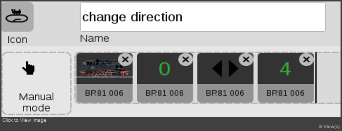

Maybe not necessary to use switch/Circuit Track, just use common Contact Track at S1, S2 & S3, then could achieve your purpose. Location of S1, S2 & S3 may just near T1.
Assume train move direction is forward to S1 & S3, backward to S2, and one specific Loco (here is BR81) to shuttle between S1 - S2 - S3, then S3 - S2 - S1.
Create Event "change direction" to change Loco's move direction;
Create Macro "If 1" to change direction of turnout T1;
Create Event "S1" when train pass S1, condition is Loco moves forward;
Create Event "S2" when train pass S2, condition is Loco moves backward;
Create Event "S3" when train pass S3, condition is Loco moves forward.
