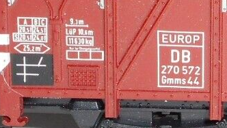

I want to start by asking when the livery in the image attached would have been current.
Seems the "Europ" designation was phased out by the end of era III, but was that just the square logo with the transport company underneath. (DB, FS, NS, SNCF, DR) .... or also text like this.
(I was surprised to see that DR and many other countries also used this)
DR participated in RIV, but not in EUROP:
RIV
Abbreviation for Italian "Regulamento Internazionale Veicoli", agreement on the reciprocal use of freight cars in international traffic of 01/01/1922; also applies to loading equipment, containers and pallets; currently 32 railroads in Europe and the Middle East are members of the RIV.
EUROP - repealed -
"Communauté européenne des wagons", European freight car community. Agreement concluded on the basis of the RIV on the joint, permissive use of covered and open freight cars; only standardized UIC cars (European standard cars, address "Europ") were included in the joint pool; the agreement concluded in 1951 between DB and SNCF was joined in 1953 by SNCB, DSB, FS, CFL, NS, OBB and SBB; bodies: EUROP Committee, EUROP Wagon Office (headquarters: Berne). The corresponding "Agreement on the Community Use of Freight Wagons freight wagons" was concluded on 02/03/1953. The wagons run freely on the member railroads, making their use considerably more economical.
Source: https://www-docs.b-tu.de...ublic/0-2BegriffeAbk.pdf
The EUROP wagon pool was dissolved at the end of 2002.
Source: https://de.wikipedia.org/wiki/RIV-EUROP

Thank you for the correction AK. I thought I saw a DR-Europ livery when looking up a number of images and was bewildered (thought perhaps for a short time during transition) but I must have conflated it with the two images in the tapatalk Railways of Germany post (link below). One was the DR in the US-Brit-Zone which surprised me, again must have been during or prior to the change over.
As for the image of the livery I posted above (RIV-Europ/87 SNCF) is it possible to have pre-existed 1965?
What time frame would a strictly text based Europ designation/livery have fallen under then?
After posting I searched further and found the text-only livery with Europ seems to have continued to be used much later than 1965, but how about before then?
The gentlemen in this informative and interesting post indicate the the Europ livery (assuming its the box-type Europ livery only as in my image below) would not have existed past 1965 due to the introduction of the UIC standard. But that doesn't quite fit if the Europ pool continued decades further as you indicate. So guessing it only the box-type livery.
https://www.tapatalk.com...topic.php?p=59063#p59063

Relying on the FREMO article:
- post #1 stencil was applied after 01/07/1964 and before 01/01/1969.
- post #4 stencil was valid from 01/06/1951 until 06/02/1960.
https://www.fremo-net.eu/index.php?id=402

I never tire of quoting the FREMO article:
"On June 1, 1964 - i.e., in the middle of Era 3 b (!) - the designation scheme for freight cars that is still in use today finally came into effect. In addition to the internationally valid class and code letters, it also provided for coding of the car type in the car number. The dot placed in front of the generic designation stated that these wagons were already labeled according to the now valid scheme. To the right of the new class number, the old, nationally valid class designation was still used for a transitional period.
The scheduled re-designation had to be completed on the UIC member railroads by December 31, 1968 - at least for all wagons that could be used internationally. It can be assumed that throughout the 1960s, no wagons came out of a revision without being re-designated, apart from wagons for purely domestic traffic or wagons that were due for retirement anyway.
The idea held by many model railroaders that the majority of the freight car fleet in the mid-1960s was still labeled as it was in the 1950s, and that the UIC designations only suddenly appeared shortly before 1970, can be safely thrown overboard. In fact, practically all of the cars in the active freight car fleet had been redesignated by 1969."
