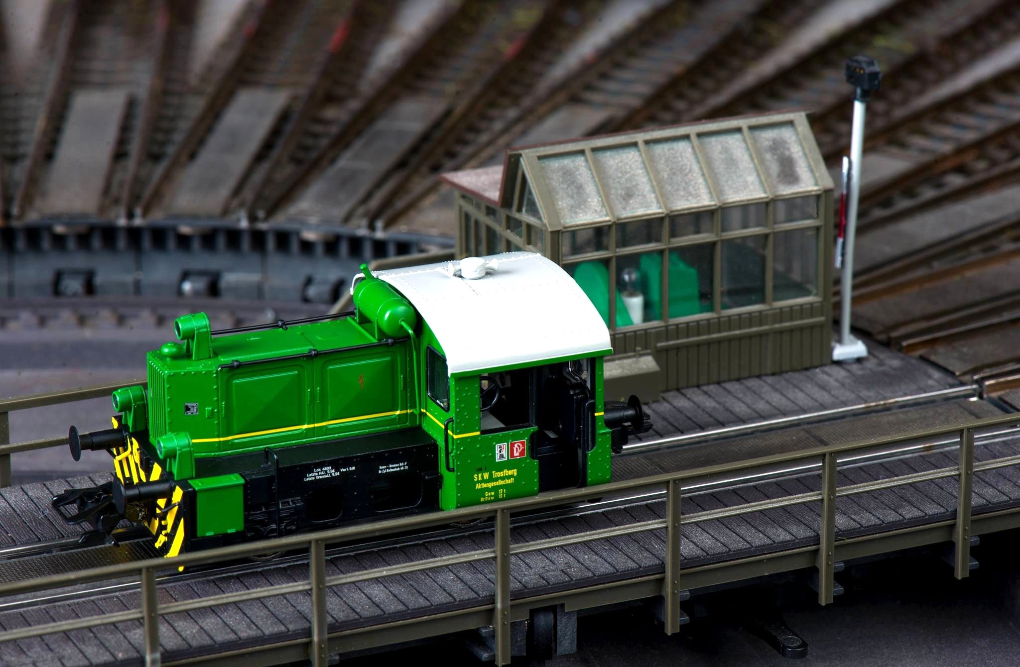

I have a KÖF that has zincpest. I'm sure many of you have had the same misfortune. I wonder what I can do with this otherwise perfectly working loco? Build a new cab maybe?
C.

I'm afraid sooner or later the frame will break, leading to gear problems. So a new cab may only be a short-term remedy.
Is it the green Trostberg Köf?

The frame is pretty solid though. The loco is pretty old I believe, zincpest on the cab became apparent maybe 10 years ago but the frame is still ok.
C.

I thought they tended to have problems with the chassis, not the body. maybe a photo of the problem would help?
A possibility would be to get a spare body for a recent one and paint it.

Probably my good luck ... Chasis is fine, it's only the body. Good advice though; I was thinking of using/fitting it on a plastic track laying machine kit ... I have one from Kibri laying around for some time.

Originally Posted by: thing fish Go to Quoted Post
Hi ya all,
C.
As you know, Zinkpest is intercristalline corrosion, a big word to say that during the casting process, some impurities (e.g. lead) were added by accident and started an INTERNAL corrosion. The cristals resulting from corrosion result in volume increase and reduced mechanical resistance.
This means that no paint, no cleaning will help BUT keeping the temperature almost constant helps reduce the progression.
Attention: there are some cast irregularities that are not Zink Pest. E.g. I have a 1951 DL800 and the casing has one pimple that is cased - during the cast process - of the inclusion of air which caused the casing to have a 1 mm pimple. This does not evolve and does not imply a mechanical weakness.
Because of the Köf tiny mechanism (with reduced space and high precision requirements, the result is rapid degradation of fonctionality so a static presentation on a side track is advised.
cheers
