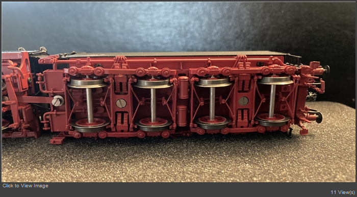

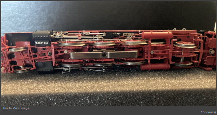

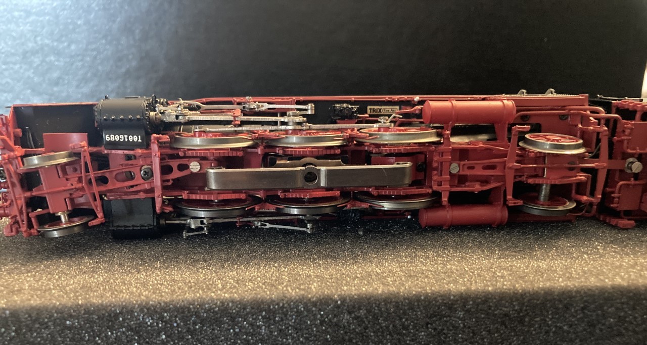

Does anyone here know how to access the bottom cover under locomotive or tender for grease? Leaflet does not have clear instructions... I also need to replace the rear lamp on the tender... I do not want to mess anything up! Thank you.

That's not a br 23. It looks like a br 01, 03, or 001. On every Trix based Marklin I have, you remove the boiler or body shell, and there are either an exposed worm gear on the motor or under the crdan shaft covers. Those have holes in the top of the decoder or pcb board to lubricate. On some, you unscrew the boards,a nd just lift up a bit to get to the gear.
Every later model Loco. has a manual on the Marklin site.

This is a brass locomotive made by Trix fine art series.
You can see the letter of BR23 printed on the cab.
The wheel configuration in this locomotive is 2-6-2 not the same as 4-6-2 in BR01or BR03.
The chassis apparently is more detailed than the products of Marklin and Trix in general.
