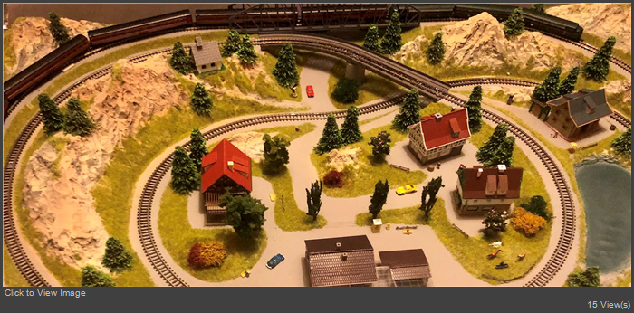

D7198E06-39D7-471A-B701-4E4568525FD5.jpeg44184874-F13F-4801-8596-E283FF518975.jpeg53C41323-FEEE-42ED-8DB9-40AB70287D6D.jpegSince there is nothing new to buy that appeals to me in Z I have been looking at ebay.
Normally I only go for ‘buy it now’ but before I put the filter on I saw a 88321 at an opening bid which looked interesting with less than 1 hour to go.
This is a USA outline EMD F7 A-B-A with caboose in Pennsylvania livery. Apart from some cabooses I bought cheap for the metal wheels I have not previously bought American. I managed to get the set at the opening price and bid for the 87847 matching 6 coaches, again, getting them for the opening bid price.
They arrived yesterday and I tested them today on the Noch suitcase layout, the locos work, not very well, so a strip down, clean and oil will be necessary, all part of the enjoyment for me!
