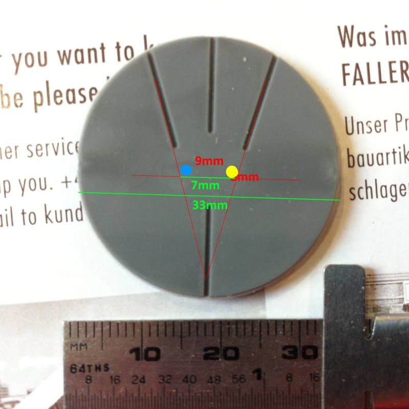

To organize a road layout with Faller bricks can become expensive (stops, deviations, etc)
Below is a simple example of a combination of one stop (traffic light) and one deviation.
The starting point is because it was on a bridge there was no space to install the very large stop coil and the very long and fragile deviation coil.
So I used a disposable cleaner's hanger to shape a stop and a deviation.
Here is the underneath of a road bridge made of Laserstreet elements that you can see during operation testing
The brain is a very inexpensive servo purchased from China (3 to 5€ apiece) and a servo controller from ESU
You may see that one servo moves a magnet close to the "street" to stop cars and away 5 to 6 mm to let them go
The deviation is a bent iron wire underneath the street to guide the car out.
Since this first approch I found much easier to drill a hole in the laserstreet and cover the hole with a thin plastic.
Underneath a bent iron wire (my disposable hanger) rotates to go in the hole as ordered by a servo motor. A little magnet (watch for proper polarisation) attracks the slider of the car in the deviation mode. The the wire plunger is not up in the street then the car / truck goes stratit ahead. Seems complex but it is not (can be made in less than one hour)

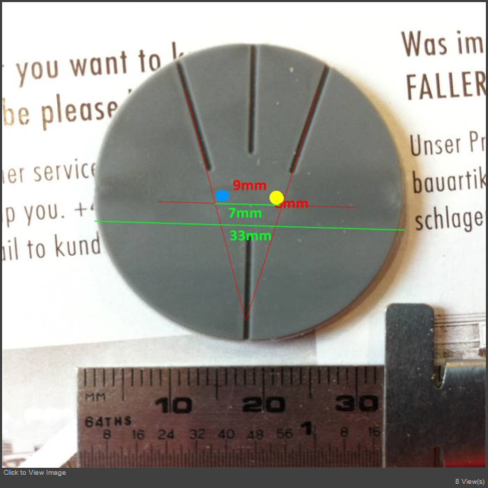

Where to drill the deviation hole?
Here is a picture with dimensions of a standard deviation cover and the Blue and Yellow points indicate where to locate these holes to deviate either to the right or to the left.
The other very important bricks are the Faller sensors 161773 and the magnets 163221 for stops or for differentiation of vehicules (Buses, Trucks, others).
I also found that the key tool is the groove cutter 161669.
You can see the bridge (on the left) in operation on this video
Note: the bridge on the right has also 2 servos (1 for stopping and one for the left turn)
Regarding Faller automation block, I find them expensive and good in stand-alone mode (cannot be combined) and non modifyable (try to manage a 3 road intersection with the traffic-Light control 161651. It goes much easier and flexible using like for trains, the sensor feed-back and the modules to drive switches, the brain being a CS3 or Rocrail
Just my opinion
