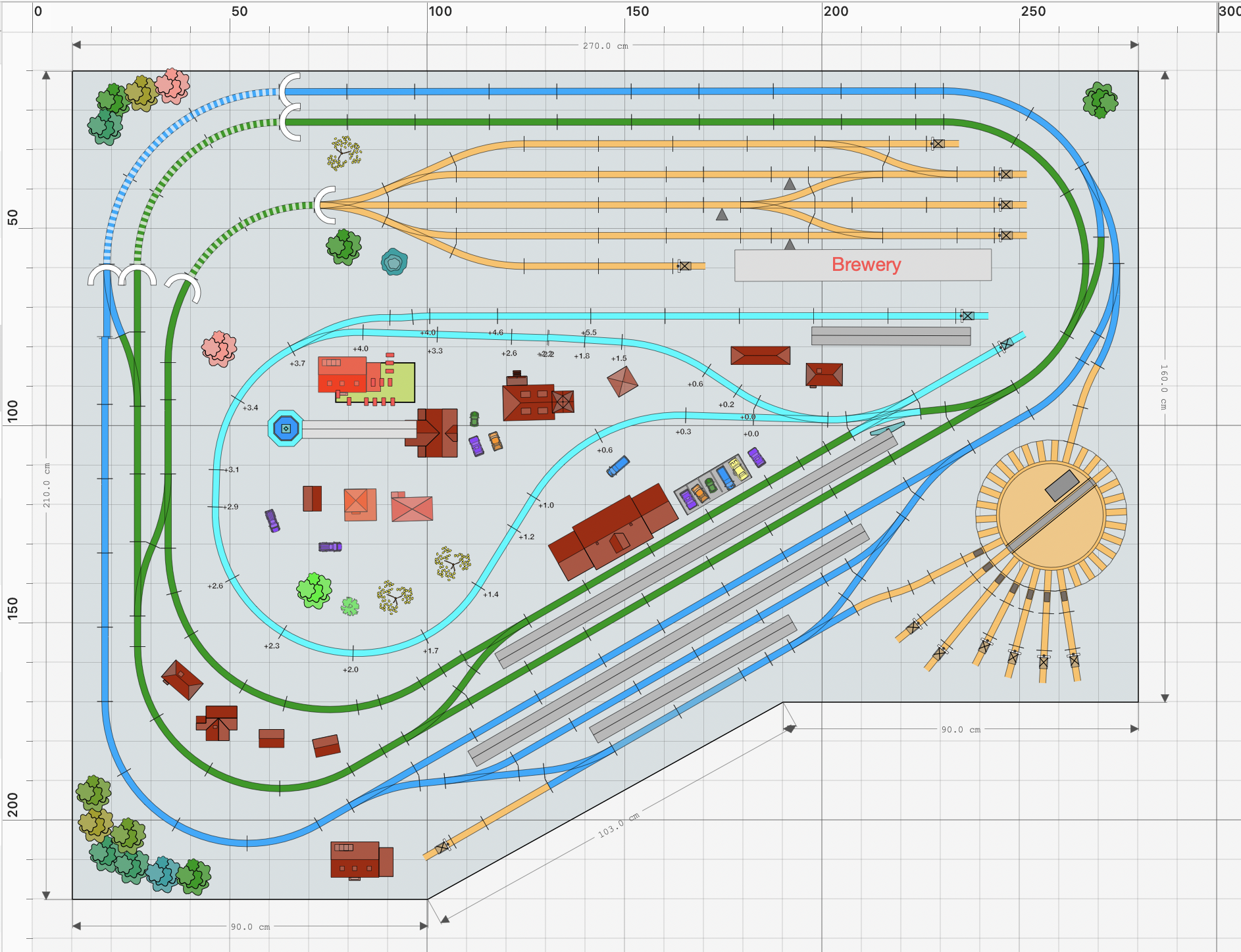

Just finished designing the second iteration of my new HO layout.
Welcome any thoughts, suggestions or ideas.
I have two loops (blue and Green), a station, fiddle yard (yellow), and the light blue line climbs up into the hills, past the helicopter landing pad and ski lift; then either looping back down to the main station, or onto the small ski station
Alex

Hi Alex

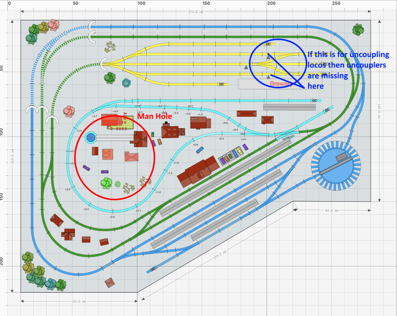

Here are my thoughts on your draft layout (I am not crticizing it in any way):
- the turntable has very little space for exit tracks and round house
- there is little space for houses and landscapen (one way to solve this is to use multi-levels, I use 3 levels)
- see comments on your layout drawing
The switches circled in Blue: are they really needed? or is this for uncoupling locos to send to the depot?
Question : Is this M Track?
Note: Either you have access to all sides of the layout or you should include a "man-hole" near where you cable car is.
In French we say "la critique est aisée mais l'art est difficile" Criticize is easy but creating is difficult.
A turntable and depot are so much fun that I think you should give it more space
Here are my turntable operations
https://www.youtube.com/watch?v=F6WnhXPcRqI
Plenty of things to criticize too but just to show how automatic operation and a steam depot can be fun

Hi Jean, and thanks for your comments - no offence taken in any way, its the sort of feedback I was hoping for.
Yes the switches on the right on the sidings are to allow the loco to escape.
I am intending to use C track
I am able to get access (just) all round the layout, so should be OK on this. I cannot go wider but possibly longer.
I loved your video and the turntable. I just like playing with them (like you I suspect!). I did try to incorporate the turntable into the sidings on the right, but it wouldn't work. I am hoping that I can negotiate with "ma femme" some addition space at the bottom of the layout, in which case I can extend the turntable activity to below its current position. I might not install the turntable in the first instance because, as you say, it's not doing a lot.

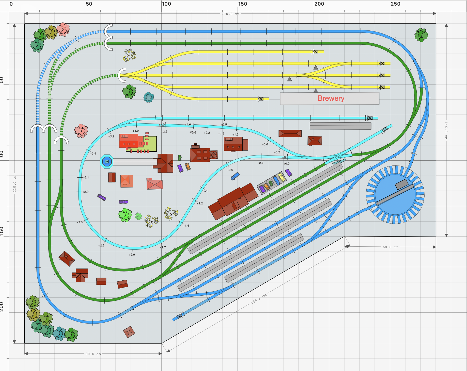

I have managed to sneak a little space and have managed to change the layout slightly to make the turntable more effective. However, any more space and I start to run into problems with a door !!

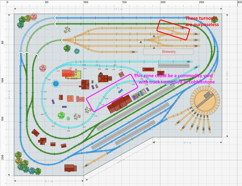

Here are more comments on your revised plan
The top right pair of turn-outs are almost useless (too little space for any loco to escape to the adjacent track.
Typically, behind a station you have a zone for cars and buses but here we have the track to the reversing loop.
You could solve this by embedding the track nearby the station into a cobble stone or tar zone.
Take care
