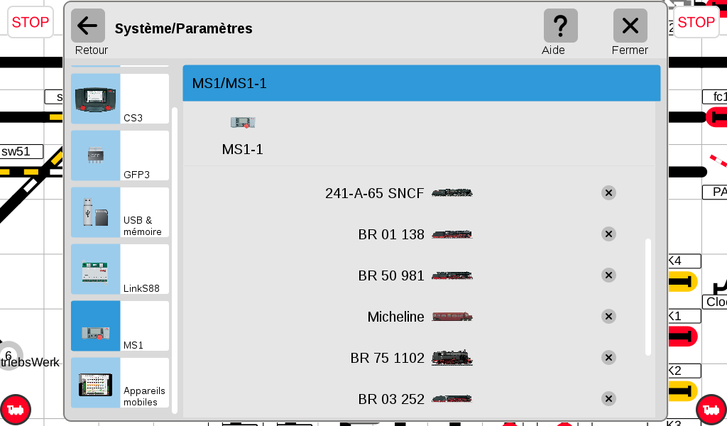

Yes the MS1 works very fine with a CS3 (my case) with the following:
- plugs directly in one of the 2 front sockets or to extensions using a Terminal (Märklin 60125) to be checked as I don't have a hub)
- stores only 10 of your locos. Those 10 locos are designated by the CS3 using the MS1 command
As you know, the MS1 is much simplified compared with MS2 (no control of points and signals, no CV editing, etc) but to use as a local command away from the CS3 it is good.
