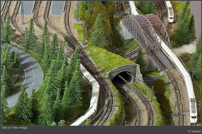

It is partly why I have three 6 carriage ICE sets. The ICE 1 in Z just looks a bit better on curves. The connector piece does a pretty good job making the train streamline.
The tightest radius is 275mm, but the ICE still looks good on tight curves (220mm into the platforms).

The Z gauge ICE 1 coach is 112mm centre to centre, so x 220 is 24.640 metres, so about 93% of the length of the real thing.

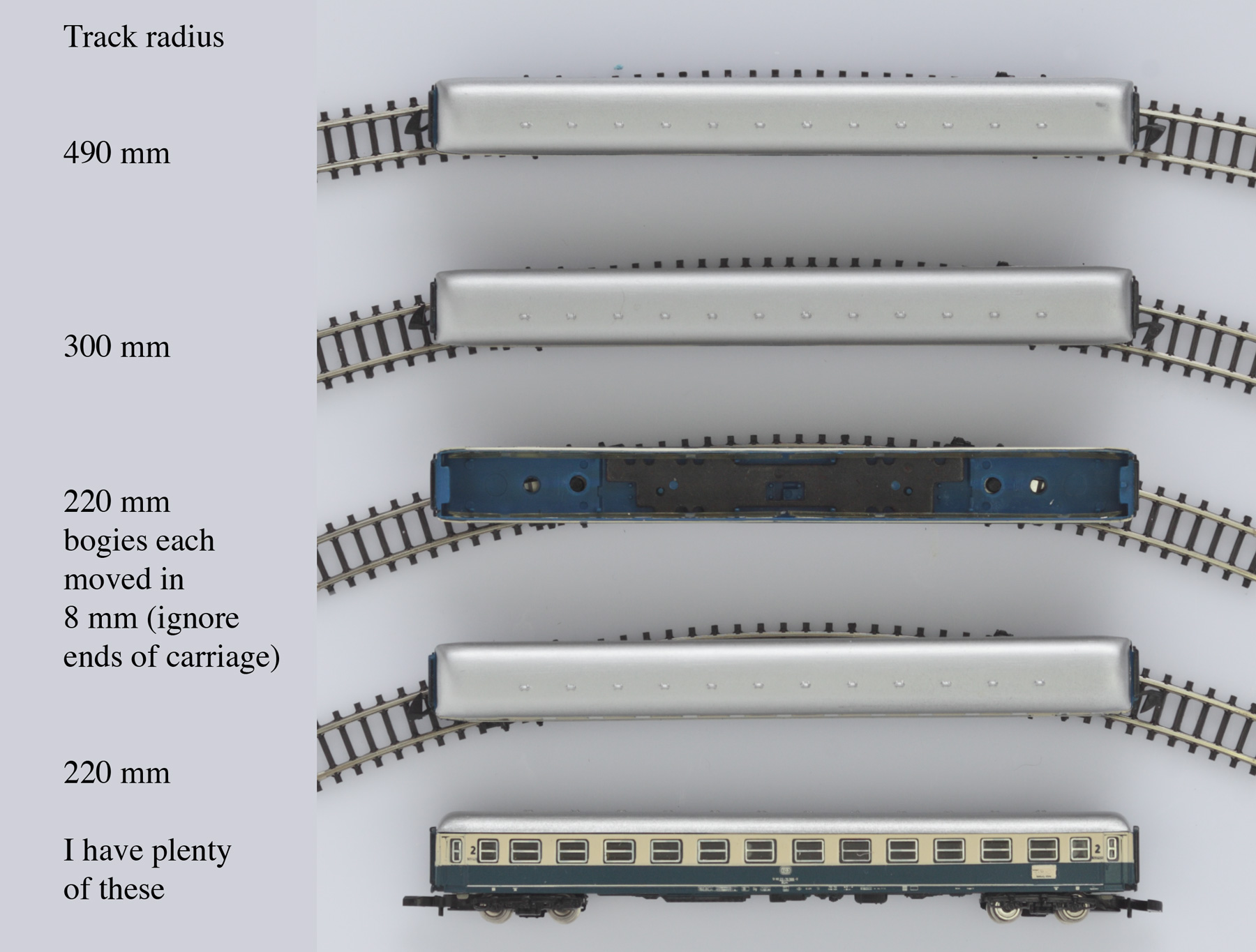

Just thought I would see how much track radius interacts with carriage length.
I have a truck load of these carriages so drilled 2 holes (no adverse affect) in one of the carriages, each 8mm towards the centre of the carriage, to represent the equivalent of 16 mm cut out of the centre of the carriage to make it shorter, which would fit the window spacing on this cartridge. Two windows removed. In this situation each end overhangs an additional 8 mm.
So in this situation just looking at carriage centre offset.
On my layout I did increase radius, but it was to keep gradients to 2%. The uphill track always on the outside.
Personally I wouldn't get too stressed over tight radiuses. But if you are really fussy maybe stick to about 0.5 metre minimum. I think changing direction from left to right without a transition is more visually irritating.
