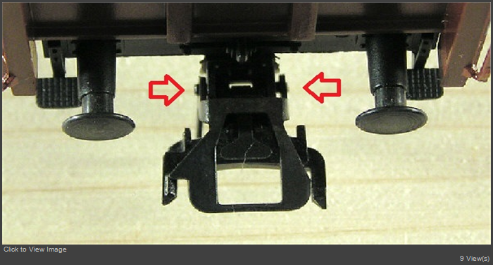

    Can someone show me an image of a coupler with the "removed metal loop" and how it lines up?
    The blog has an image from the side and I am not exactly sure how and where the part is detached from.
    Two small plastic pins hold the metal part. You can easily remove it with a finger nail or a small screw driver. Bend it a little bit to get it off the pins.
