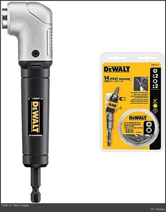

Offline BenP
#4 Posted : 29 September 2022 19:17:52(UTC)
BenP
Joined: 04/02/2021(UTC)
Posts: 543
Location: USA
I've just done some changes in my layout Trossingen III. See https://www.marklin-user...I---Evolution#post651285
12cm minimum between levels (K-track) allows you to work, especially using small screwdriver.
If you have to drill (small diameter holes), then a fine pin vise is also required.
But it is not easy...
Otherwise, 20-25 cm allows to pass an arm...
Fabrice
Get corner piece for screws and holes (any brand) ...
thanks 3 users liked this useful post by BenP
