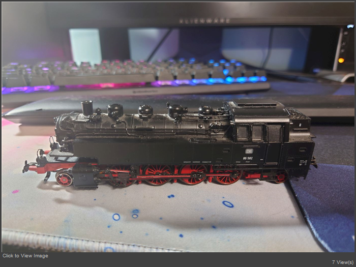

Hello, I have been running a set I inherited ( I believe it is a BR 86 loco, from the 29535 starter set.) It's been running great for a year or two on a pretty simple oval track, but now struggles to make it around the track.
I am using the 32VA transformer (not the Delta unit).. the couplers click, train lights up, and will move in either direction, but only when I have the dial between 100 and 150.... Otherwise nothing.
I tried cleaning and lubricating according to the manual, and also installed new motor brushes, but only a minor improvement. Any suggestions? Thanks!
