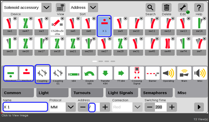

I am trying to add decouplers to the track plan on my CS3. I cannot find an icon for the decoupler. I can only find icons for the Telex couplers. Since these are on the locomotive, I do not believe this will work. Am I missing something? Or, does the CS3 not support decoupling tracks?

Take another look. In the accesory page. They are there
With a CS3, there are 2 types of decoupling items
- the HO one Only one solenoid
- the Gauge 1 with 2 solenoids like a point
The insertion method is:
- to select the wrench
- to select modify article list
- to push the + key, this will add a position that can be either a switch, a signal, etc and also TWO HO decouplers
- once you edit this new article, (specifying its address, etc, pushing the key "Misc" on the bottom right of the screen, you may select various possibilities among which the decoupler
The decoupling key on the left in HO, the one on the right is 1 Gauge
For HO, you must select the "side" (Red or Green) because you may have 2 couplers per output pair.
I hope this helps
