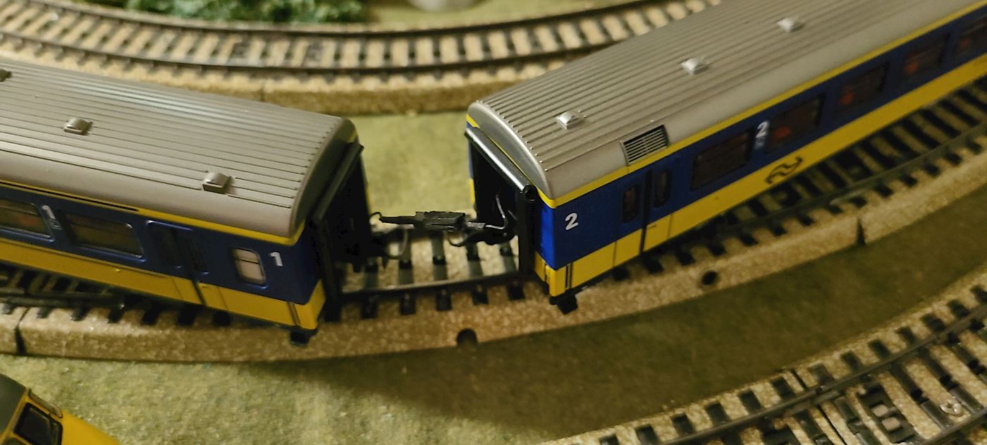

I would look at replacing the Maerklin current conducting close couplers with a solution by Roco, Piko, Krois, Viessman or other. Two pole wired couplings would allow you to avoid having the axle contacts on each coach and would reduce the drag when the consist was being pulled. You could even run wired couplings all the way to the locomotive and avoid requiring a second slider for the coach should you so desire.

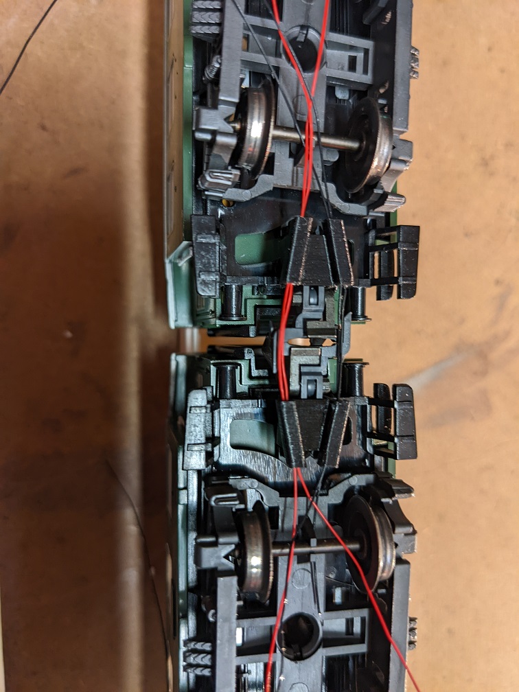

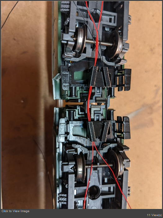

I came up with a hollow NEM drawbar to pass many wires from one coach to the next in my post on 5/7/22. It has the downside of permanent coupling but running passenger coaches in connected pairs or triples is doable - it also only costs a couple of cents.
I have also used a wire guide that simply slips over the NEM socket and is held in place when you push in the coupler (I use Roco universals). With black wire the connection is near invisible.
This works for up to 6 wires but, once again, it is a permanent connection.

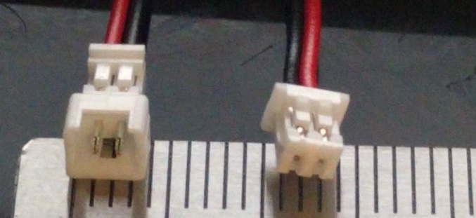

I plan next to try to make a holder/retainer for the "mini micro" JST-SH connectors found in some of my quadcopters. The 2 pin version is only 4mm wide and there may an answer there somewhere.

I have tried the Piko ones as they were OEM with the Goldenpass coach set. I had additional ones installed in some NPZ coaches where there was movement issues due to insufficient play in the wires. I have a model or two with the Roco four pole couplers. I did not adapt further models with those couplings.
I know of some modellers who have used circuits, LEDs and other parts from Almrose. I have read some good reviews of their couplers, but if I recall correctly, there were some concerns about magnet couplers detaching, which could present a risk in operation.

What I would love to see (as a possible alternative) is even a micro 2 pole wire connector and leave the factory couplers in place. The micro JSTs I've seen are simply too big (and often ugly/visible white plastic)

Based on your last post, I would think that the Viessmann solution is probably the best option. They are basically the Fleischmann Profi Coupling with one or two pole wiring.
