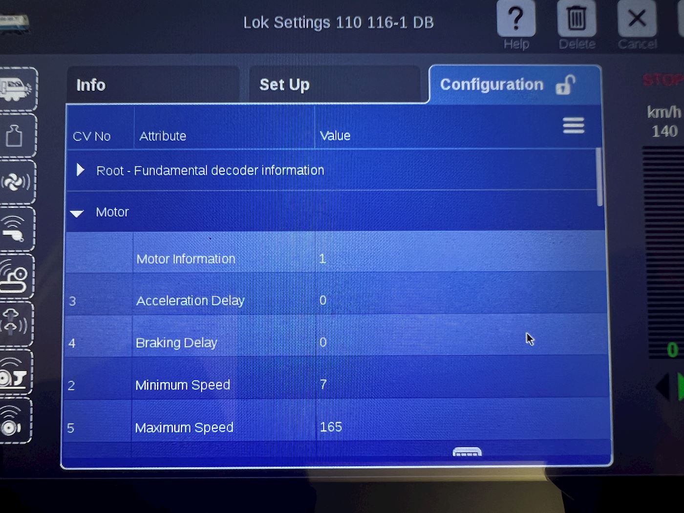

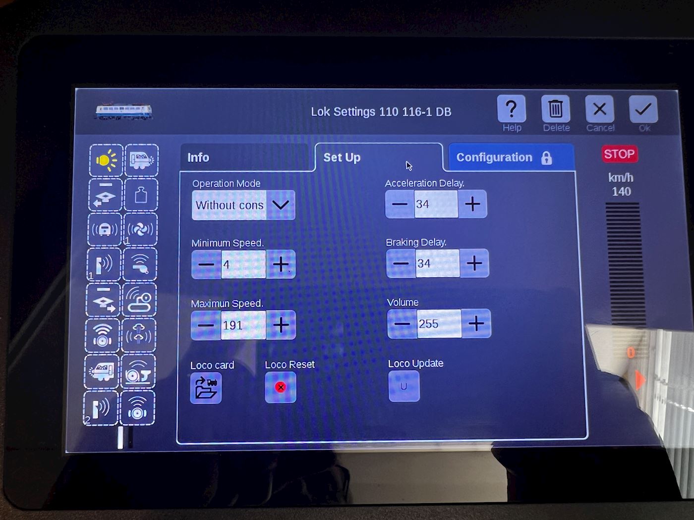

Greetings,
I've set CV values for acceleration and deceleration for my locomotives to 0, as my layout is controlled using software. However, I notice on the setup page that there are values specified for acceleration and deceleration (even though the CV values themselves are zero in the CV configuration page).
Is this normal / a bug in the CS3 display?
Paul
#2 Posted : 15 June 2022 11:03:51(UTC)
Posts: 15,542
The CS2 has acceleration and braking delays as a feature, handled by the CS2, not the decoder. This delay works even for Delta decoders that do not have this feature themselves.
I assume the CS3 has the same feature.
I don't know if those delays apply when a loco is controlled by software.

Here is the CS2 screen where you set the acceleration and braking delay handled by the CS2, not the decoder:

CS2 and CS3 are tools to transfer parameters to decoders INCLUDING the accel. Brake delays.
This does not mean the CS2 / CS3 is DOING the accel./ Brake delay (by sending a succession of digital orders). They DO NOT.
Sorry, Jean.
A quote from the German manual: "Nur die Werte, die beim Ändern gelb werden, werden beim Senden an die
Lok auf den Decoder geschrieben. Wird nach dem Ändern nur mit dem
grünen Haken bestätigt, werden die Änderungen nicht an die Lok gesendet und somit nicht wirksam.
Alle Werte, die weiss bleiben z.B. die Bremsverzögerung, werden nur vom
Steuergerät simuliert.
Sollen diese Werte geändert werden, muss dies
über den CV-Zugriff geschehen."
I didn't find an English version of the manual.
Google translation:
"Only the values that turn yellow when changed are written to the decoder when they are sent to the locomotive. If you only confirm with the green tick after the change, the changes are not sent to the locomotive and are therefore not effective.
All values that remain white, e.g. braking deceleration, are only simulated by the control unit. If these values are to be changed, this must be done via CV access."
Note the word "simuliert". The CS2 can simulate acceleration and braking delay. This is done for all decoders, Delta, MM, DCC, mfx. It is done by sending a succession of digital orders.
You can see this simulation if the needle of the speedometer moves slowly.
When you turn this simulation off in the CS2, the needle will jump to the new speed immediately. The delays handled by the decoder will then still be effective.
This means the CS2 is sometimes doing the acceleration and braking delay. That's it.
Feel free to disagree, but facts are facts.

Posts: 198
So just to confirm,
The CV values 3 & 4 on the configuration page (which have been uploaded to the lok) have been set at zero, as my software handles these.
The differing "Acceleration Delay" and "Braking Delay" visible on the set up page do nothing.
Paul

Offline bph
#14 Posted : 16 June 2022 18:15:08(UTC)
Posts: 1,252
When the Acceleration and Breaking delay settings are changed in the "Configuration tab" the values in "Set up tab" should update themselves automatically. At least it does on my CS3 and a recent mfx locomotive.
what software version are you running on the CS3? and what decoder firmware is in your locomotive?
one thing you can try is to change the values in the "Configuration tab", and then do a new decoder readout to see if the "set up tab" responds to that. you can also try to delete the locomotive and register it again.
