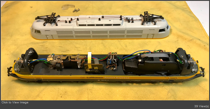

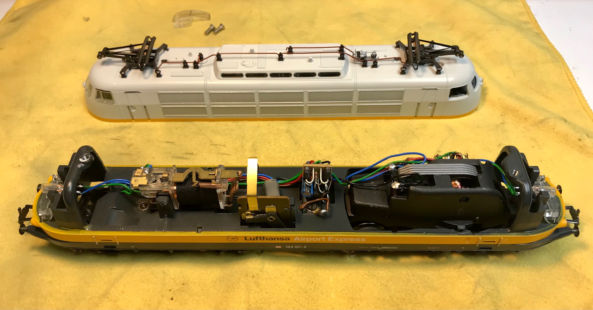

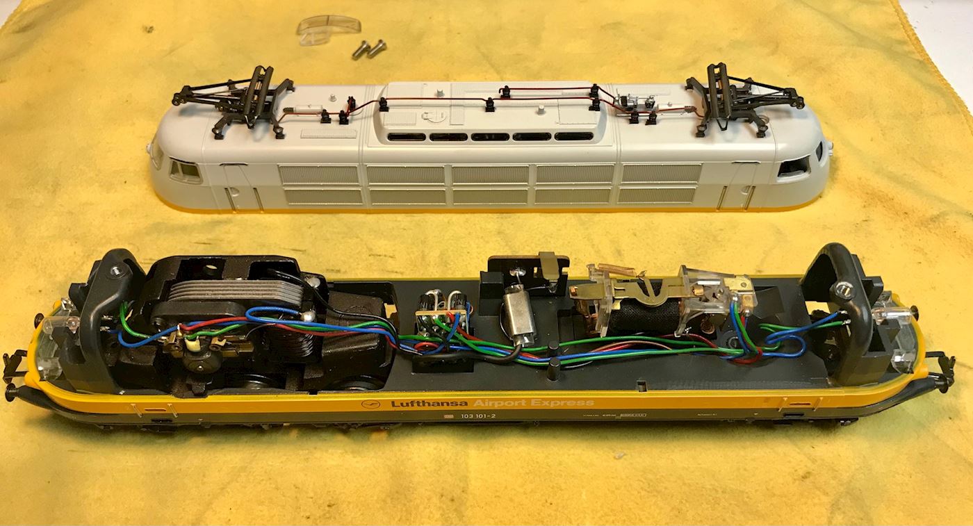

This is what I am looking at:IMG_5897.jpgIMG_5896.jpg

#6 Posted : 12 June 2022 18:51:21(UTC)
Posts: 3,687
Originally Posted by: europromo Go to Quoted Post
This loco also has a little electronic board that I have not seen before, assume that this is for the electronic speed control with load compensation or anti-wheel slip control..
I may be wrong of course but this loco is equipped with an electronic inverter unit consisting of one relay (seems to work fine) and one electronic unit intended at suppressing the typical jerk when activating the over-voltage. The unit was also there to stop the flash on headlamps.
This has nothing to do with 5 stars motors
If this unit is faulty then, no motor and no headlights.
At this stage you may look for an electronic inverter unit or bypass it by wiring directly the inductor coil to the relay and also the headlights
In this case, like on older locos, you will have the "boxsprung" (jump when sending a 24 V impulse) and the flash on headlights.
Märklin did 2 versions of this
- earlier version like yours made of one classic relay and a small electronic module like this one https://www.ebay.de/itm/36386523...eeade:g:Mv8AAOSwvoVibsfl
- a later version all "solid-state"
I am not sure but the bulbs may be different using a lower voltage because of the "Vorschaltelectronik". No big deal but just don't let too bright lamps that may harm the "light conductor"
***Corrections***
So to bypass the "electronic selector" (Vorschaltelektronik), you need to disconnect the red wire between the selector and the motor and connect the motor directly to the overhead/slider SPDT
For the headlamps (green and blue wires) I am not sure how they were connected. It seems they were both illuminated no matter the direction and powered by the selector. You may change this byt wiring BOTH lamps to the overhead selector on one side and the other pole of each lamp to the inverter relay contacts (each lamp to a contact) in parallel with the induction coils
