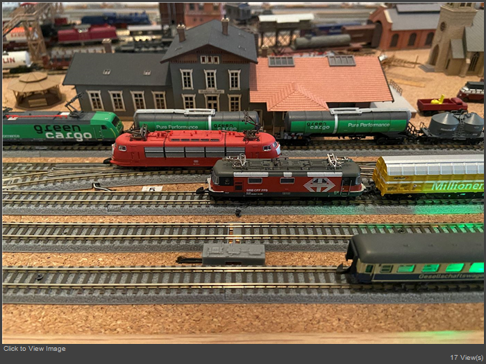

Here we have the Swiss, Germans, and Swedes all passing a Zmodell equipped entertainment car at a station in Europe somewhere, in my world! I am very happy with my new SBB Re420. I needed a Swiss loco to pull my Marklin 82417 WASCOSA set. It is beautiful, with a charming livery and plenty of detail. It runs as well as anyone could hope for. It is a fairly slow mover in comparison to others, but not slow. I cannot guess at its pulling power. I note one discrepancy, Marklins description says white/red lighting in the Swiss code but there are no red lights, just three white forward and one white rearward changing over, which is correct for most situations. From the instruction sheet it looks like it would be easy to maintain. It is built in Hungary and has a one piece chassis with the trucks held in with pins in the usual (older) Marklin style. It has a distinctive look on the track too.

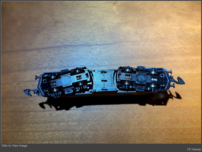

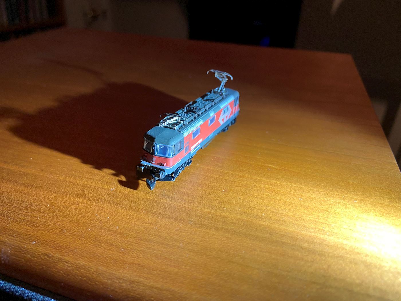

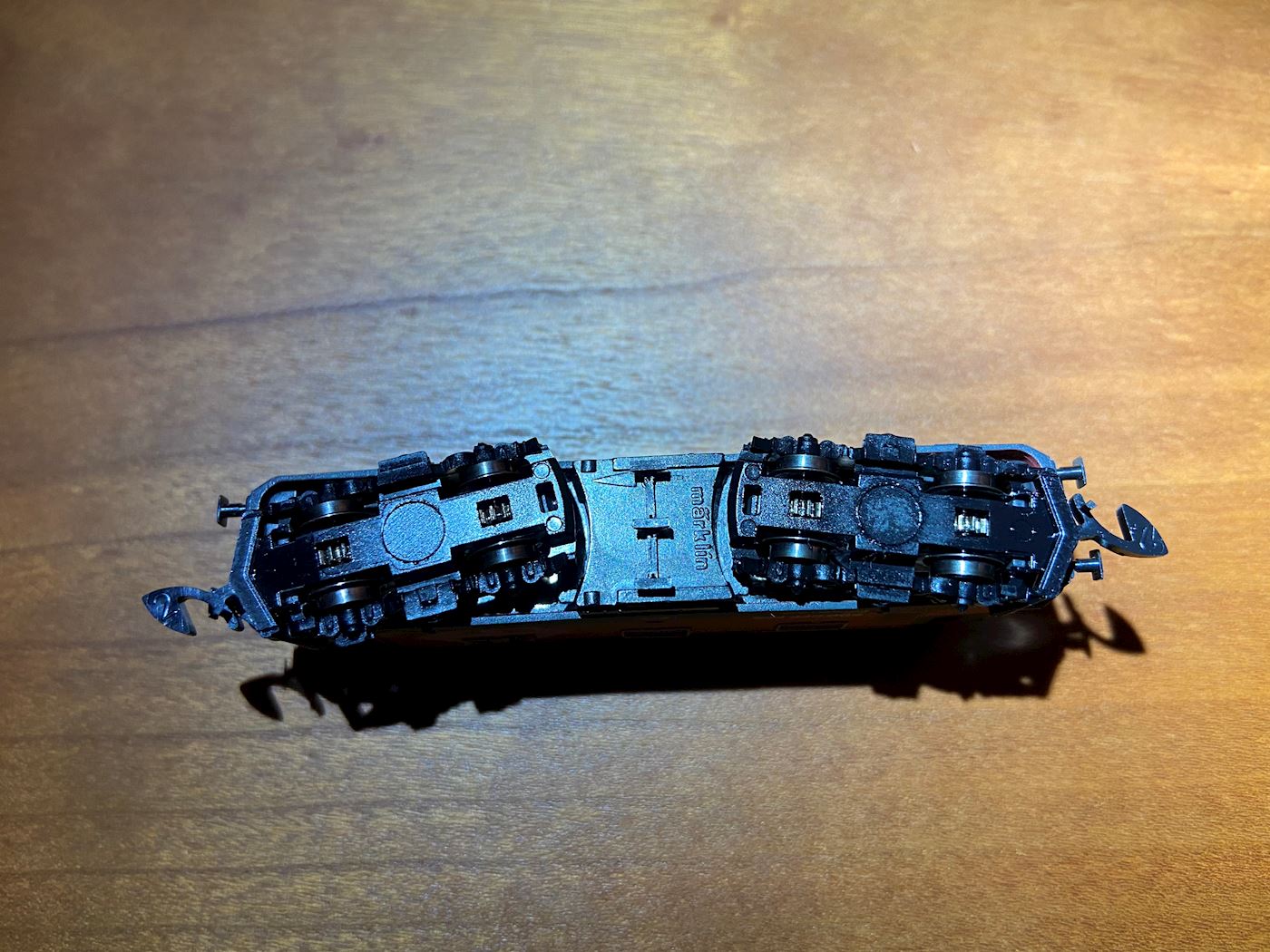

So on this loco the trucks have the pilots molded in and they swing “out” just as the truck swings. It’s hard to see this on the track so I took pictures off track to make it clearer.

If I am understanding, that “V” shaped piece at the front, is a part of the bogie. It moves along with the bogie as it moves on the track.
It almost looks like the snow plows you see on locomotives in northern regions. Seems SBB locomotives would need this type of feature also. Now it is modeled! Sweet. Let us know the results of your wagon pulling test if you get a chance. Could be a good reason to add to my SBB collection.

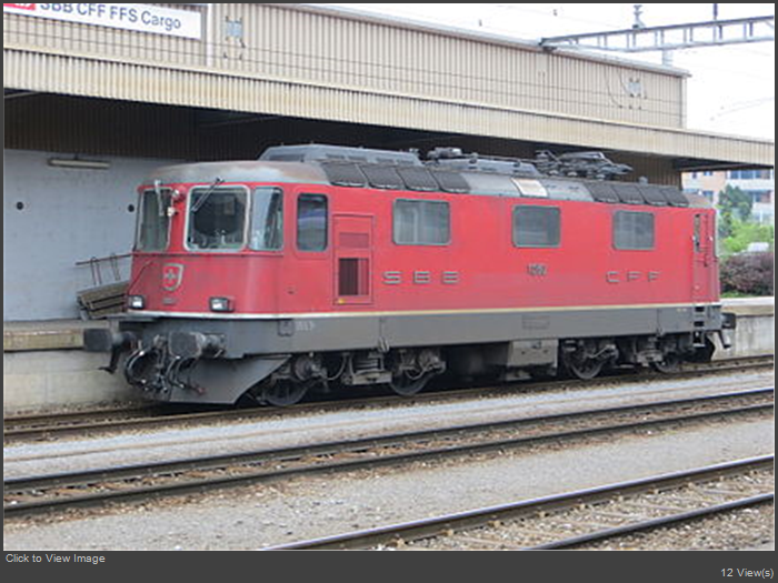

Here are some Wiki pics showing the pilot on the Re420. It does not look like they "swing out" on the real loco? Probably it is not necessary. Pure speculation but our models benefit from having truck mounted couplers on the sharp curves we use. I'll bet many of us have had problems with stationary pilot mounted couplers on our trains and in fact AZL ships some of their loco's (like the E7 A unit) with a spare truck that has a coupler mounted, the user is instructed to remove the fixed pilot and its "non swinging" coupler and swap out the truck assemblies if it is to pull cars. The leading loco would not get this modification so to have the prototypical pilot and coupler look out front on, for instance, an ABA set. Perhaps Marklin is saying the pilot of the Re420 "swings out" to tell us that this feature is modeled but will not restrict operation of the coupler due to the mechanics of our small scale.

They do not swing out on the prototype. This is done on the model because of the unnaturally sharp curves on MRR track.
Roger
I just did the math. A sharp prototype curve of 630 meters scales to about 3 meters in Z scale.
