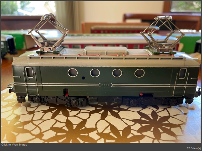

Hi Everyone. As an absolute novice, I'd appreciate some advice on recommisioning a 1953 Marklin 3012. I have just bought it and I understand the previous owner had it in storage for 70 years. It is certainly in beautiful condition!
My question is: given that it has not been used for so long, is it OK to right away put it onto a track and see if it goes? Or is there something I should check out first, maybe oil or clean something?
I have plenty of time, I am waiting for a new transformer to arrive in the mail. I have an old Marklin Super inherited from my father that looks totally lethal. Indeed, someone has cut off the power cord probably as a safety strategy and I think I'll leave it that way! It will make a good paper weight.
Thanks in advance, and apologies if this topic has been covered before - please point me towards it (I had a quick look).

Hi Adrian, welcome along.
It would not surprise me in the slightest if you simply put it on the track, and away it went. We hear that story often. It looks pristine, lucky you.
It will likely need a drop of oil, and possibly may need motor brushes, but only if it had already done a few miles. The wear underneath would indicate how much, (if any) running it has done.
In particular, the state of the pickup slider, and the wheels. Can you add photos of the underside?
Oil both ends of the motor armature, single small drop to start. Ditto for the wheel axles. Again, just a small drop on each.
One thing to watch, make sure the red selector switch (shown in the second photo above the left bogie) remains in the down position as shown. It's easy to bump it up when handling and that will switch the power source from the track, to the overhead.
If you intend to remove the body to oil the motor, be aware that model probably requires the two headlight bulbs to be removed first - remove the single screw between them and the holder and bulbs will fall out.
Then you can remove the screws underneath at each end and lift the body shell off.
But, honestly, I'd just try it.
As for the Super Transformer, the main (and virtually only) problem with those is the mains-cord rubber perishes. This is obviously highly dangerous, but if the cord is replaced with a modern PVC cord, it will give good reliable performance.
They've been discussed here before and for obvious reasons it's best the work is done by a certified professional such as an electrician (if you know one) or an appliance repair technician.
Repair can work out cheaper than a new modern one.
Hope this helps

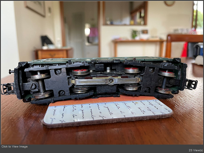

Here's a picture of underneath - definitely been used looking at the slider, but up top it's almost like new. It's my first purchase ever and I'm very chuffed. Would sewing machine oil be OK?
Cheers, Adrian

Hi Adrian, even better. Virtually no wear at all. The slider wear is only a little. The giveaway is the degree of chrome worn off the wheels, and/or noticeable backlash in the wheels/gears.
Yours is also one of the very first models to have traction tyres fitted. Those ones are the original plastic type, they are possibly very hard now and may be prone to slipping, but you would only notice this pulling a heavy consist, and particularly on an incline.
Modern tyres are black rubber. Unless they are causing an issue, I'd leave them be.

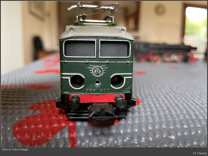

I think I'm making progress although I've already been wrong a couple of times already, so any corrections really welcome.
On the front of the engine is the serial number SEH 800 (photo below). The closest match (and it appears identical) I've found on google is at this site for a "Märklin H0 - 3012.2 - Electric locomotive - BR 1101 green (SEH800) 1957 - SNCF".
: this site:
The site has this interesting information:
"Electric locomotive of the French Railways (SNCF) type BR 10000
Inscription SEH 800, running number 1101
Very good condition.
This concerns version 2, released in 1957.
Recognizable by silver beige roof and coupling type 7.
In replacement (Auhagen box) packaging
What, I wonder, is a coupling type 7?
Anyhow, the search goes on! Feel free to correct or add information, apologies if I'm going on a bit - I'm hoping by documenting what I'm doing might be helpful for someone else one day!
Regards, Adrian

Ok, that photo certainly helps. An internals photo or two would not go astray either

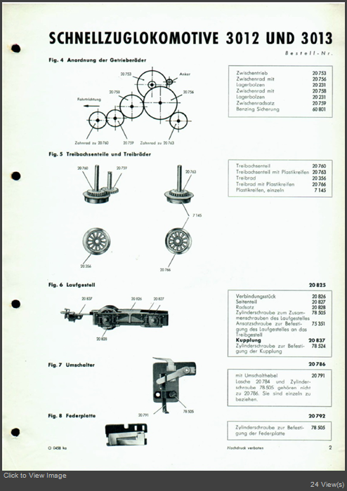

Basically there are two near-identical models, both released in 1955 and differing mainly in colour.
SEF 800 is Green, became 3012 from 1957 (F = France)
** I believe the body is still marked "SEH 800"? **
SEH 800 is Blue becoming 3013 from 1957. (H = Holland)
Determining the exact year range for models like this will come down to specific details including Panto, Couplings, roof colour etc, assuming parts are as original
CATALOGUE IMAGE from 1956 and BW page introducing the new number
PARTS SHEETS from 1958....
And, the all important multi-linga original instruction leaflet (PDF 2.4Mb)
3011_3012_3013_3014-68311-an-1057-en.pdf (2,477kb) downloaded 40 time(s).
(Image is the cover only)

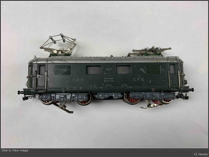

Here is a similar one. My parents got it for me, used, in the mid 1960s. I think it is a model 3014, but am not sure. It still runs fine. It's heavy (metal) and has a strong motor. I never digitalized it (i.e. installed a decoder), but am thinking of doing so now.

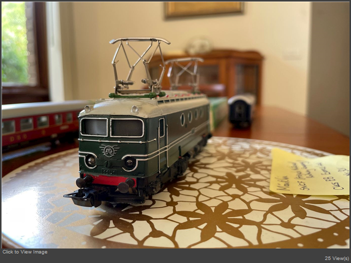

An update on my SEF/SEH/SEW/3012/whatever - it goes perfectly! I got my new transformer in the mail yesterday and, thank you Cookee, plugged it in and tried out the loco. Initially, nothing but after adjusting the slider a bit, full motion forward and reverse! 3 out of 4 headlights work.
I'm going to give it a clean and oil before using it too much more. I'll just slip in the comment here that I bought the damn thing to look at and now I'm completely hooked - I've got lots of track on order and am thinking about a layout!!!!
