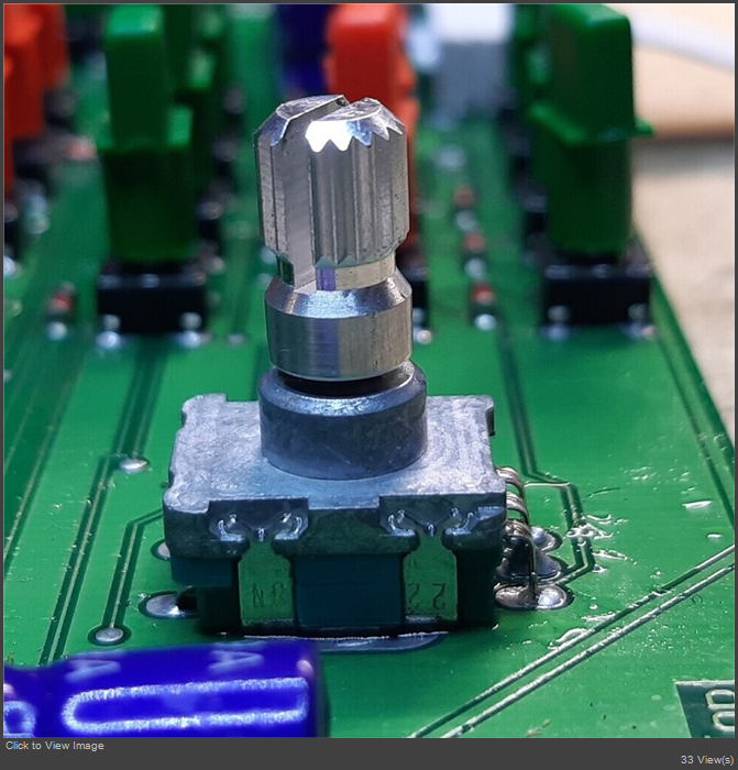

Hi, once the S88 was solved, now I start to have problems with one of the rotary knob/throttle.
Question then is: Did any one replaced one of the rotary knobs? Is there a reference to search for it? It seems to be a "rotary encoder", but I have been told there are many of them and I was not able to find any external reference of it on it (maybe in the bottom, but I didn't unsoldered it yet)
Additionally, how can the plastic knob be taken out of the rotary axe? It seems to be really very hard to do...
Thanks for any help.

I'm pretty sure this has been discussed on this forum before, but BigDaddys commonly requested links thread doesn't list it. I have seen a spare part number for the encoder, but don't think it was on this forum.
after searching my folders I have found what I believe is the data sheet for the encoder used (see attachment), and from my understanding the shaft used by Uhlenbrock is a standard length and form.
04-CI-11v04.pdf (161kb) downloaded 62 time(s).
From memory the one used is the first one listed in the notes just under the block that tells you how to decode the part number. If not then it is the third one.

Hi, thanks to all of you. Yes, I did a search for "Rotary", "Knob", "encoder" etc, mixed with Intellibox and didn't find it.
The CI-11 reference seems to be a good one.
I also found a thread in the IBX group in groups.io (maybe coming from the old yahoogroup one) that seems to be very helpful and has a reference to the same device, after a recommendation of first do a cleaning of the rotary with contact clean as WD-40.
So, I will do a try to the cleaning and later one, if there is no good result, will look for the CI-11, the remaining question is "which model of the Piher CI-11 to order?. I will send a PM to HO for advice.
Thanks again

If it helps, you could take a look at this thread - https://groups.io/g/IBX/...hrottle_encoder/85036387
They discuss this topic and one of the suggestions made is to clean the encoder, with apparent success, but the essential thing here would be the quality of the cleaning agent you use.
DISCLAIMER - I'm only repeating this here because it's reported to have worked. At the bottom of the discussion mention is made of using WD-40. I would definitely NOT use that because of the residue left behind. You really want a high quality non-residual spray suitable for electronics. Advantage to that is that you need only remove the knob to access the shaft. The encoder is sealed but a quick spray at the axle of the shaft should be sufficient. My personal take on this would be that you have nothing to loose trying this to see if it helps. It's definitely proceed at your own risk. Allow time for the cleaner to evaporate before judging the outcome.
Alternatively, if you wish to attempt repair yourself you can search for a replacement Encoder (image from the group link above)
I have two faulty ones here that are identical to the one shown, they are ALPS brand, but no other markings. Looks like the important details are the number of pulse steps (30), the shaft length and type, and that it includes the push-button for reversing and menu selection.
A further option is repair by Uhlenbrock themselves.... https://www.uhlenbrock.de/de_DE/service/index.htm
And I noted this kit that was listed a while back - https://picclick.fr/Set-...ibox-1-192428140670.html
So there are a few options

Cookee, thanks a lot. Yes, this is exactly the conversation in IBX grooups.io I was referring to. Thanks for your advise. I do have a contact cleaner that "claims" not to have residues, will try it first and, if it doesn't work, nothing is lost, because I will have to replace the encoder anyway.
Thanks again
best regards.
No markings - that's a shame. IIRC it was that IBX thread that put me onto the Piher data sheet that I posted. I have looked for the Piher part on RS, Farnell, etc, but haven't found a source, so may have to wander down the Alps product guide to see what is available that may be equivalent and available.
