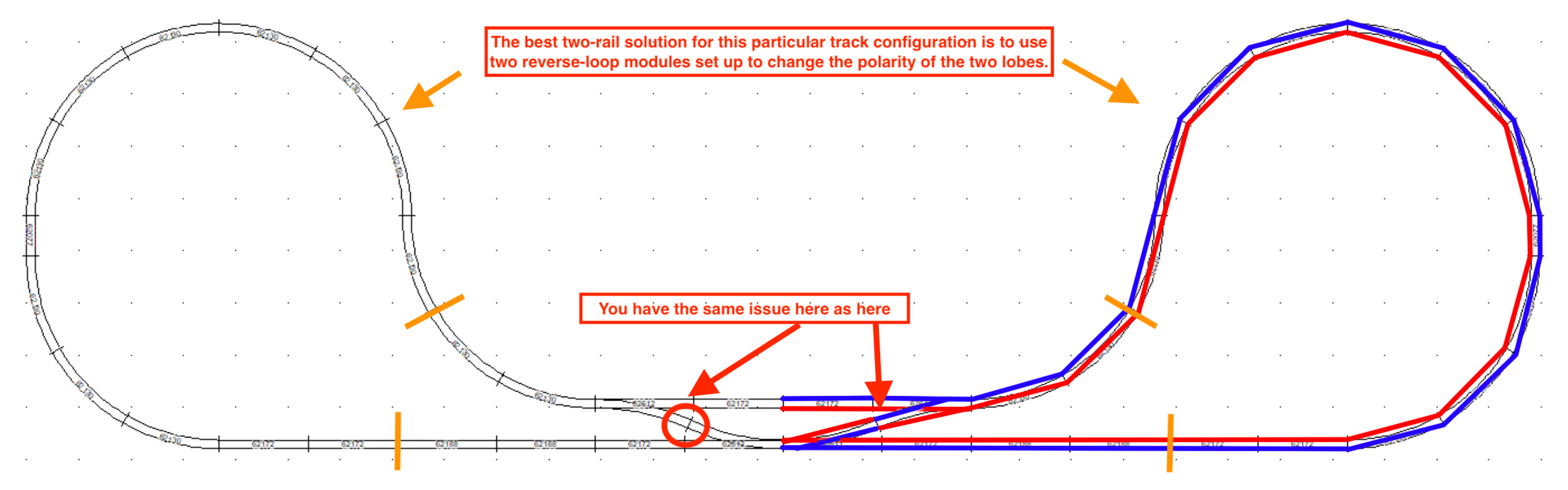

I played with this Trix layout in Scarm, and I`m not sure if this is working, in my mind I will have reverse polarity at the turnout, am I right ?
Yes, hence the inherent problem with 2 rail track when it is used to power the lok. Some manufacturers make a “black box” that reverses the polarity when the lok enters that track section. IIRC, Digitrax (not an endorsement) makes such a device.
Steve
thanks 2 users liked this useful post by vmsysprog
Steve
Trix also make such a device. See Trix 66846.

I ve seen some examples on Youtube, but I only seen the a reverse loop that goes in the same turnout, and the reversed loop is electrically isolated. But in my case, if two turnouts have different polarity, it there a way to make them work with Trix 66846 ? It`s probably a very complicated thing, I figure it`s best to avoid these situations anyway Smile Capture_03.jpgCapture_02.jpg
It can be done with a single reverse-loop module but is very tricky. In two-rail systems with reverse-loop modules the track segment(s) that reverse polarity must be at least the length of the longest train if metal wheelsets are used on the wagons. Otherwise, a train that bridges the reversing segment will likely cause a short circuit. The best solution for the particular track configuration you have drawn uses two reverse-loop modules. All this assumes you are using digital control (DCC, or mfx). It is much more complicated to automate the polarity switching with analog control!
