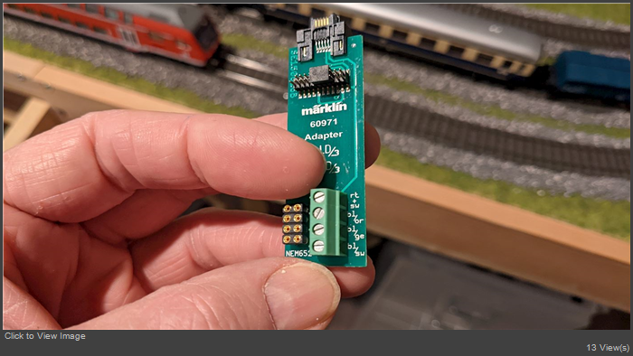

Picked up a 60986 Marklin sound decoder for a loco with very limited space inside. Soldered the wires from the decoder to the male 8-pin connector in accordance with the Marklin instructions (P28, 29), see pic below. Checked all connections to the pins, etc. All good. (Interestingly, it appears that the wire colors out of the decoder conform not to the Marklin color scheme, but rather to the NEM or ESU color scheme. No big deal.)
Have not wired the other half of the 8-pin into the loco yet, but plugged the 8-pin connector into my ESU decoder tester and EVERYTHING worked perfectly with the generic diesel programming from the factory. Sooooo, wanted to reprogram the decoder with the correct data for the specific loco. Plug the 8-pin into the Marklin 60971 programmer (yes with pin 1 to pin 1), and tried to read the decoder. The MDT3 reports the decoder not answering.
The connector is wired per the Marklin instructions. The decoder works perfectly in the ESU tester. I don’t know yet if it’s going to work in the loco, but figure it should as long as I use the color scheme (NEM/ESU) from the female 8-pin to the various loco parts. But cannot figure why the Marklin programmer can’t see it or the decoder won’t respond to the Marklin MDT3 software.
Any thoughts? Thanks.

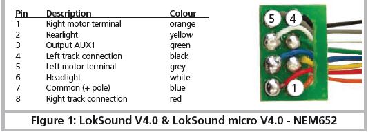

Originally Posted by: JDennis Go to Quoted Post
Interesting idea about reversing the connector. The 60971 board has the "1" pin clearly marked on it, so figured that should be right. Very difficult to reverse it, because the soldered-on wires conflict with the green terminal block.
If you are using the ESU / NEM colour scheme, normally the orange wire is on pin 1 - at least on ESU decoders it is.
That seems to line up with the page you posted from your decoder manual.
If you don't have the orange wire on pin 1, then maybe you've soldered the wires on the plug back to front.

Golly, that really should have worked. The way I read the 60971 manual, page 5, you plug in the 8 pin connector, then connect blu/or (blau/orange = bl/or) into slot E, and blu/yel (blau/gelb = bl/ge) into slot F. With the 8 pin connected, those are the only two additional wires you need to connect.
Still encoder will not answer.
OK, now let's be sure the 8-pin is still right. Stick it on the ESU decoder tester and EVERYTHING works perfectly: lights, sounds, motor. So that's not it.
Put it back on the programmer, hook up the two blau striped wires. Can't imagine how one could screw up (catch the pun) the two wires into the screw terminals.
Still won't answer. I just don't get it. I'm jinxed.

You could check the continuity of each of the 8 pins in the socket with the plug with your voltmeter.
Insert the 8 pin plug and check the continuity of each solder point on the plug with the corresponding soldered pin on the backside of the 60971 board. Perhaps one of the pin sockets is bad.

OK, mark this on your calendar: Something worked!
I find nothing in the book to support this, but following Donb's suggestion, and on the assumption that it wasn't likely to hurt anything, I hooked the blau/schwarz wire (see. I'm practicing my German, figuring that "how are you" and "can I have another beer" isn't a sufficient command of the language to get very far) to terminal G on that little green block on the programmer. Guess what?
Came right up, recognized the decoder, accepted the new program without a hitch. Went down and tested it on the decoder tester and it all works perfectly. Now just have to finish wiring the chassis and another one of my locos is successfully "digitalized."
