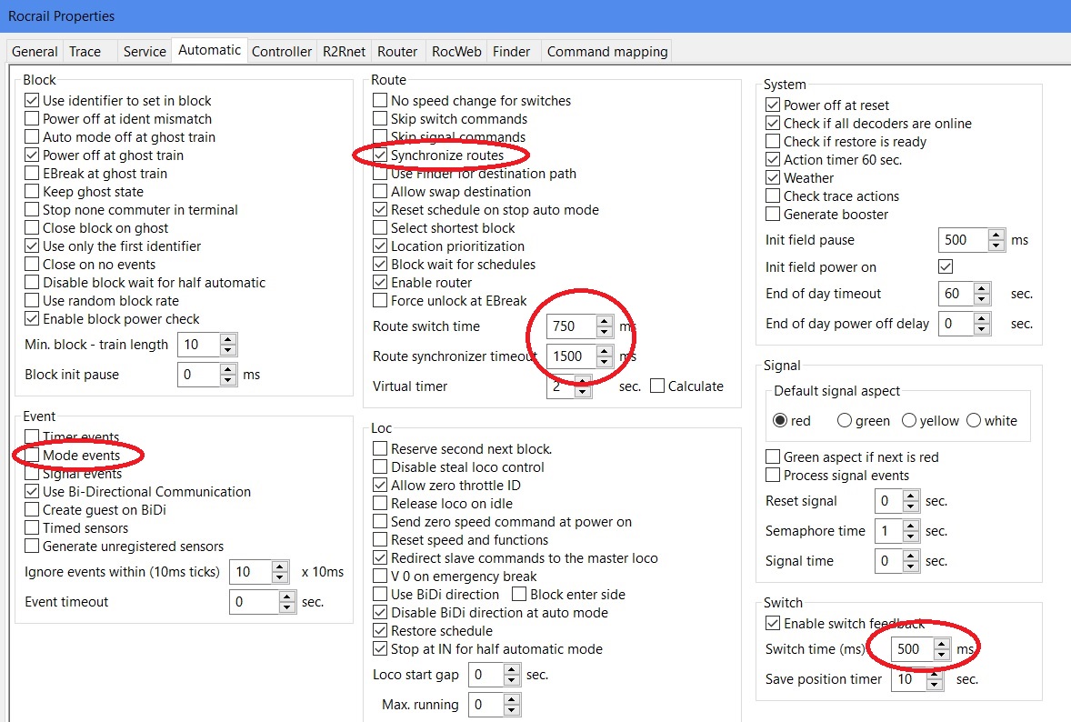

I have the DCCnext port setup as;
Accessory -6 with a buddy port, inverted, and the only thing I can adjust is the "On" time in milliseconds which I have tried from 50 to 1000.
I have read the Mardec6UK and looked for other options or settings to change, but have not found anything.
In the EcoS I have adjusted the timing for the accessory signal also between 100 to 1000 milliseconds.
In Rocrail there are so many different settings and places to adjust and change things which I have with no luck yet.
for example;
If anyone has some suggestions or ideas to share that would be great.ThumpUp
