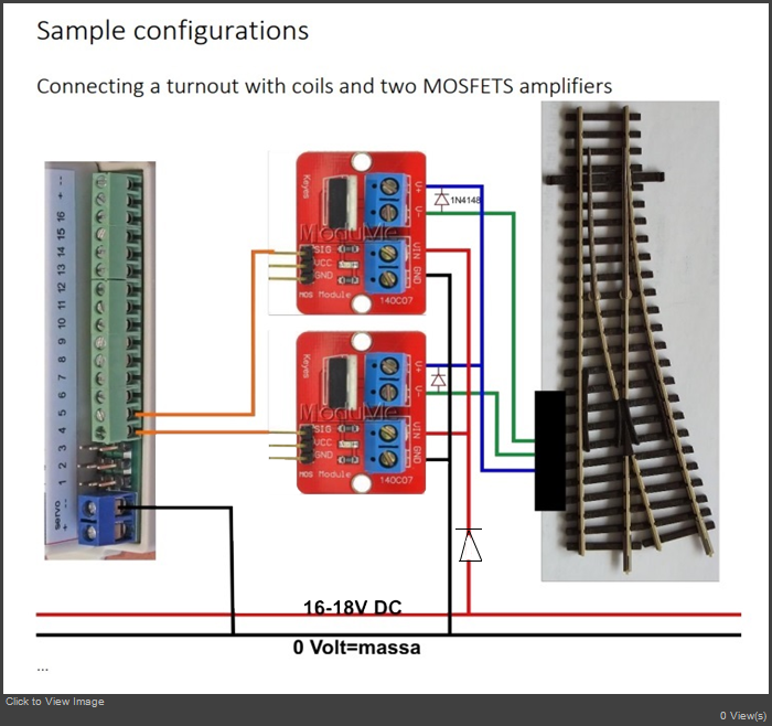

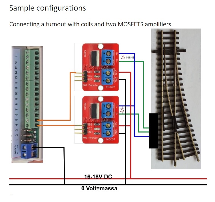

1) is to use MOSFETs to control the turnout
here the MOSFETs uses DC volts to switch the turnout.
Problem; not only does Marklin use AC volts but the Marklin yellow wire is also connected to one side of the small lantern and the other side to the brown "O" on the rails. Would this cause a short circuit?

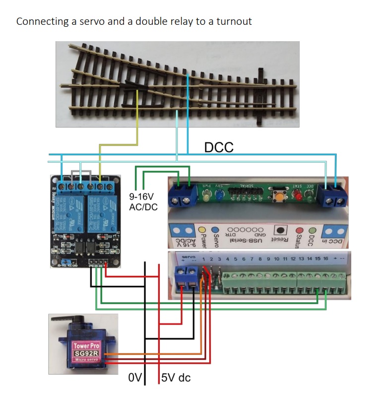

2) is to use a relay. Here the relay is used to power the frogs.
I tried connecting the brown "O" AC volts, to the center pin of the relay and one of the blue wires from the M turnout to the normally open on the relay and the same on another relay for the second blue wire. But I was not having success, the relays were cycling back and forth a few times and then would stop. I was using DC volts to power the relays (i.e. the lower part of the relay in the photo.)

for the case of AC with mosfets why not run the supply through a diode so it is half wave rectified?
or use a DC source.

For the MOSFETs you are saying use a diode on the brown "O" wire and another diode on the red "B" wire (from a Marklin transformer) before they connect at the GRD and VIN pins on the MOSFETs?
I imagine the direction of the diode is important?

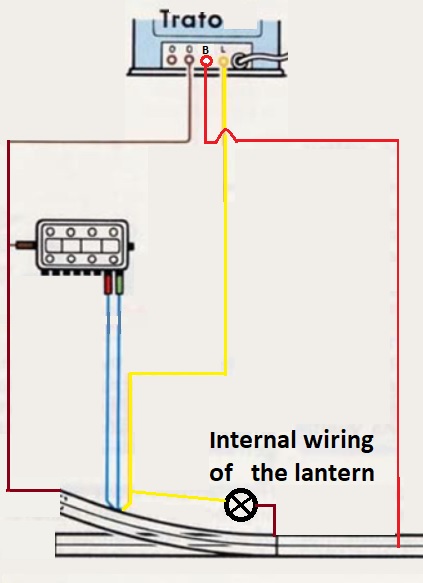

In Niko's diagram, do you know why there is a diode connect between the V+ and V- before going to the solenoid?
About using a DC source, my concern is the internal wiring of the lantern.
If I use a DC source to the MOSFETs I thing I would have to cut the yellow wire before it connects to the lantern or else it would get two sources of volts.
or am I not understanding it correctly?

The yellow and brown wires would be what you use to power the MOSFETs
Here is what I was thinking to let only the positive half of the AC signal through:
Yes, the orientation is important.
If you are new to electronics, I suggest reading through the guide I made for using LEDs at
https://cabin-layout.mixmox.com/2019/10/modelling-with-leds.html
as it goes over the fundamentals of the diodes and rectifying the AC current that you need here also.
The incandescent light in the turnout lantern is not a full short, it either has enough resistance (being an incandescent) or has a resistor if it is a LED type. However, since current is only supplied during switching the light will be off most of the time, unless you isolate it from the yellow wire and feed it power separately.
I think the diodes across the MOSFET outputs are there because they are driving coils in the turnout, and the coils send a reverse pulse back after switching, so typically one places a diode across the coils to direct the reverse voltage to the other pole. It is commonly called a flyback diode.

What I don't fully understand is why does the red wire only need a diode. Doesn't the black (ground wire) also cycle but in the opposite phase to the red wire? It seems like from your drawing the black (or brown wire) remains 0 volts and only the voltage in the red wire cycles between +16 and -16 volts.
That's clear about the flyback.
