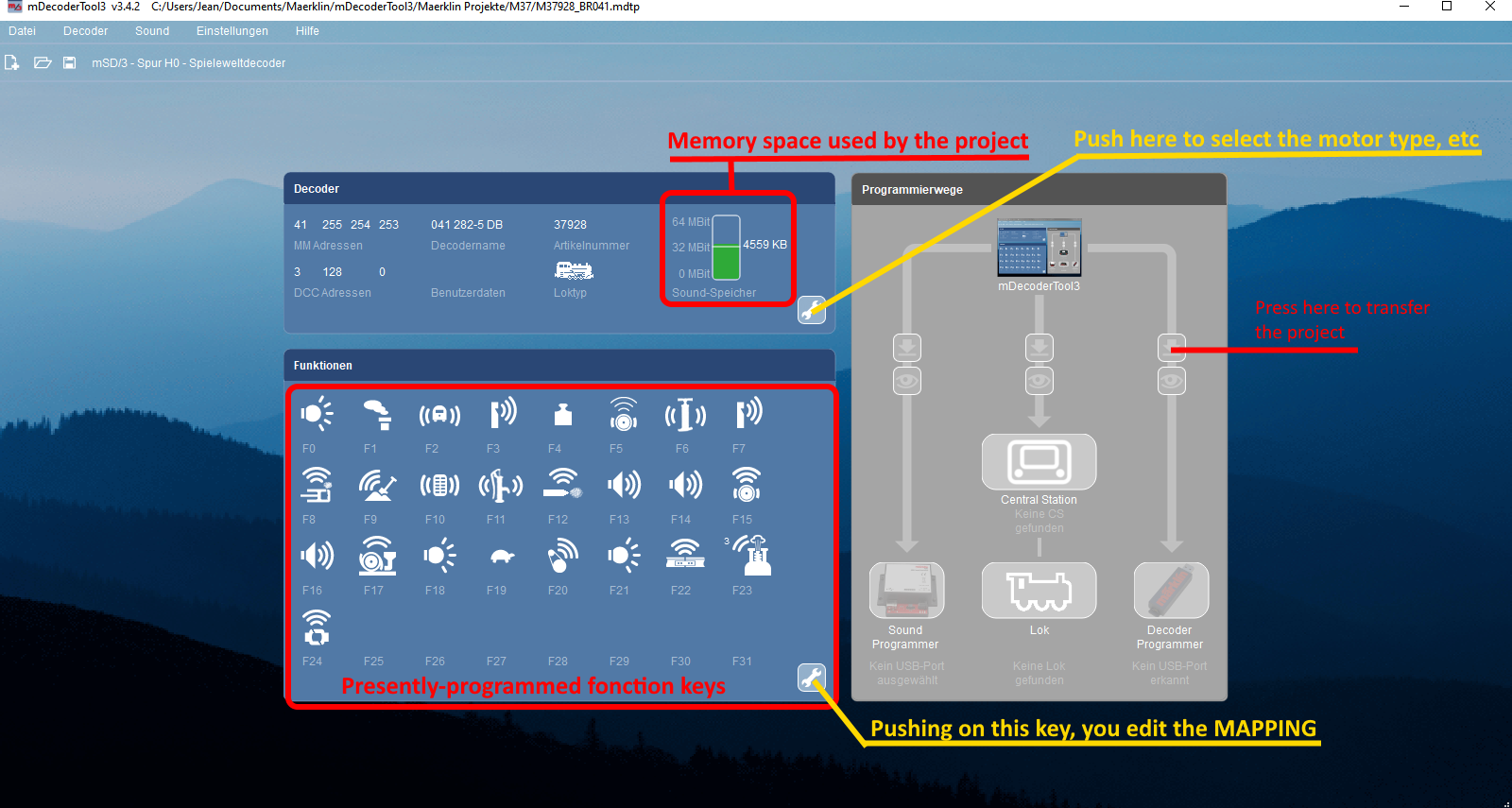

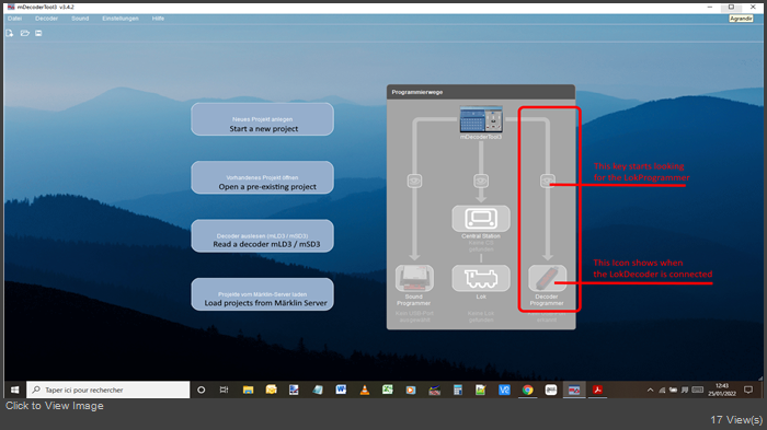

I program my mSD3 using a CS3 but also when you use the LokProgrammer you must first start a Märklin-provided software the mDecoderTool3
This program, in connection to a LokProgrammer or a CS2 / CS3 allows many things
- load "Projects" from Märklin (you look into a tree library for the model number of the loco you wish to create a sound decoder for)
- load existing / previous projects that you may have done in the past
- read the connected decoder.
Here is how it looks when starting (sorry I have the German version but you can download the English one
When starting, I strongly recommend to start with a Märklin project

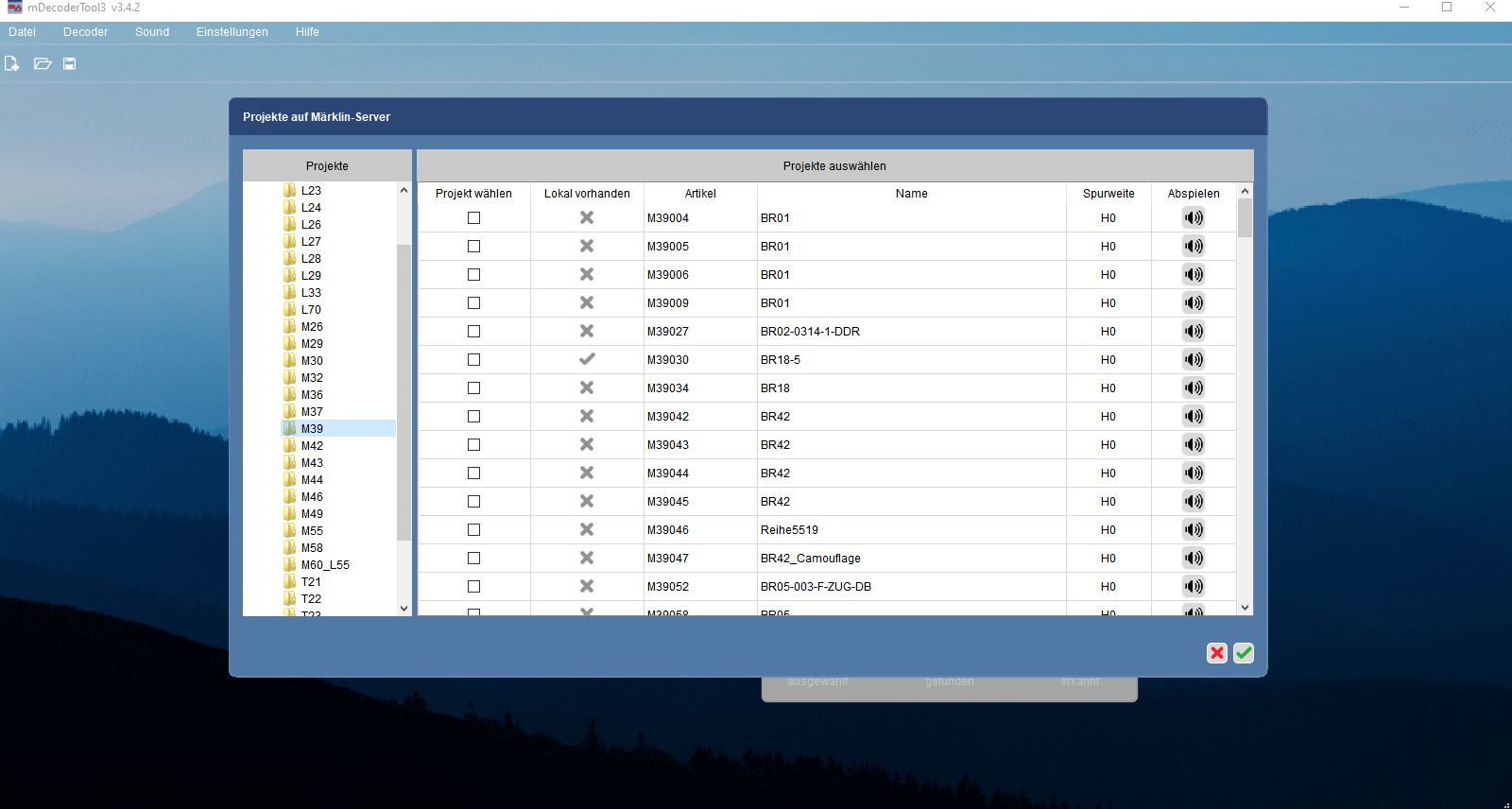

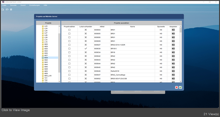

- push the key "Load external projects from Märklin servers
- then you get a screen like this
On the left column, you have a list of items where M means Märklin, L means LGB and T means Trix
Example M39 means a Märklin loco with a article number 39xxx
T21, means a Trix with an article number 21xxx
Selecting one group (here M39) open a table showing loco article number (Example M39004 is a BR01) so you may select from your exact loco or from a loco very close to the one you want
So, looking for a BR41, in the M39 section I cannot find any but browsing in the M37 section, I found the BR041 project M37928
You may check if you like the sounds by pressing the loudspeaker key.
Next you select the project and validate

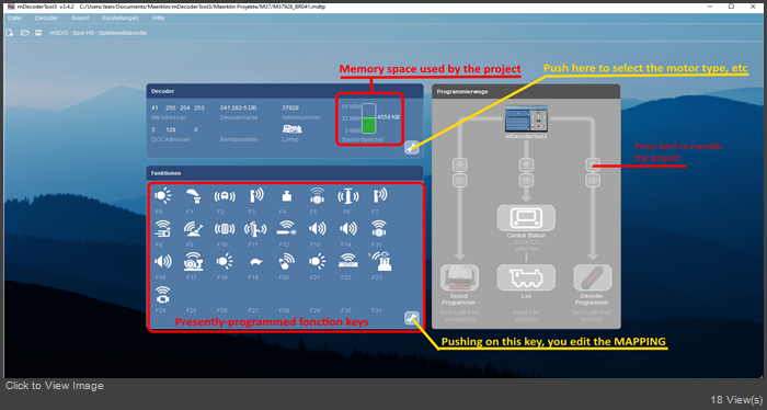

Then you get a screen like this
Now, the most important is to select the motor type by pressing the edit parameters key in the screen center
You get a screen like this where you select the motor type and also other parameters (max speed, speed curve, accel, brake delays
When finished and having entered and validated the changes, it is time to edit the MAPPING.
This is about, which fonction key has which symbol, triggers which sound, commands which output, command which special function (no inertia, shunting speed).
This is also about the conditions to these function (always active or only, forwards, only reverse, only when moving, only when stopped) and the output type (Telex, Blinking, Smoke, Mars light, etc)
When you are finished, you may save the project (for a later use) and transfer it to the LokProgrammer or the CS3 and start programming.
This is only a quick overview of the mDecoderTool3
Only when you get acquainted with the tool and the sound database can you do a project from scratch. I suggest to start with a Märklin, edit it in any way you like (including sounds, adding / changing them). There is so much more to say on this but I find the tool very powerful once you break the language barrier

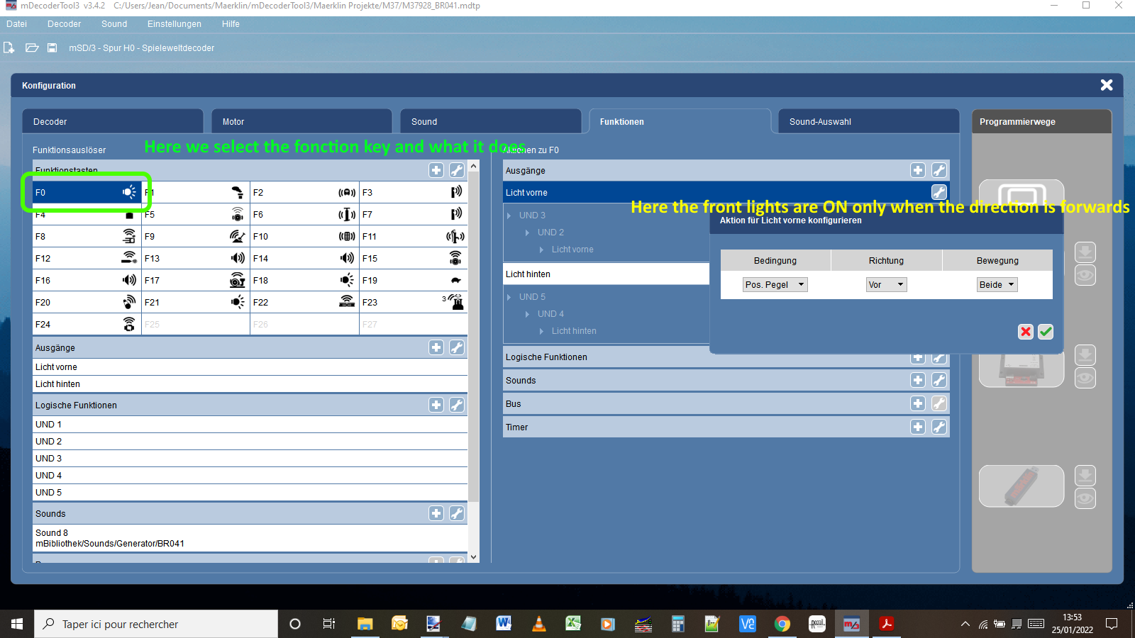

The f0 function for the headlight/taillight is utterly bizarre the way they had it set up. The lights are on if it's going either direction, stopped or moving, and then with a bunch of "AND" conditions as well. I have a cab light wired to AUX1 and it even comes on sometimes, when it seems to want to. Am inclined to eliminate most of those conditions and just have the headlight on when in FWD and taillight when in REV. Simple. That I can handle.
The F0 key activates BOTH the front light and the rear light output.
Next, the front light is only activated IF the loco goes forwards and the rear light is only activated IF the loco goes reverse.
Additionally , working on OUTPUTS (the wrench) you may decide the type of illumination / activation you wish:
- Normal (Dimmer) means you may dimm the output from 255 to 1
- Blinking
- random to simulate the fire illumination
- Telex (to drive a Telex coupling), better associate this with a Timed fonction (Turns OFF by itself after X seconds (10 is best)
- Smoke: the smoke production is linked to the speed, etc
Once you get the picture, it all works like a charm.

So far though, I have not been able to figure out how you identify the AUX1 - AUX4 functions in the programming. I mean, let's say (though not quite prototypical of course) I wanted to put a red light on the loco roof hooked to AUX 3, and activate it with f4. (Silly, I know, but let's say I wanted to do that.) I'm sure one could do that but still haven't figured out how to identify and program AUX3, for example, as an output. Also, still working on messing with sound files and putting them in memory in the decoder. There are still a few mysteries left here, but I WILL figure this stuff out.
Hi Dennis
On the mDecoderTool3 screen here you see an example of Key 0 being selected
From there you may add Sound fonction (Press + in the Sound line)
You also may add new outputs fonctions (Press + in the Output line) (here labelled "Ausgänge" because of German)
Of course, you may repeat the operation for any of the 32 keys
Of course it is easier using a CS3 because you have the result immediately.

#13 Posted : 26 January 2022 19:28:18(UTC)
Posts: 3,621
Originally Posted by: JDennis Go to Quoted Post
My haunting question (or at least one of them) is still how to assign one of the AUX functions as an output. The drop down list for outputs never offers that as a choice, so still not sure how I get to them. Suppose I'll stumble into it eventually. As I continue to explore the MDT3 software I find more and more capabilities but some are still eluding me. They're in there somewhere, right?
I may not understand you.
There are 32 fonction keys on recent decoder
There are 8 AUX OUTPUTS on a recent Märklin decoder: AUX1, AUX2, AUX3, AUX4, Front Lights, Rear Lights, Motor 1, Motor 2 (Usually used to drive the motor but NOT always).
On the screen I just sent, you select the fonction key you want to work (top left),
then on the right, you click the OUTPUT + key (to add a physical output) and select the one you want.
There are multiple drop down lists for outputs: The wrench on OUPUTS will give you a table of all outputs and their configuration (dimmer, smoke, blink, Mars light, Telex and what dimming value )
The wrench on a specific output already assigned to a fonction key will allow you to specify if it should work in both directions or only forwards, only reverse, if it should be active when the KEY is pushed or if the KEY is release (NO or NC fonction) and much more.
