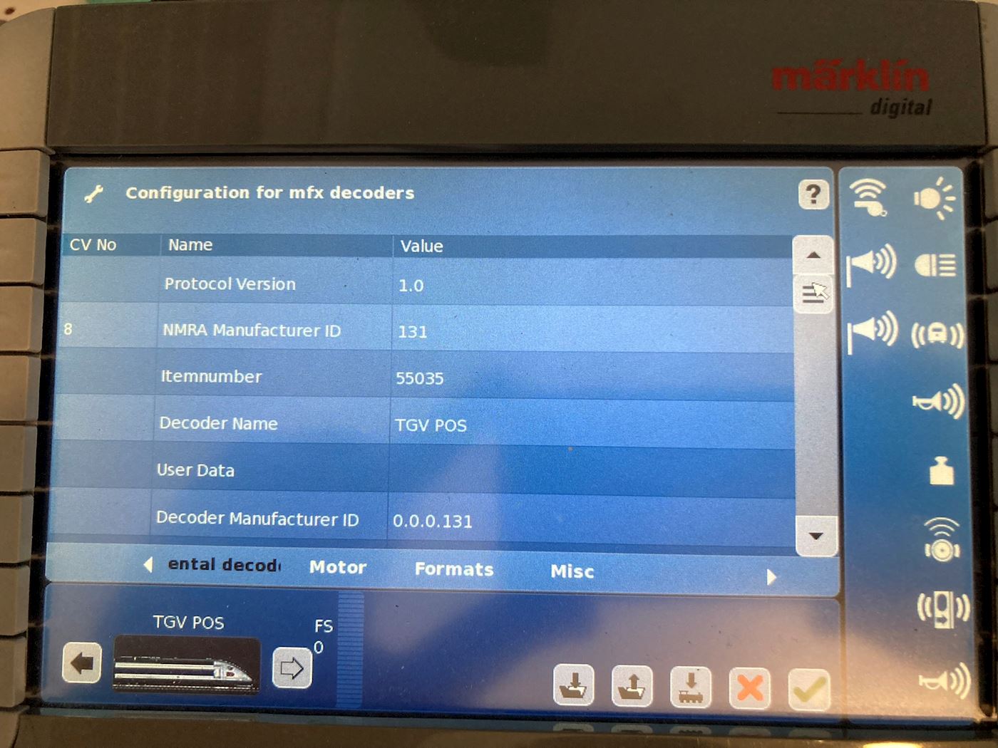

I have a weird problem with my TGV POS decoder. Although it can produce all sounds, the decoder is not recognized as a sound decoder.
See the pictures I attached.
See that you cannot edit sounds.
See that volume is geyed out.
P.S. I tried reset but sound tag does not load.

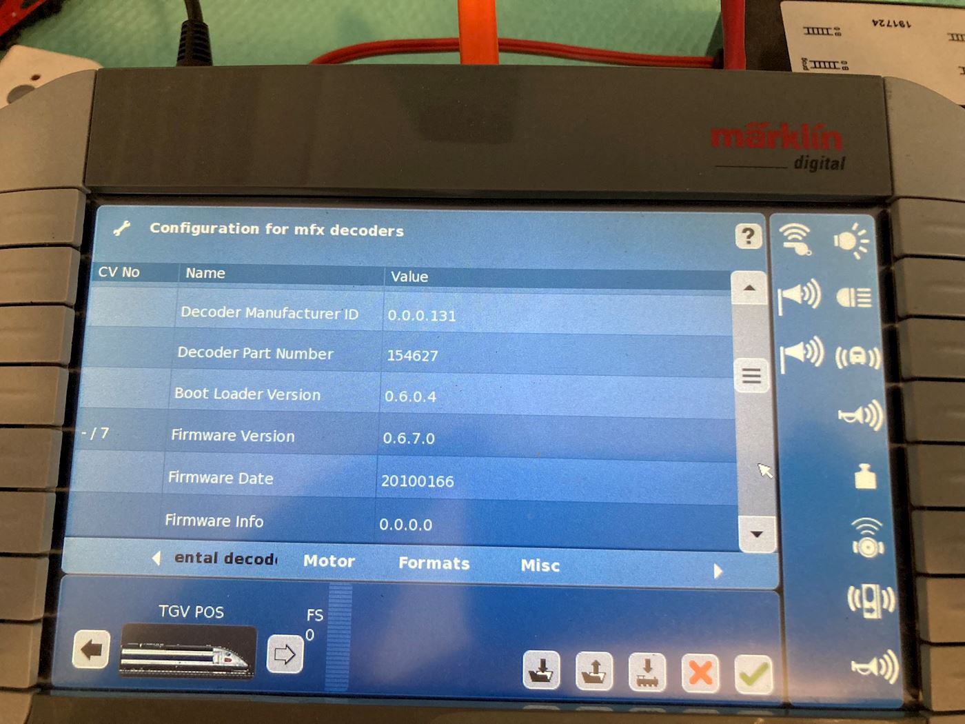

This picture suggests the firmware in the decoder is very old. I would start bt doing a firmware update on the decoder, and then see what happens.
