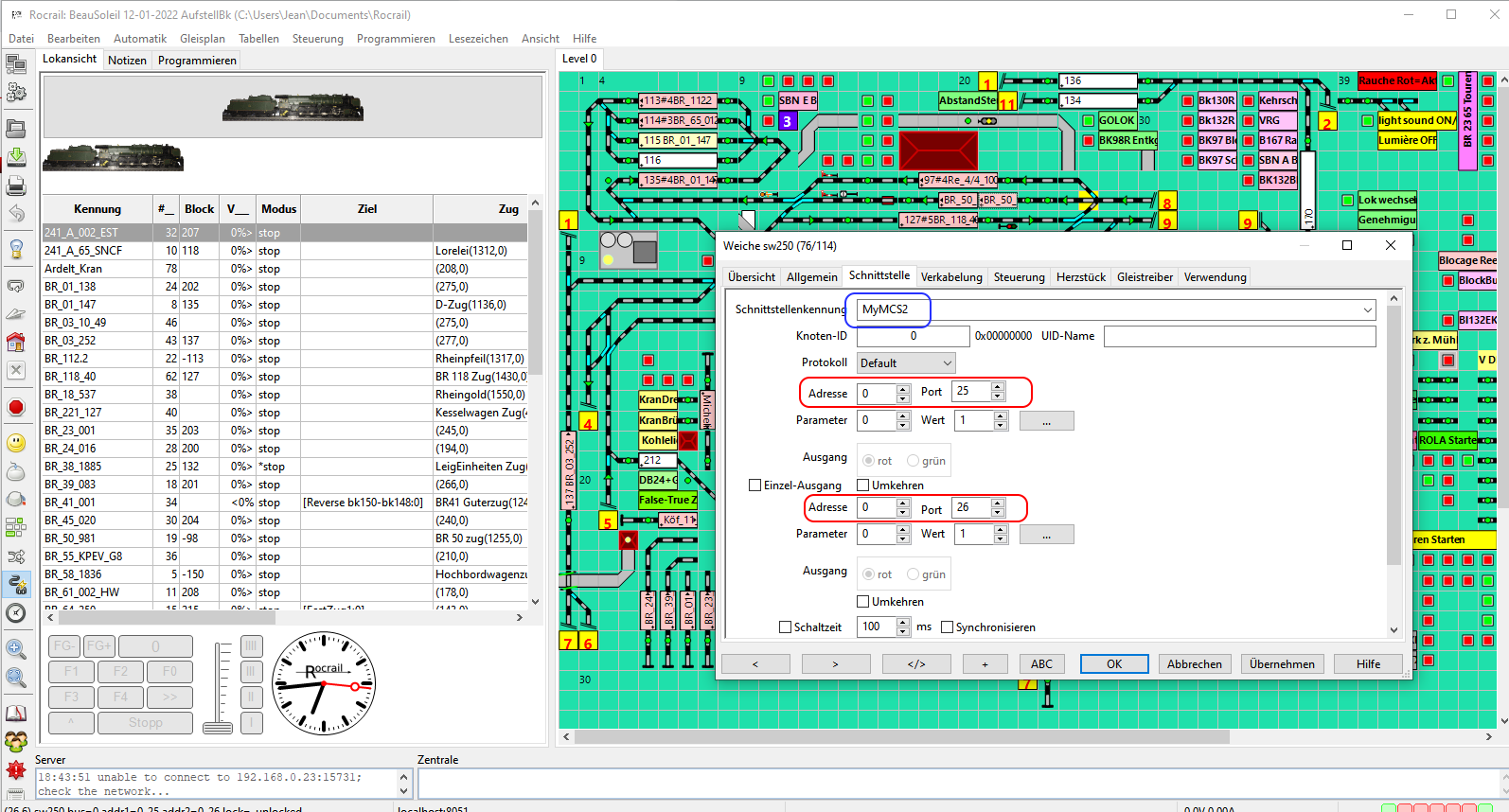

Hi Harvey
Welcome to this great forum of Märklin friends.
I use Rocrail with a CS2 and now a CS3.
Triple points work very well but you need to:
- specify 2 addresses (15 and 16 in your case)
- you may have to specify which central station is driving your point
So in the blue frame is the name of your central station (It may not require it)
In the red frames are the addresses of the triple point 15 and 16 in your case
I think that's all

JohnJean
Thanks, simple fix and it works.
