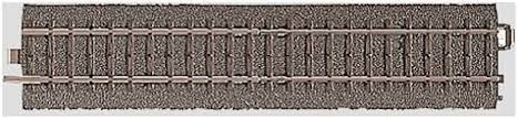

i run big steam engines if you are to use this track do not have it after a corner my be 2 track lengths before converting after staring my track with c i brought m track to use out of sight in my personals experience M track is better as long as its in good condition if using in shed or any where with damp use c track i only use c track for long blacks of contact track
hess

The problem with combining M, K and C track is that you need a full 180mm track to go from one to the other. There is no way to have parallel tracks and have a simple transition between tracks.
I also noted that the conversion track from C to M has track on the transition which resembles K track profile closer than M track. I don't understand why they did not keep the same profile as C track for the whole section.
