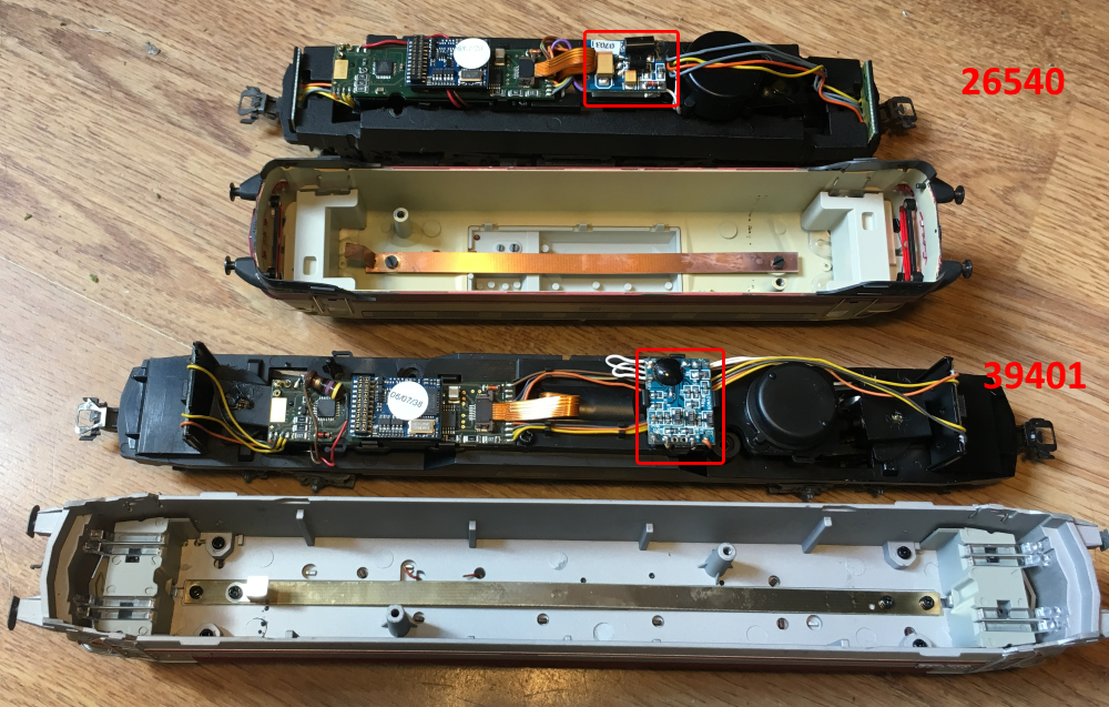

Having a few locos with separate sound modules, I experienced one of them dying too
Here are two Märklin locos with separate sound modules (the one on the bottom failed and sadly they can't be repaired / replaced by Märklin)
