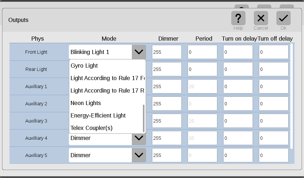

Mapping with a CS2 or CS3: put the loco on the programming track and enter the editing mode
Wait until all parameter are loaded in the CS unit, then press one of the function keys
Here is a CS3 screen on Mapping of outputs
Only make sure that no loco function calls for output 3 or output 4 (AUX3 or AUX4) which could interfere with C Sine functionning.
