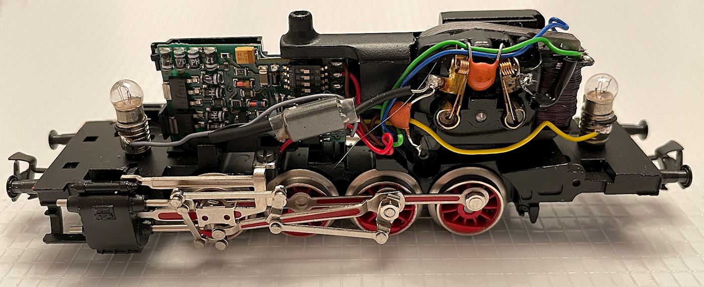

I think this engine must be related to a cat. It wants to run but won't do it and no one will force it to. I have cleaned and lubed, found and repaired a broken wire and still no movement. The wheels run freely when the motor is removed. The front and rear lights come on there there is occasional buzzing from the motor. :(
Wondering if the motor upgrade kit, 60941, would be a good route to take?
#8 Posted : 11 January 2022 20:01:02(UTC)
Posts: 8,583
A photo of the insides would be a help at this stage.

#10 Posted : 11 January 2022 23:59:47(UTC)
Posts: 8,583
I can sure try. Anything specific you would suggest? Which side or close-ups of anything?
Just a general view from the side of the loco with the brush holder visible.
Use the paper clip icon at the top of the edit window to load a file, and follow the instructions.
Here is the side view photo.

#13 Posted : 12 January 2022 03:24:30(UTC)
The brushes look OK, but make sure there's enough spring tension against them to hold them firmly in place.
You can test this by applying power to the track when the loco is on it and gently push the brush spring in with a screwdriver. If the loco takes off or show signs of movement, that was your problem.

Success!!! (in a round-about way)
I checked the springs on the brushes and tried bending them in slightly to try for more tension. No go. Then I removed the left brush (as seen looking at the photo) and reversed it. Still no go.
Finally, I used the tweezer tip to push in slightly on the right side brush and immediately heard a buzzing. Put the engine on the track and off it went! Works in reverse as well...and running now in the background to get a break-in period.
Thanks so much for all your suggestions!
