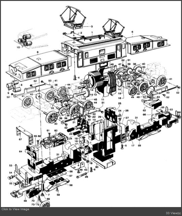

Here is the exploded view of it:
The central body can be removed by unscrewing 2 screws underneath.
To remove the side bodies is a little more complicated as you need to remove the lamp holders on each side before removing 2 side screw from underneath each cabinet.
If the loco has not been previously tampered with, then we need to check for Zinkpest (sadly it may happen on very old ones) and for corrosion on the motor's collector.
Once the bodies have been removed, remove the motor brushes and check if the motor is rotating freely. Don't try to rotate it through the wheels as there are worm gears.
With hear buds and a small brush dipped in lighter fluid clean gently the mechanism.
With another hear bud with most of cotton removed and dipped in lighter fluid, clean the inside of the brush holders.
Then add a little oil (Märklin oil or car motor oil) on axles and worm gears.
Then put back the brushes and connect the loco to a Märklin transformer and let the loco run for some time while checking nothing gets too hot. This will clean and restore the surfaces of the loco.
