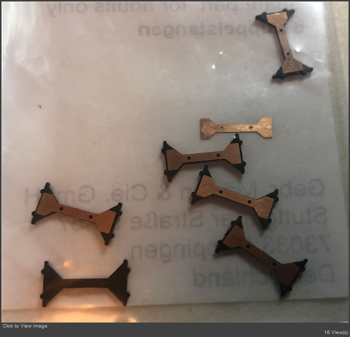

4733BF27-6AFE-4419-9C11-1301D5FC6CC4.jpeg73D5AF4A-3B32-4DFE-9F3E-DA55BAFD83CB.jpegAccording to ‘Collection Märklin Spur Z’ book these are the current conducting couplers used in the 88712 ICE3.
This is a sealed packet of 6 of these couplers, note that one of the couplers has already been parted from its copper track!
There are two holes in the copper part and two pips on the plastic part, these are merely for locating the former on the latter and do not fasten the parts together. Therefore Märklin presumably used some sort of glue to (attempt) to hold them together. I wonder what sort it was.

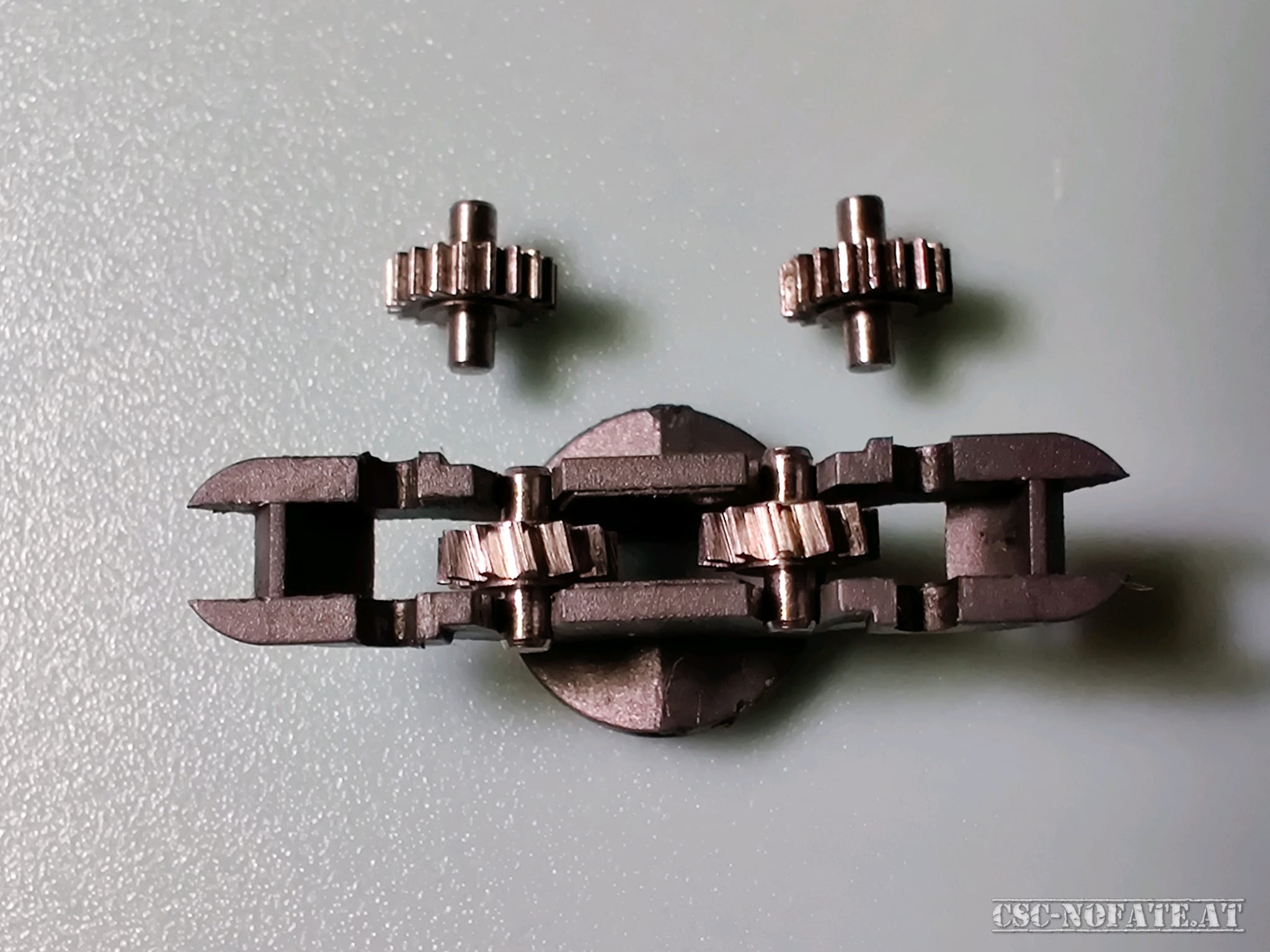

Hey beautiful people in the mini world!
I have a question about the same set. So I just received a previously owned 88712 and the guy who sold it to me claimed that the set is working properly, although he didn't test it on the track. So it came today and I tried to run the motor on the track, but it didn't move. So I took a look inside, especially the gears in the trucks.
The truck on the pantograph side has no issue, it rolls freely and got so much better after I oiled them. However, the gears in the other truck are jammed and won't roll. I disassembled the truck and cleaned the gears and the housing. If I try to spin the gears without the cover, they are all spun freely, but as soon as I put the cover back, the gears went jammed again.
So, my question is, is there anything else that I can try to free the gears in that truck? What may caused the gears to jam, even after cleaning?

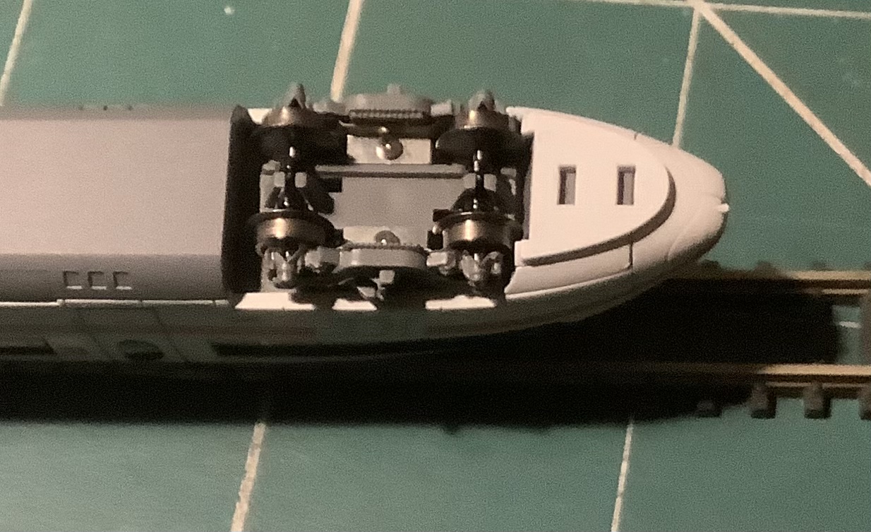

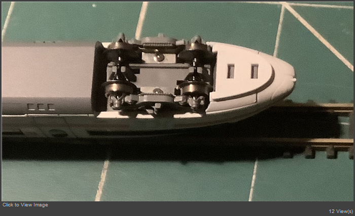

After adding a fifth car to my set I am having an issue with the front truck of the car behind the power car derailing on my 220mm curves, it just gets sideways but still runs along the track, reversing the train solves the problem and it will circulate in reverse reliably, but going forward it sometimes leaves the track (just the front axle of the truck) making a telltale rattling sound. I'll have a look later, hopefully either the axle is binding or the truck is not turning freely. That is the only really annoying part of the ICE train, getting it on and off the track with this darn couplers.
Zme

Hey Dwight,
I did your suggestion to swap and the same issues follows....bummer! I think that solves the mystery and I will need to look a replacement for the broken components 😥

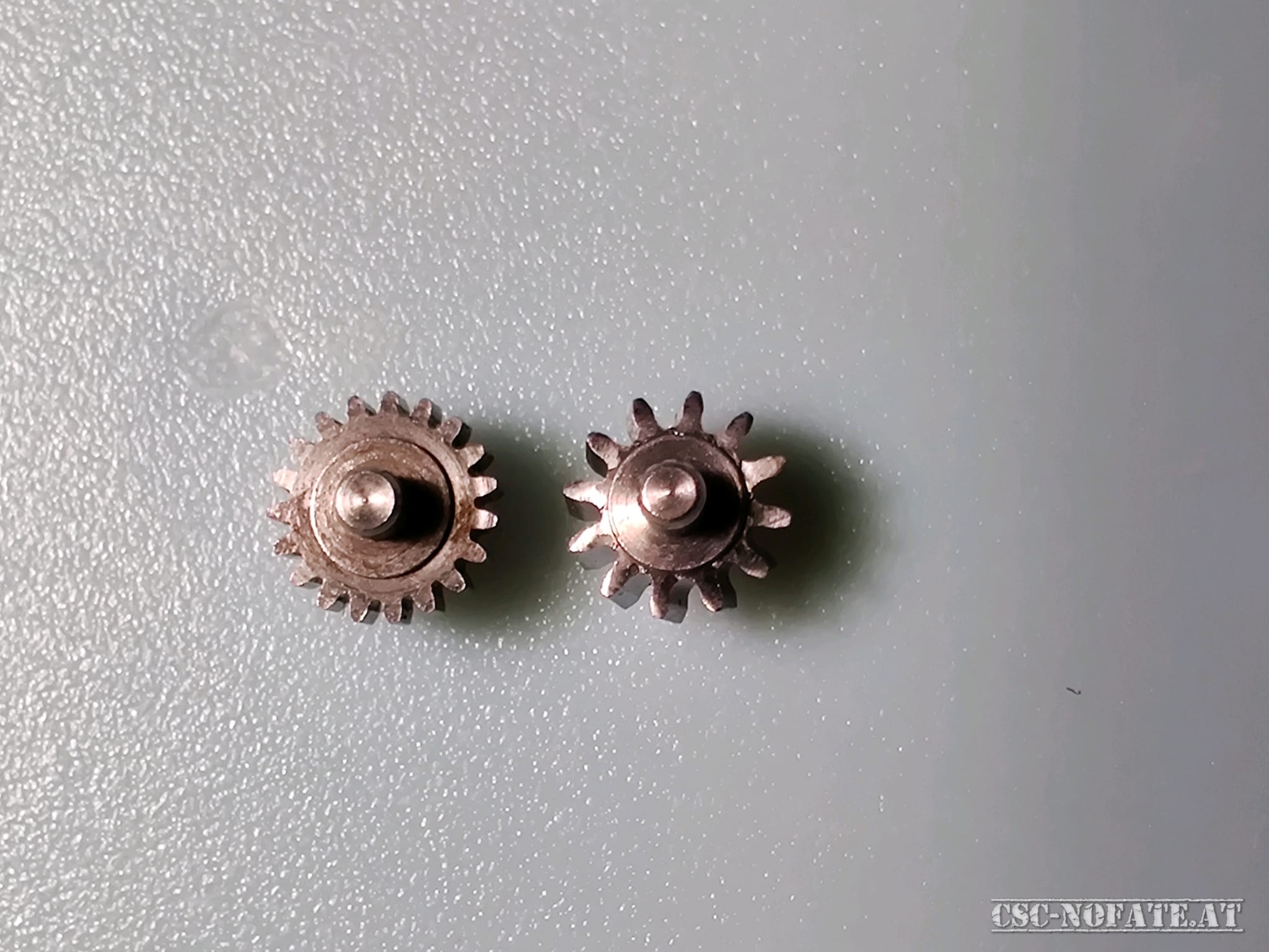

So before I read your reply, I took a picture to illustrate the problem with the jammed truck. So what I found is the wheels are rolling in a different direction.
This is the view from the bottom, without the base of the truck
More strange was that the gears could spin on direction without the base of the truck, but when I put it back, all the gears became stuck.
Well, none of that matter anymore, because I don't think the gears are serviceable, right? Even if they are, I believe it would be much cheaper to find the spare parts. Oh well, I knew this was the risk and I'll enjoy my hunting again 😊

That worm gear axle looks wide, how does it compare to the other one?
Does that truck assemble look undamaged?

Are you sure that those idler gears are sitting correctly? The lower one looks as if it is a bit off (could be the photo) - is the moulding of the bogie smooth, there could be a bit of flash causing things not to sit properly. I think that this might be the case with the base cover.

Good job wildstix! You have found the problem. And Zme predicted this: "It is possible this was damaged by a previous owner, and when that owner could not fix it, passed it on to you. It happens and often the seller doesn’t really know anything about what they are selling."
I think your loco has an incorrect gear installed, maybe the original was lost... Maybe count the teeth and compare just to be sure.
This kind of thing happens all too often when buying old locos on the auction sites. I referred earlier to a loco I got that had had its trucks swapped, it was also missing a light bulb fixture, but it came with a mechanics certificate saying it was repaired and tested, in excellent running condition! I did get a partial refund for that which I used to buy a light bulb. I have gotten steam loco's that had their wheels out of sync. In your case maybe it was an estate sale or a situation where the seller is not to be held accountable. But I still think if money changes hands then a refund (even a partial refund) should be possible. Here's an Ebay joke for when this happens: If the seller is unaware of what they selling then they are criminals, and if they are aware of what they are selling then they are criminals!
Carim
Hey Carim,
I wasn't sure myself until I swapped the gears between the two trucks. The same issue follows.
So truck A has good gear set and truck B has bad gear set. I swapped truck A's gear set to truck B and they are still working properly, while truck B's gear set are still jammed when in truck A. The fact that the good gear set can spin properly in any truck, eliminate the chance for moulding imperfection and narrowed down the actual problem. That is why I believe the problem is gear set of truck B.
I have shared this to some of the Z scale wizards I l knew and their conclusion is the same. One of them even suspicious that in the past, someone made a bad repair and installed the gears with a wrong size. Well, whatever it is, I still need to find a replacement for the gear set 😔

0CD74DAB-60F5-4BEB-9963-73B3A91FA8E9.jpegI have just had a close look at the pickup arrangements for the 88715 ICE 3, there are only bogies with pickups on the two driving trailers, none on the centre coaches iand none on the additional coaches.
I don’t know if this is the same as the 88712 but it is very different to the old 8871 arrangement which have pickups on every vehicle, not for traction supply in the case of the middle coaches but on these they are just to power the lights in that coach, which results in very uneven illumination. There are mods that can be done on these centre coaches to connect each coach lighting supply to the traction supply that simply passes through going to and from the front and rear power cars. This makes the whole consist far more reliable but isn’t suited to auto running since the isolated section in front of a red signal would have to be at least the length of the whole train.
The type of pickups which are used on the 88715 driving trailers are similar to the snow plough ones (81360) which are troublesome, lets hope these don’t go that way.
ChrisG

After hours of unsuccessful attempts, I finally sent my 88712 to my friend, a Z scale wizard, in Austria (Anybody here around Vienna?) He found two issues with my set, the engine contacts and the gear set in the motor car (obviously).
The engine contacts show signs of sloppy repair, and one of the causes of why the train set only moves forward. He had to clean the sloppy solder from the circuit board and re-solder the engine contacts. He also re-soldered the blocking diodes on the circuit board, practically rebuilding the electronic system of the engine car. The result is that the train set now can move forward and also in reverse!
Then the gear set. So I took a chance to order the truck set for 88715 (sent it directly to my friend), and when he compared them, it was clear that the old truck has the wrong gear set!!! Below is the picture between them.
Right: the correct gear (for 88712 and 88715)
Left: from my train
Above: from my train
Below: the correct gear (for 88712 and 88715)
The other truck is luckily still with the correct gear set. We only need to replace one truck and the 88715 truck set (including the gears) fits right in! So Dwight, you now can be sure that the trucks components for 88712 and 88715 are the same!

That is great, thanks for showing us the correct gears. Shame on whoever messed it up and sold it off but I tell you, with this gang on the forum, the buck stops here ;) we fix things!
