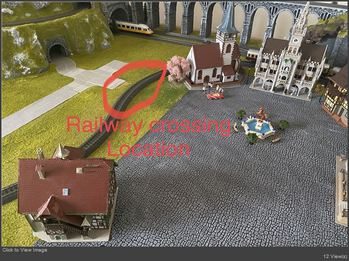

I want to add a railroad gate crossing on a curve section as shown in the attached picture.
I would like the railroad gates to close automatically when the train approaches and open automatically once it passes, no control from me. and noticed the Faller 120171 might be a good fit for this.
I read the entire manual many times on the vendor's website, but I am not too sure on how to proceed.
I have a digital layout operated by a Marklin 6021 on a C Track system. It says in the manual to use a switch Track (24994), I am thinking of removing the sensor from that track and installing it on a normal curve track to get this to work, but I am not too sure.
Can anyone give any guidance on how to do this and what parts I would need ? or what kind of rail crossing would you recommend for this type of project. Much appreciated.

The 24994 contact track is also produced as a curved section under a different number. The the radius of the curve works then buying and installing the curved contact track would be the simple solution

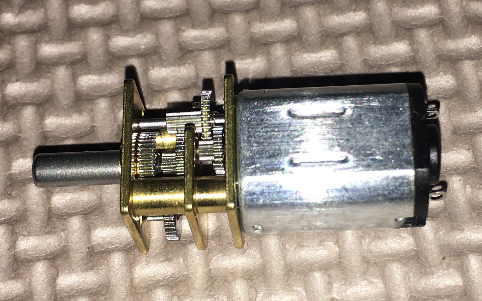

Since then, I have found a micro motor (total length 4 cm or so) from China (for 5 to 10€)to replace the one-direction motor that could for a new project be better than the included motor
The same moto is now sold by Faller under the number 180722
With a DC motor you may adjust the speed and reverse the direction immediately if another train is detected
