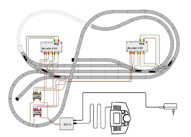

The k83 does not directly connect to the eCOS. It connects to the track power.. The other connections are the two blue wires and the yellow wire...
This image, found elsewhere on the forum shows the wring.. The blue and the yellow are done like you would normally wire the push button switch, while the red and brown are just track power..

Ok so a quick look at this is that my understanding of the use of the k83, is simply plug in the M track point, set the correct location or digital number( here i am confuddled) then run the wires from the k83 to the to the 72090 then the red wire and the brown wire run from the 72090 to the green eCoS Plug as per normal and set up the eCoS to run the M track points from the eCoS. Fingers crossed i have this correct.

Yep.. The wiring part is easy.
The K83 instructions show you how to set the address by the dip switch.. This is the address you use in the ecos on the turnout icon. (Page 23 stuff)
