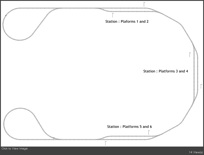

A friend of mine is constructing a large layout.
He is building the layout around the room and the layout will have 3 x Stations with passing tracks.
Signals will be placed at each of the passing tracks.
Circuit tracks are being used to trigger the signals to stop and go.
A representation of the layout is as per the attached picture.
How many trains can he run on this layout without one train catching up with the train in front ?
What is the scheduling sequence for operating these trains without collision ?
Where is the best place to insert the circuit tracks around the station area ?
We are not using 'occupancy blocks' , but do you think that 'occupancy blocks' would improve the safety of operations ?
He is operating using Central Station 2, with Marklin s88 feedback.
RegardsBigGrin

John, depends on the layout dimensions, train lengths, speeds,
Temperature of room, Motors, etc. Heat is speed.
I am poor in algebra, but the CS3 can stage events with delays.
One S88 has 6 inputs. It shows 6 signals. Unless he has a total of 12 circuit tracks, contact tracks, blocks, or reed switches, one should suffice.
Speeds of the trains can be set slower as well. It may be possible to run 3 at once. One can wait in the stations until another passes, but why not add two more turnouts and a through track?
#3 Posted : 08 September 2021 11:03:28(UTC)
Posts: 15,542
A simple approach: five trains, never more than one signal showing green. Only one train running at any time.
With fewer trains there would be an option to have two (or more) trains running at the same time.
With two more signals in each reversing loop, there would be more options.
#4 Posted : 08 September 2021 14:51:21(UTC)
Posts: 8,620
I agree with Tom, a signal on each end loop (even a virtual signal) with the end loops being inside tunnels to give the feeling of 'exit stage left/right, enter stage left/right, would help.
But I think you need more signals, one on the main line at the entry to each station so the main line sections also become signaled blocks will allow more trains to run at a time. I would also be tempted to double track between two stations so trains can run both directions simultaneously between those two stations, otherwise I think you will find that you will only ever have one train running at any one time as a block becomes clear in front of it.
#5 Posted : 08 September 2021 15:54:57(UTC)
Posts: 14,901
Or a double track all around the layout with 3 tracks in each station, this would give you a heap of options where as you could also incorporate a shunting yard, there is always the risk you could get bored and you may change the configuration at a later stage., so why not do it now.
A shuttle service between station 1 and 3 is also possible

To trigger more comments, not so simple --- I say only FOUR trains on the above layout.

With absolute certainty: 1 train. (So long as the train is shorter than the turning loops.)
Probably 4.

Five

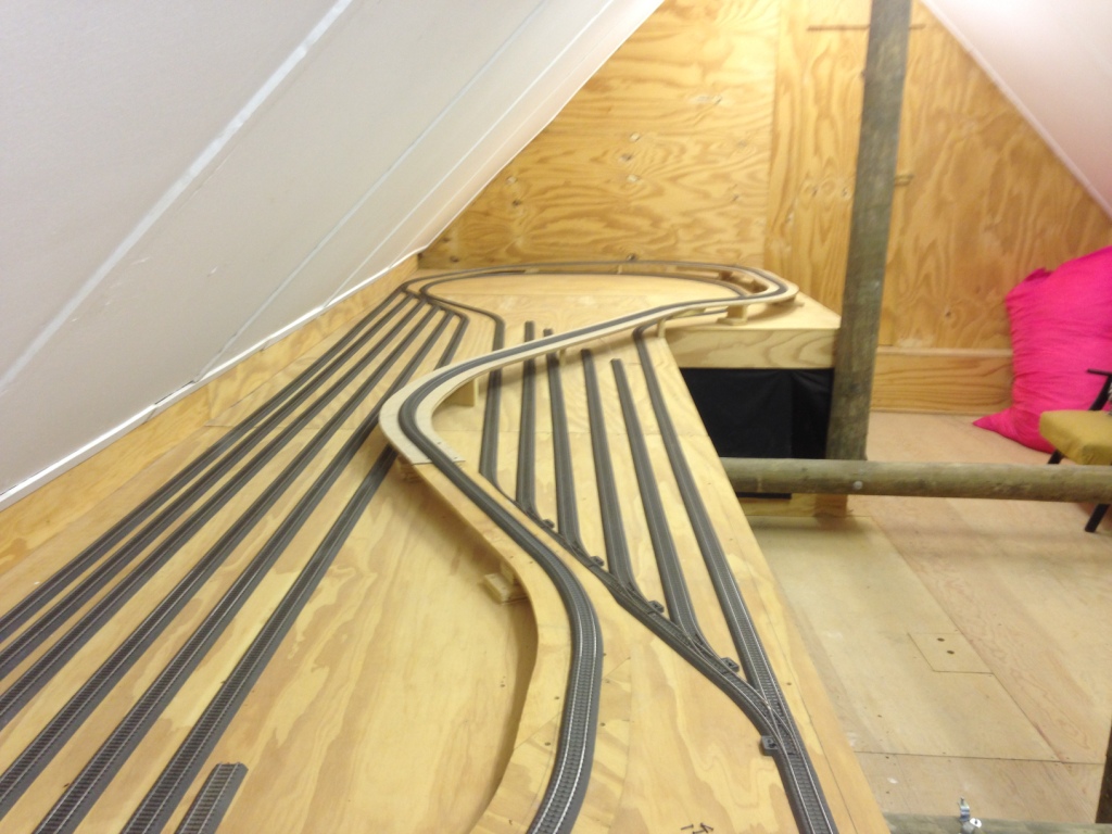

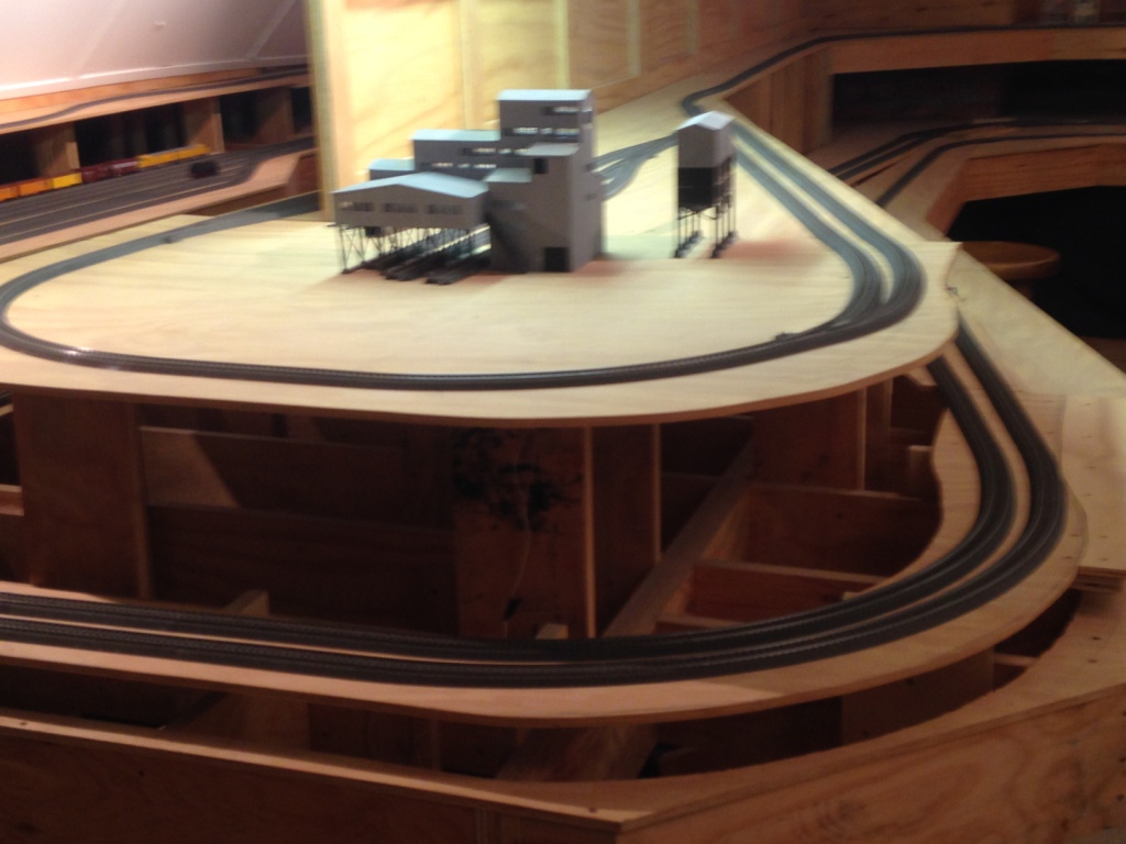

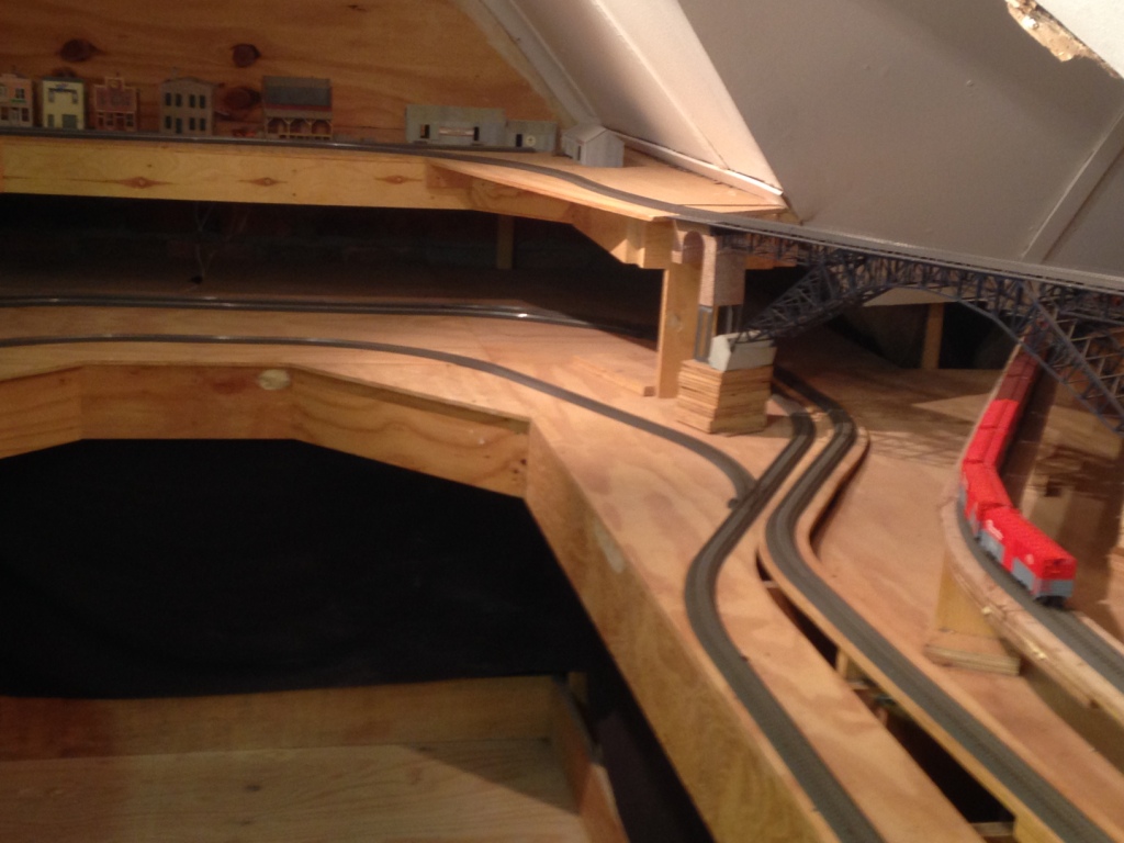

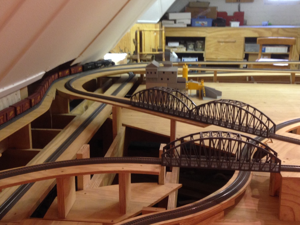

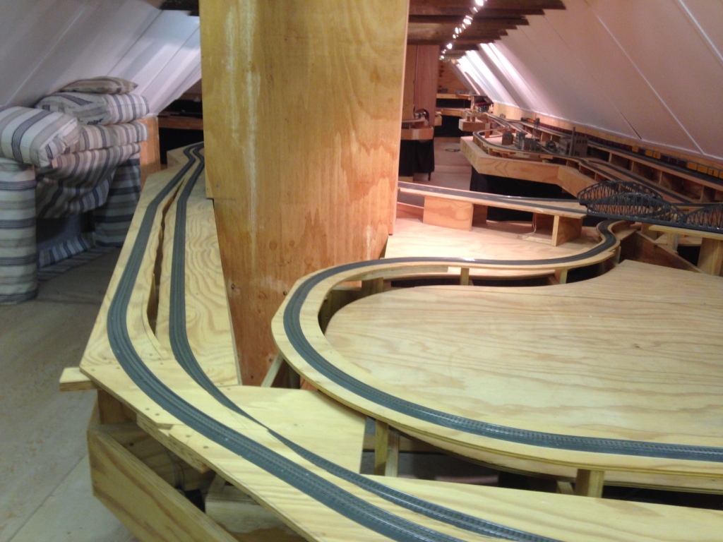

#9 Posted : 11 September 2021 10:13:35(UTC)
Johnvr
Joined: 03/10/2010(UTC)
Posts: 1,303
Thanks to everyone who has commented.

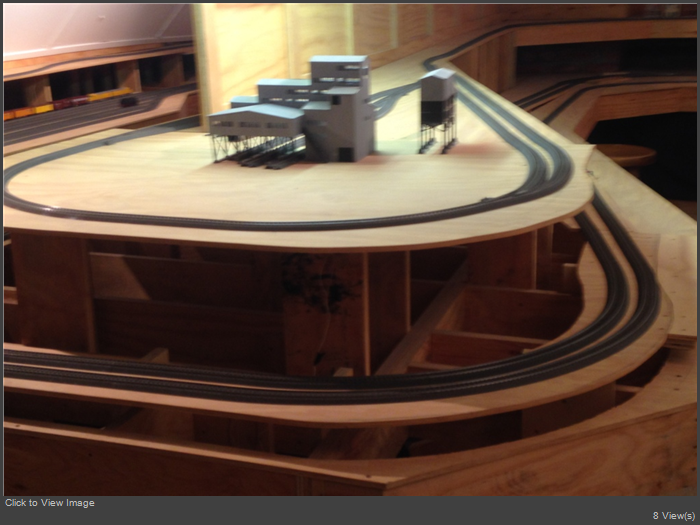

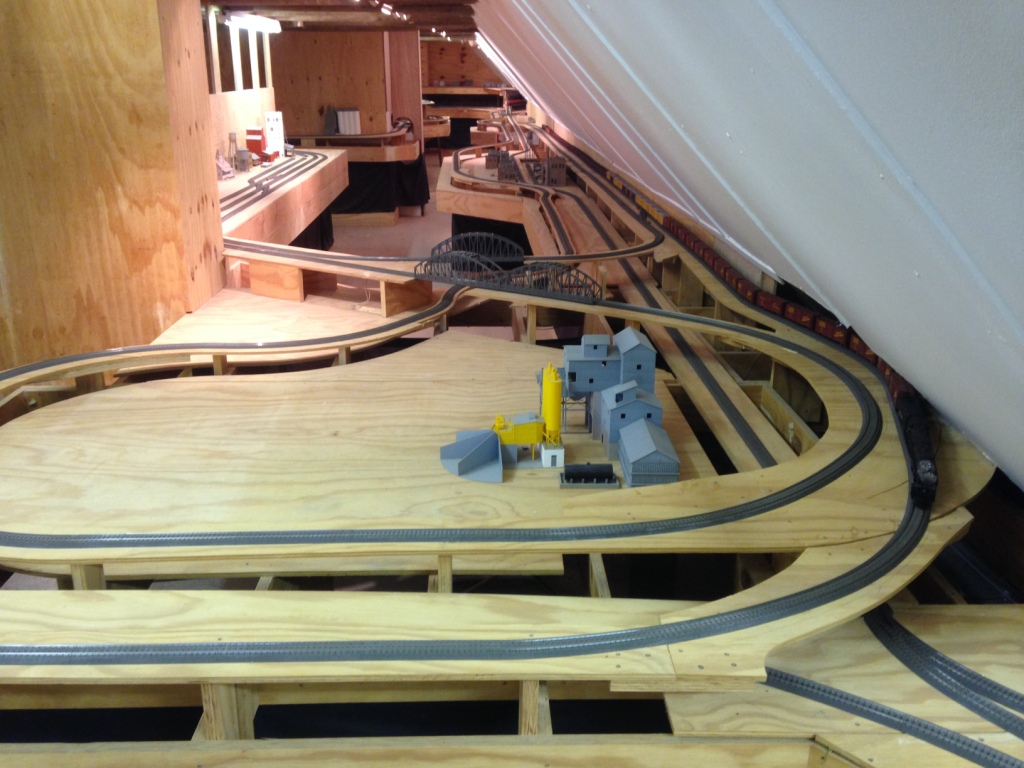

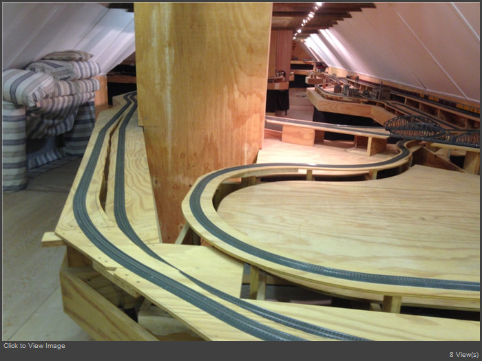

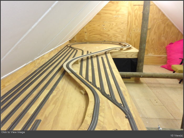

I am adding some pictures from the layout build to give you an idea on what we are doing.
The length of the layout from one reverse loop to the other reverse loop is about 100 metres long.
The layout winds around the attic of the house, through twists and turns, over bridges and around corners.
The station platforms as depicted in the diagram will be long enough for train lengths of 3.5 metres each.
We are building a staging yard for 8 trains of 3.5 metres each (the staging yard in the picture has been modified since the picture was taken)
There is a separate line for Bigboy, because Bigboy hauls about 80 wagons and the train length is about 30 metres long, and there are no crossings between Bigboy line and other mainline, for obvious reasons !
I am planning on running 4 trains easily on the mainline, with 8 trains rotating in the staging yard.
Bigboy will run on his own line.
