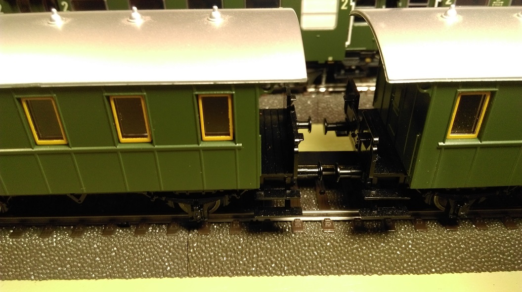

After having some issues with Marklin couplings being a real pain and also having some ROCO rolling stock I took the overall forum guidance and decided to go with ROCO universal couplers everywhere I could.
I then found out that Marklin startup rolling stock doesn't have NEM pockets to make the coupling changeover easy/possible. (Those Marklin starter sets - I've got some questions and I'll go there later).
It seems this is a very old topic but I went around and around in many circles on the web and in forums - the end result was that you're in Australia and in a world COVID crisis - there's no hope of a solution arriving any time soon unless you make one.

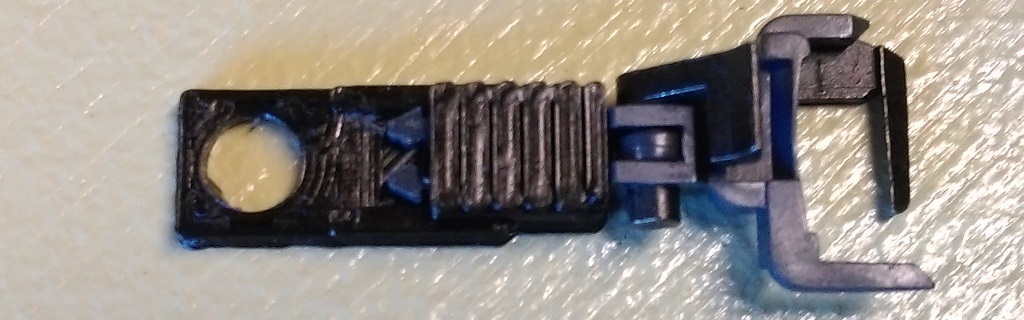

So I've made a 3D printed NEM shaft for some startup rolling stock to allow a ROCO universal coupler to be fitted to those carriages. These are prototypes, they're up and going but certainly could use refinement. I'm a novice at both 3D printing and Marklin so there is absolutely no limit to how wrong these can be. Also, if I knew what I was doing with 3D printing then the end result could be whole lot prettier.
So, here's some pictures with links to the 3D printer files to follow ...
Tech Notes - PLA 200/60 degrees, the mounting hole may need drilling out if your 3D printer isn't precise - 2.4 mm or 3/32 drill. 4 wheel rolling stock can use the basic adapter but bogie style startup rolling stock need the bogie version - the mounting post on the 4 wheel rolling stock is a 2 mm fit but bogies are a 2.15 mm fit according to the dozen or so startup bits I have on hand.
EDIT - 3D objects should now be available online via the drawing package I use called TinkerCAD, object names are Marklin Startup NEM and Marklin Startup NEM Bogie. What could be improved is the exact size and taper of the circular mounting hole and the spring loaded centering effect of the "whiskers".

A little fine tuning after making a few. Very small adjustments to the round mounting hole and spring "whiskers". Some slots were added to the NEM socket to force the slicer software to patch across the hole during printing in a neater fashion. The slots are too thin to print correctly but it fools the slicer well enough. Also changed the 3D object to print 4 couplers at a time. Remember to finish drill the mounting hole to 2.4mm. Updated STL files hopefully attached.
Marklin Startup NEM Bogie v2.zip (30kb) downloaded 29 time(s). Marklin Startup NEM v2.zip (31kb) downloaded 26 time(s).NEM Design 2.jpg
Having done all the start up stuff that left 4 dodgy Primex coaches to do. They have been joined into a permanent consist linked by 0.8 mm brass strip painted black and sized so that buffers just touch on R1 curves. Then NEM sockets were produced for the outer ends of the consist. Hole to be finish drilled to 4mm. The support bar needs to be cut from the coach. When fitting the new coupling tighten the screw to remove as much slack as possible without stopping the new coupling moving from side to side freely.
