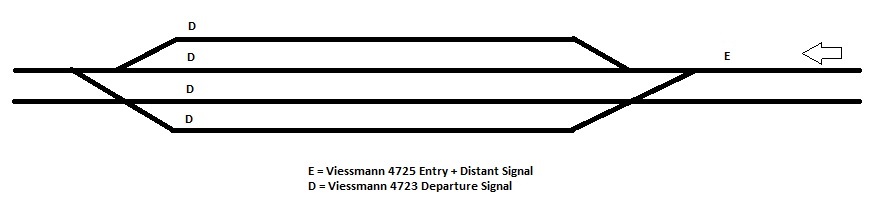

I'm trying to confirm my understanding of Viessmann signals and decoders prior to placing an order. Hoping someone who has set them up in the past can help clarify.
If I have a 4725 Entry signal (Main + Distant signal on the same mast) and 4723 Departure signals in my station sidings such as in the following (ignoring eastbound traffic)...
First, if I understand correctly from the manual, I would need one 5229 Multiplexer decoder for the 4725 (controls both the main and distant signal) and then two 52292 Multiplexers to control the four 4723 departure signals. Is this correct?
Second, and I should point out that I'm using Traincontroller software, when a train is entering from the right as in the above image, I'm trying to understand how TC will set the distant signal aspect on the Entry signal mast correctly depending on which of the four sidings the train is heading for and whether it will be stopping or passing through the station. Will the distant signal connected to the 5229 have it's own address that TC can send instructions to? Or do I actually need a 52292 to control the main and distant signals on the 4725?
Thanks in advance!

In reading (and re-reading) further, I think I've figured out the answer to my question. Viessmann 5229 Multiplexer is intended for a Hp/Main signal and it's preceeding Vr/distant signal which will automatically show the aspect based on the connected Hp signal.
When a distant signal is on the same mast (e.g for a 4725 entry signal), the distant signal needs to be connected to the following main signal's 5229 Vr port.
In my scenario where I'm using train control software and there are multiple main signals down the line, I think I need to connect every single main/Hp and distant/Vr signal to 52292 double Multiplexers so that they all have a unique address and my software can control the aspects of all of them.
Would greatly appreciate if there's anyone who can confirm this makes sense.

I have TrainController Gold and solved a similar problem by defining a dummy signal (with a proper address but not existing). The distant signal refers to this non existing signal. In condition for the dummy signal I specified the different aspects according to the turnout and the signal the turnout is currently pointing at. I my case only one turnout but this principle should work for you as well.

Not that I think you need it but I will give a more detailed description anyway.
I will call the first turnout after signal “E” “T1”. The next “T2” and the double slip “X3”. The top distant departure signal “D1” and those below “D2”, “D3” and “D4”.
First a non existing signal “N1” is registered to the controller and introduced to TrainController. N1 is then set as the only distant signal at E. Finally the aspects of N1 is set thru “Condition” in TC (not available in Bronze version I think).
Green aspect
if T1 straight and T2 thrown and D1 green
or T1 straight and T2 straight and D2 green
or T1 thrown and X3 thrown and D3 green
or T1 thrown and X3 straight and D4 green
Yellow aspect
if T1 straight and T2 thrown and D1 yellow
or T1 straight and T2 straight and D2 yellow
or T1 thrown and X3 thrown and D3 yellow
or T1 thrown and X3 straight and D4 yellow
Red aspect
if T1 straight and T2 thrown and D1 red
or T1 straight and T2 straight and D2 red
or T1 thrown and X3 thrown and D3 red
or T1 thrown and X3 straight and D4 red

Thanks blid for the explanation. Makes a lot of sense. Only thing is that my diagram above was just a simple sample to explain my scenario. In reality I have 7 sidings in my main station, 6 turnouts and 4 double-slips between the entry signal and each of the 7 departure signals. That works out to a lot of possible permutations :)
I'll have to get around to testing if TC "Runs" have the logic to set the distant signal properly based on the destination block and signal in the "Run". If not, I'll test out your dummy signal with conditions method as well.

Hello Roland,
I've used such similar configuration with same signals.
Most of what you have to know has been written in post #13 and #19.
A 4725 will use 4 consecutive addresses (2 for the main and 2 for the advanced), and a 4723 will use only 2 consecutive addresses. You can plug each signal either in a 5229 or a 52292. However the advanced plug of the 5229 is of no use in this case, because of the complexity of possible routes.
The logic will be managed by the software, as it is too complex depending on the 4 possible routes a train can take after the entry signal.
This is what I call "dynamically managed advanced signal".
As an example, you can look there: https://www.marklin-user...-managed-advanced-signal
It is a study I did a long time ago, and it is specific to Rocrail. You'll have to find out the equivalent concepts in TC, but I'm sure it is feasible.
Good luck.
Fabrice
Offline Roland
#23 Posted : 28 July 2021 18:34:47(UTC)
Roland
Joined: 09/11/2013(UTC)
Posts: 341
Location: Toronto, Canada
Hello Roland,
Good luck.
Fabrice
Hi Fabrice, thank you for the very informative post and link! TrainController does have the ability to reserve / look ahead 2 blocks (or even more) so I should be all good there.
From your linked thread...
A Viessmann 4725 signal (3 aspects main signal & 3 aspects advanced signal on same mast) for the entry signal + a Viessmann 5229 decoder. The main signal and advanced signal have separated addresses.
Can you confirm this means the 5229 is able to assign a separate address to the attached Vr/advanced signal? I got the impression that was not possible. The 52292 decoder can do this.
Thanks!
Roland
Märklin H0 for sale
My Layout Build | Märklin CS3+ | K-track | Merkur | Viessmann | LDT | iTrain | Rolling Stock: Märklin, Roco, Piko, ESU/Pullman | Modeling primarily DB/DB AG EpIV-VI
Offline French_Fabrice
#24 Posted : 28 July 2021 19:09:16(UTC)
French_Fabrice
Joined: 16/05/2011(UTC)
Posts: 1,491
Location: Lyon, France
Hello Roland,
As far as I remember, yes it is possible.
All my 5229 have the DIP switch 1 to ON, and all others to OFF.
For example, the entry signal 4725 on Trossingen III layout has DCC addresses 417 and 418 for main and 419 and 420 for advanced on same mast.
As there is only one plug coming out from the signal, the signal plug (female) is connected to the Hp socket (male) of the 5229 decoder. The Vr socket is not used.
I don't remember exactly how I programmed it, and more precisely if I hit only address 417 and it was done, or if I hit address 417 for main, then address 419 for advanced. I did it many years ago... sorry.
But there is no doubt 4 addresses are used for the whole main+advanced.
Fabrice
Offline Roland
#25 Posted : 28 July 2021 19:57:36(UTC)
Roland
Posts: 341
This is really good to know (and something I wouldnt' have found out until actually buying my signals). I mistakenly had the impression the on mast Vr signal would have plugged into the Vr port.
Many thanks again. Just had a quick look in the 5229 manual and it seems you configure the first address while the other 3 are automatically the successive 3 addresses if the signal in the Hp port requires 4 addresses.
