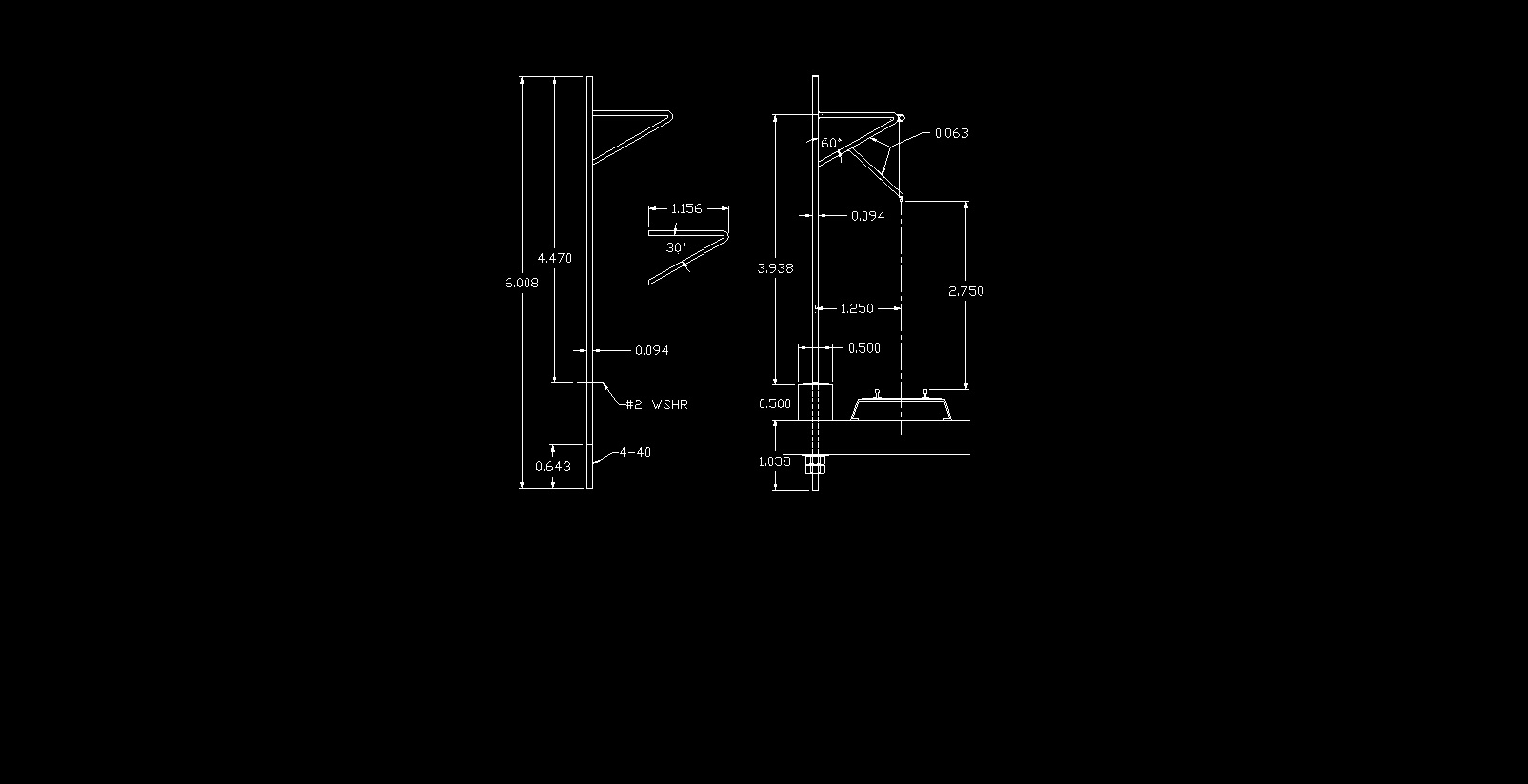

The following sketch is for my catenary system. Everything is brass except for the rail which is code 70 rail. The catenary wire is made of 1/16" brass rod with a 1/16"ID brass tube on each end and a rail joiner on each end of the code 70 rail. Following the dimensions on the sketch will give you a 2-3/4" distance between the pantograph and the catenary wire. Dimensions may vary as long as you maintain the 2-3/4". All the pieces are soldered together using a resistance soldering transformer (not a regular soldering iron) That is so soldering a connection won't "un solder" previous connections.

I used code 70 rail, 1/16", 3/32" brass rod and code 70 rail joiners and 1/13" ID brass tubing. The material cost is a lot less than buying ready made poles and catenary wires. All told, I think I came in at around $35. I should be able to get 20 poles and enough cat wire to cover about 24 feet. BTW, I used the code 70 rail upside down so the pantograph makes contact with the rail head. With the rail joiner, a nice smooth contact is made. I'm not sure if I will solder the joiners. I will see how continuity is; same with the tubing. I still have to design and make some structure for spanning 2,3 and 4 tracks.

I have made one 14" length of catenary and it turned out so-so. I need to make a jig to hold everything in alignment while I solder it. Jigs are absolutely essential for repetitive work. Time spent making a good jig is time well spent.
I'm having health problems (my wife's), so I can't devote as much time as I would like. Traditionally, I work slow as I am not in any hurry. I find the thinking, planning and actual making is satisfying, but I will try to post some pictures after I figure out how to post them. I went from an XP computer to a windows 10 and am still trying to figure it out.
