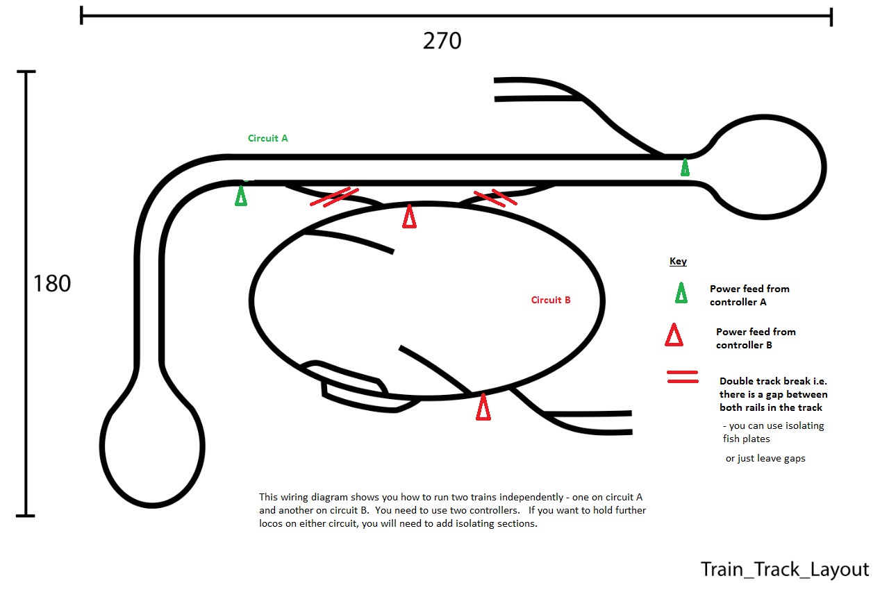

I have quickly annotated your diagram to show you how to wire it to get two locos running:
Carim
This is awesome!!! Can't thank you enough for your help 😯
Carim
Carim has provided a good suggestion! I've two additional suggestions. First, I would add more feeders on each loop! This will assure better running with less chance of voltage drop caused by poor track joiner connections. Second, I would isolate the feeder sections into blocks at the track with 8588 isolating track sections or 8954 insulating track joiners. You can jumper feeds to each block initially. This will help prepare you for block control (and more trains!) in the future. Ideally, you would incorporate contact track sections in your planning now too.

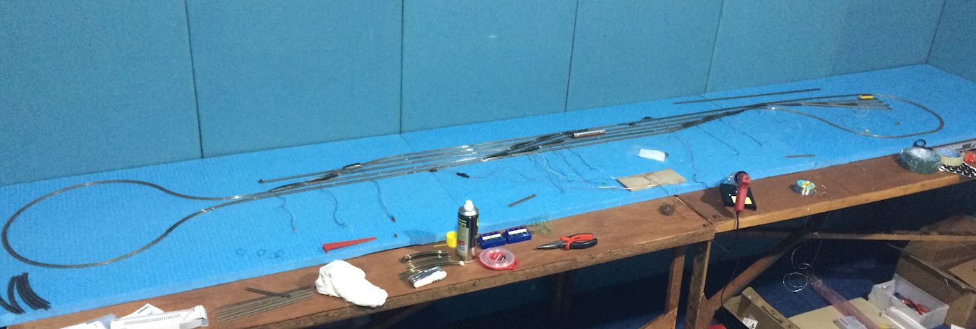

Hi all!
So after considering your inputs, I have decided not to pursue my original layout idea for now. But that didn't stop me from going for another giant layout 😅
By combining my old and new tracks, I followed a layout from Märklin and this is what I got.
I use 2 feeder tracks for the layout, around 1m apart, and will try it out soon to see if that is enough to power the layout. My guess is, I will need 1 more feeder track for this 🤔
Anyways, this is how it came to be, track plan result
