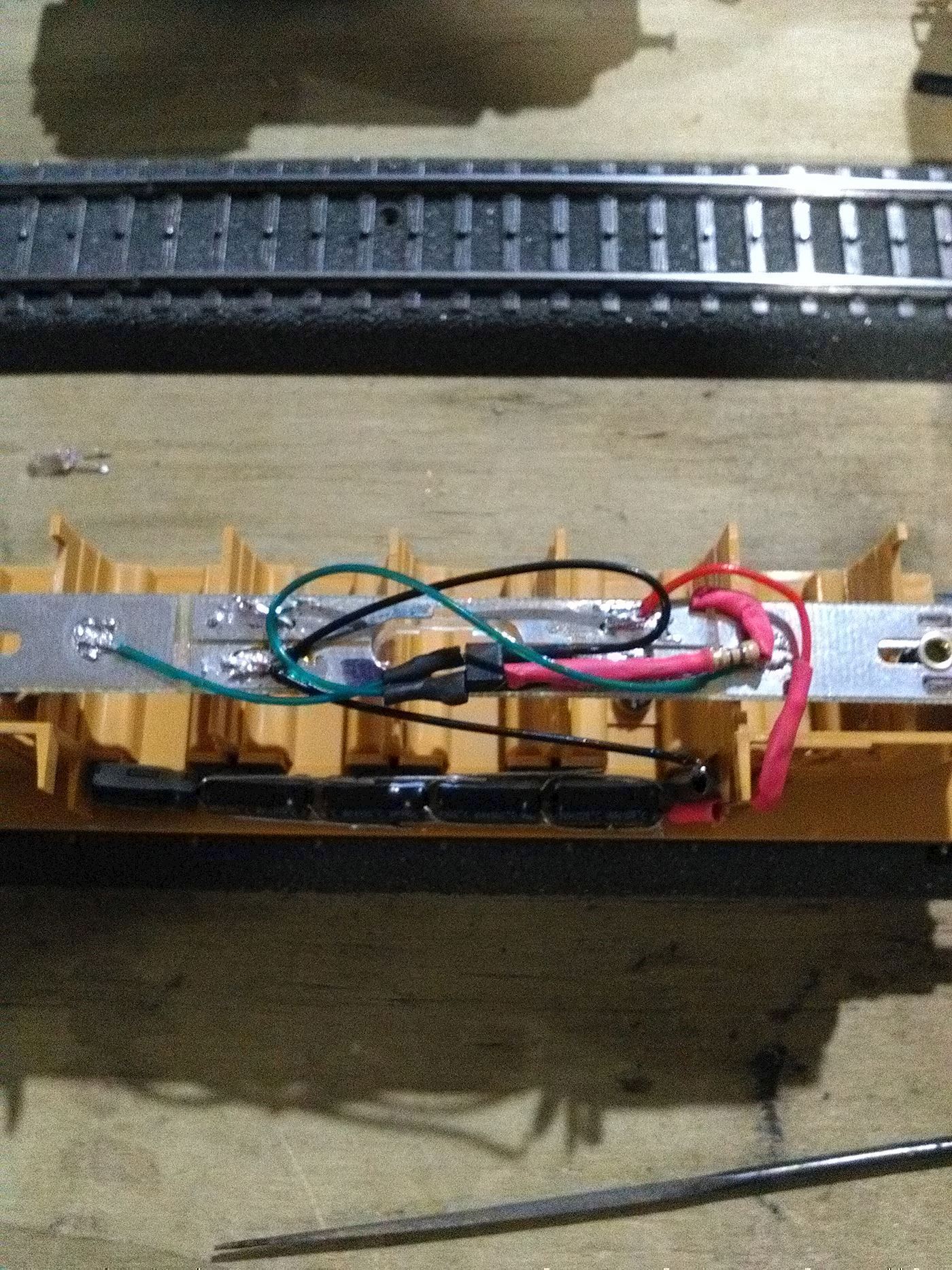

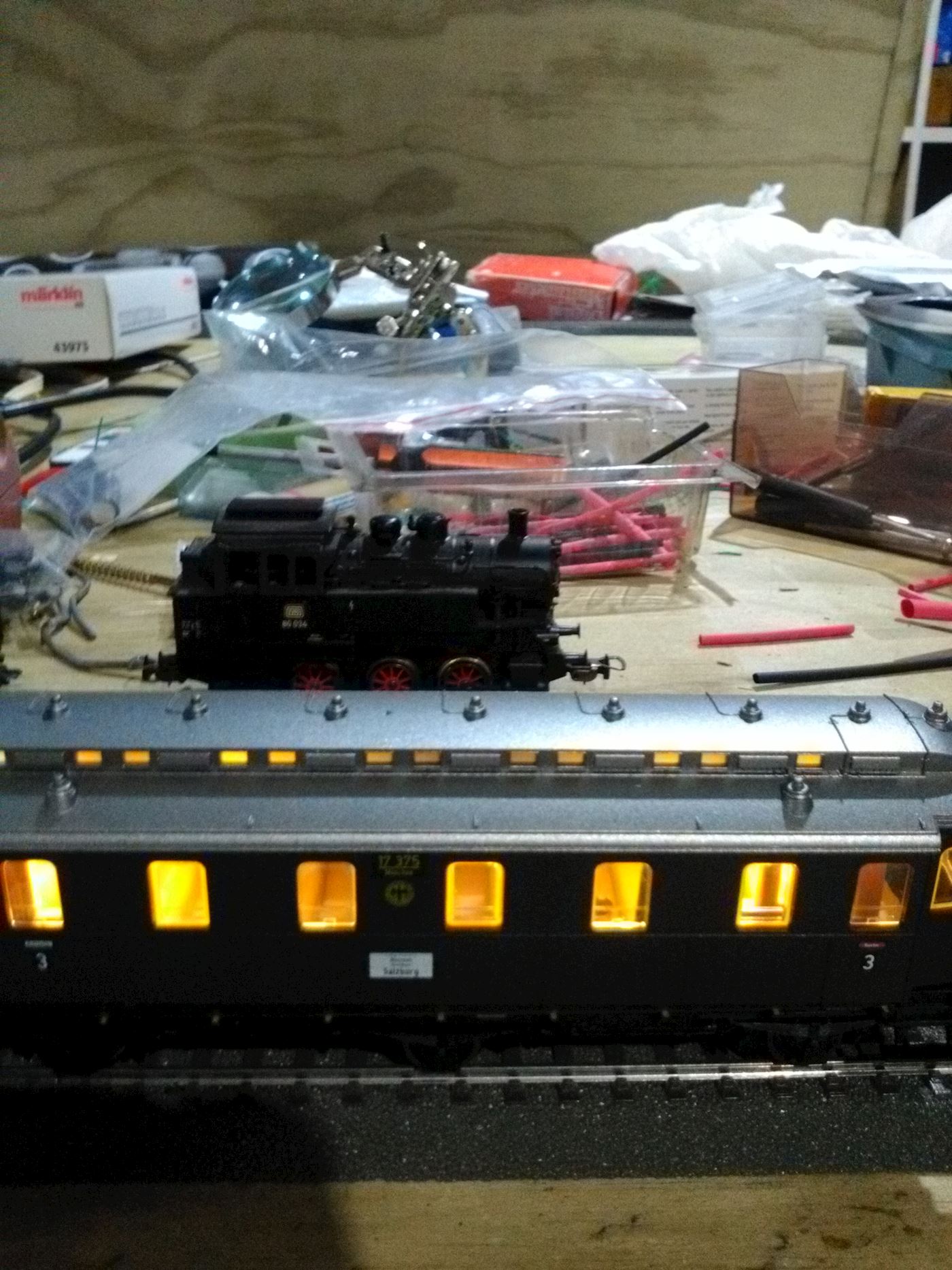

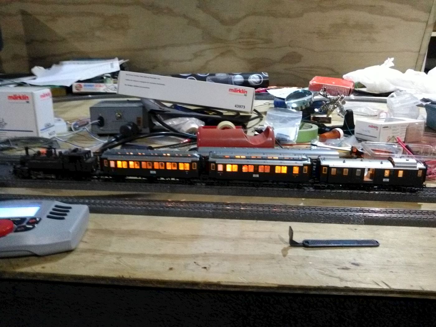

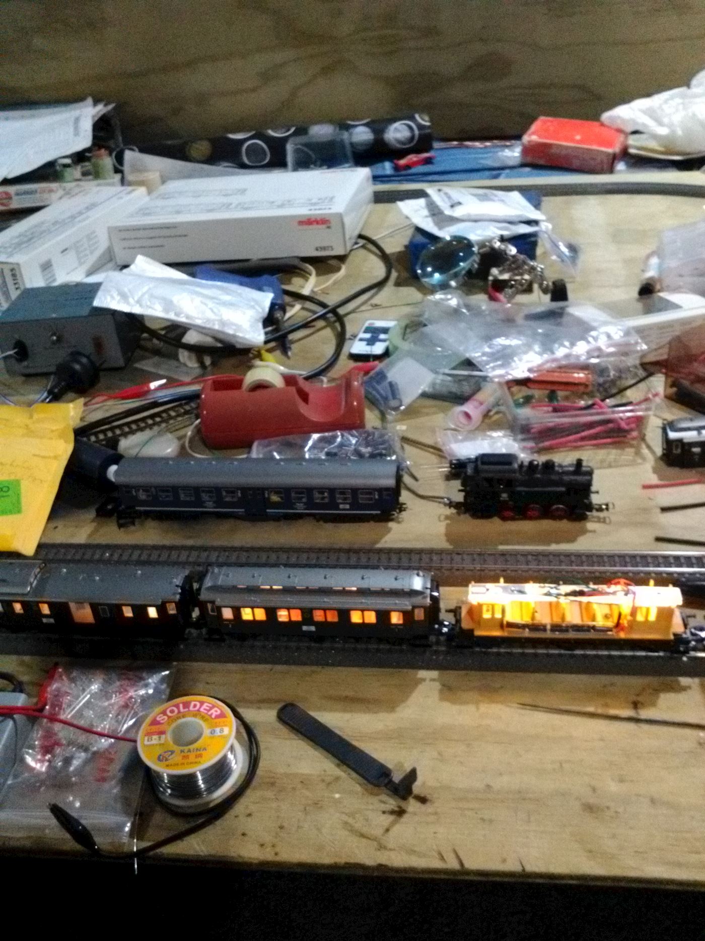

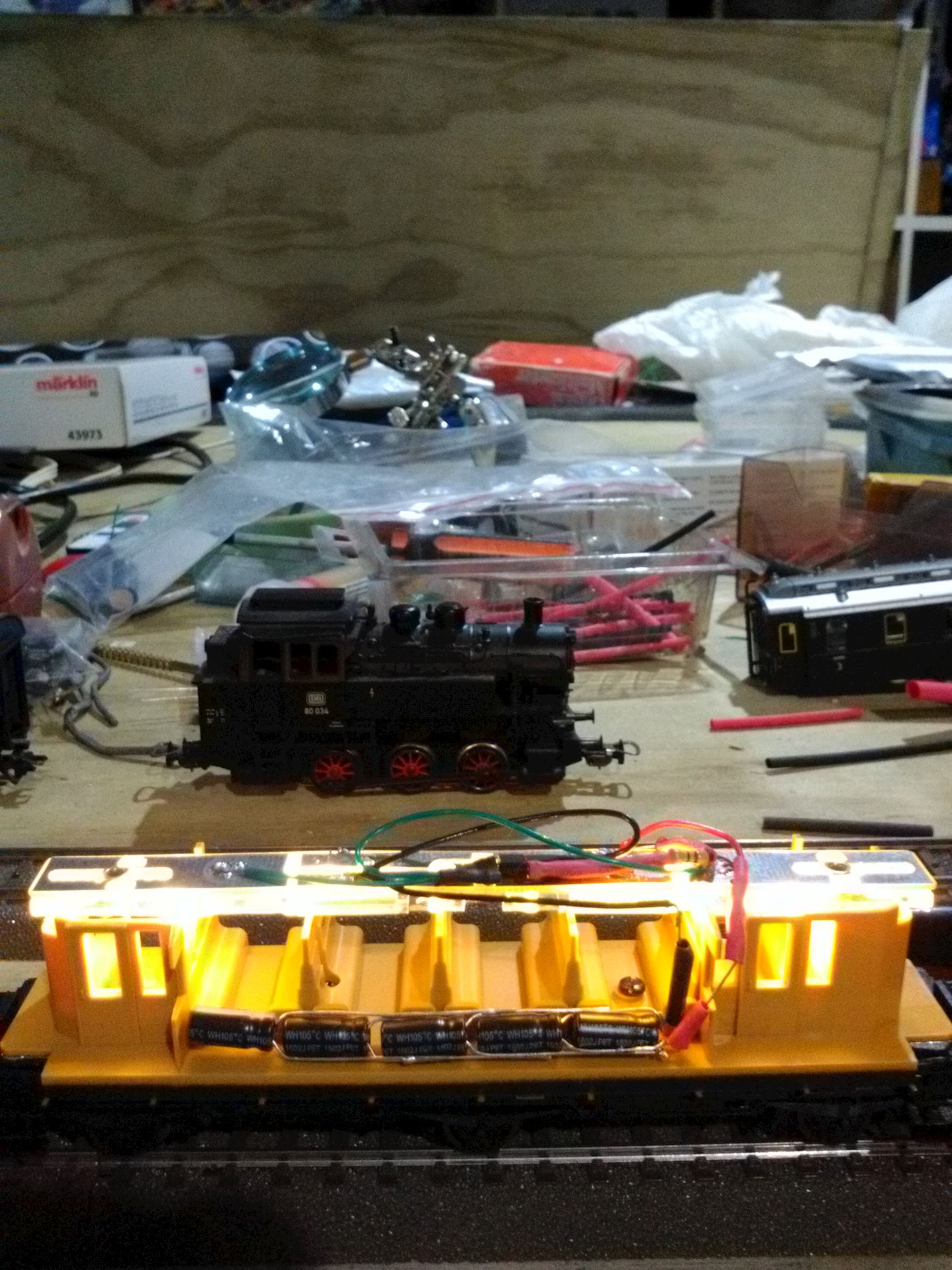

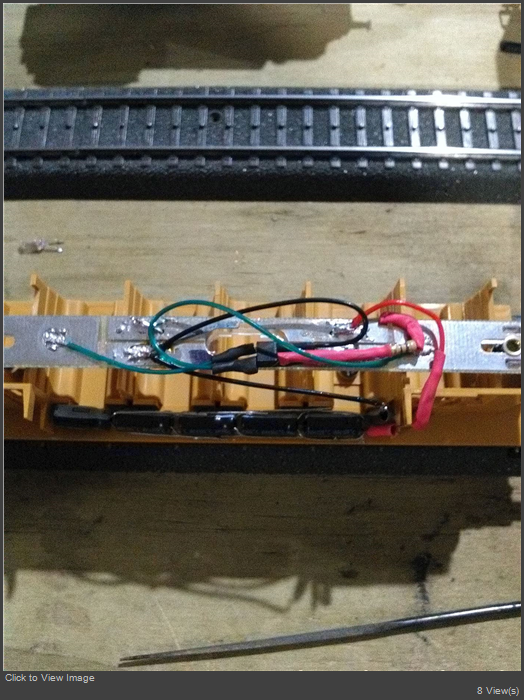

All done. I fitted 2 x 2 mm tower LED's I had plenty off. Powered through a micro bridge rectifier and 1 resister. And in parallel with the +ve and -ve I have placed 5 x 10 uf, 50 v capacitors [ lying along the corridor so they cant be seen ]to help prevent flickering.
I usually find I have to use 2 x 1000 uf capacitors to eliminate flickering so in this case, not enough to do the job.
They are a wee bit brighter than the originals and because they are facing tot he ends of the coach, don't light up the middle ans much just like the original bulbs. They don't heat up either which was the reason for this exercise.
The little rectangular black object is the Bridge rectifier. It can drive a 6 coach train with 6-9 LED's in each coach. Now days I fit one in each coach. It has been done because I am able to run them on digital or analogue. All components I use are able to withstand 50 v which is because the rectified output of my most powerful blue transformer puts out 38 v DC
It looks possible to add another LED over that hole on the middle of the the pcb. Maybe.
LED conversion next to std coach
Close up of led conversion
Led conversion with body sitting in place
Northland. NZ
