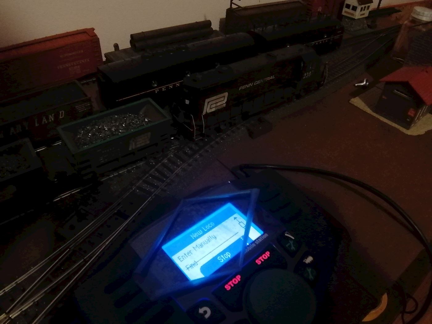

Hello every one.
I´m new around here and i don´t have to much experience with the MS2 66955.
I bought an "used but new" (it still have the creen plastic cover) MS2 on ebay, and came to me a few days ago (it took over a months from Spain to Chile).
when i turn it on, the stop button appears locked and i cannot turn it of, also some of the functions are disabble (with a crossing line over the words).
I already reset the MS2 to factory settings twice, but nothing happens. What can i do? i don´t have the CS for updates.
I spoke with the Ebay store but they are telling me to send it to tech support in Märklin Germany (MS2 is still under warranty) but that will cost me a lot of money.
So, is there anything that i can do or i have to send it?
Thanks!

first of all you should isolate a section of track and attach only the trix 66955.
Then he carries out tests with a loco mfx

One MS2 can update the other MS2. Please check which versions you have. Then try to invoke "Update MS2" on the MS2 with the newer version to update the other device.
Which versions do they have now?
Maybe your Märklin MS2 has a rather old version and they cannot co-operate. Having the same version on both devices should resolve that.
You can also update the trackbox.
Does the Trix MS2 work fine with only it connected to the trackbox?

First thing to do would be to take a two or three track section and connect only the new device
Power it up and place a MFX, DCC or MM loco on the track
See if it is still locked on "stop"
My guess is there may be some incompatibility that the newer unit is detecting as not compatible or as a short and it then goes into stop mode.
If it continues to be stuck in "stop" menu, you have two options:
1) File a claim with eBay/seller for damaged goods and return to sender
2) Send unit to Maerklin for service (at your cost)
If you just received the item and it did not work from first attempt, my recommendation would be 1.
#6 Posted : 12 April 2021 20:41:20(UTC)
