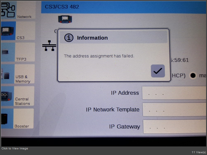

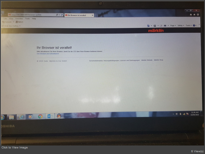

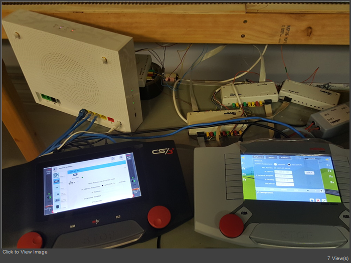

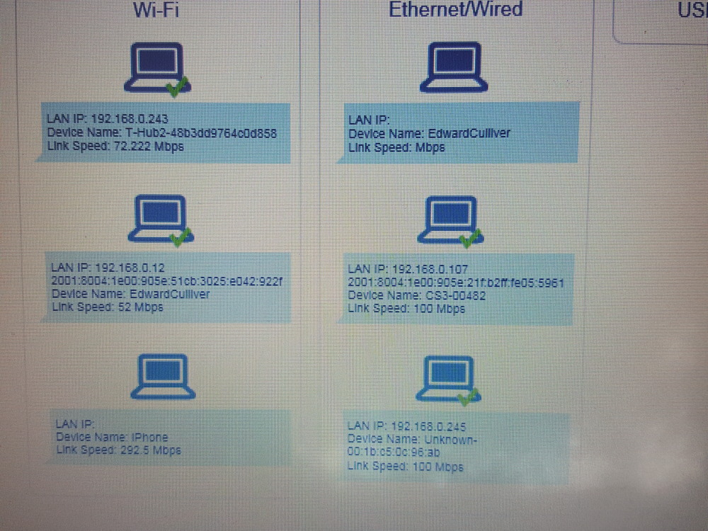

Hello everyone,
20210403_094050rs.jpg20210403_094315rs.jpg20210403_094722rs.jpg20210403_100231rs.jpg20210403_101059rs.jpg
I have tried to connect my PC to the CS3 using the VCN.
My CS3 does not automatically find IP, but I found it in the information area and typed it in while in'manual' IP mode.
I get 192.168.78 .21 for the CS3 IP address. I don't know what the DNS server number is for.
In VCN I have entered the IP with the suggested :5900, and then hit enter. The VCN looks for a while and states that the address is valid but no requested data is returned.

Offline George Culliver
#36 Posted : 08 April 2021 02:42:57(UTC)
George Culliver
Joined: 29/03/2021(UTC)
Posts: 21
Location: Western Australia, Perth
Hello PeFu, and others helping me.
PeFu, I like your turn of phrase, however in my own defense, I didn't invent that IP, it was in the CS3 info.
Well, I have a disused internet router, and I have hooked it up.
In the last few days, I had a few troubles....... I had a catastrophic crash and several freight wagon hit the deck (ouch!) , and my first attempt with the VNC caused a freeze of my computer. I had to do several 'restore' operations just to get google chrome to work again. On top of this, I had a knee replacement surgery (left) 2 months ago and I still have problems to get up to the attic.Cursing
So, here are some photos:-
IP addresses suddenly appear in both the CS3 and the CS2, but they are 'grey'. If I switch the CS3 to manual, the IP goes 'black'.
I have tried to make contact with my computer using the VNC, but with the same result...... valid address but no data transferred. I tried with and without the :5900
I will try deleting VNC from my computer and then re-installing. I am not sure if I have to LOGIN to VCN but have done so anyway. I hope I can get it sorted soon as I get my right knee replaced in 2 weeks ......Crying the pain is unbelievable!!!
Ed (George)
#38 Posted : 10 April 2021 02:04:57(UTC)
George Culliver
Posts: 21
Hello Phil, thank you for helping me...... appreciated.
I have tried again with the new router connected with the 3 devices, CS3, CS2 and my PC....... but not connected to the internet.
I turn on the CS2 first, and then the CS3.... wait to prove startup is OK by checking one of the feedback controls and watching the result.
I have the PC there and open Google Chrome. The CS3 has IP addresses, which I assume are issued by the router.20210409_111522rs.jpg
I have then typed this IP into the search line of the PC browser and hit ENTER.
But the browser ONLY searches for the internet (which I am not connected to), and does not look for the LAN of the 2 Marklin controllers. Where does the Marklin page come from to switch the bildschim server?? Does it get it from the CS3?
So I still don't know why I cannot see the CS3 through the LAN20210405_085611rs.jpg
I tried to find out how to switch the Chrome search to LAN but found no information. I also tried CAT5 and wifi connection between router and PC.Cursing

Offline PeFu
#41 Posted : 13 April 2021 06:57:59(UTC)
PeFu
Joined: 30/08/2002(UTC)
Posts: 1,306
But for me, it seems like both the PC and CS3 are connected to the router. As you have selected Auto DHCP in the CS3, the router provides the IP for the CS3, and you should not be able to edit the IP in the CS3.
Would it be possible for you to log on to the router, by adding 192.168.0.1 in a PC browser? (You will probably need an Admin account and password) There, it should be possible to check which devices that are connected. Is the CS3 connected?
Smile
#43 Posted : 13 April 2021 11:24:38(UTC)
George Culliver
Posts: 21
Hello PeFu,
Thanks. I have logged into the router as you recommended, and can prove that the PC and the CS3+ are connected to the router.
I have tried both windows explorer and google chrome to look for the IP address 192.168.0 .107 (the IP of CS3+) but in both cases the browsers ONLY want to look at the internet which I am not connected to.
I don't know how to ONLY look at the LAN consisting of my PC and the CS3+. So I still cannot get the Marklin page up on my PC.
What should I try next?
Ed (George)

I am not 100% sure how I finally manged it, but EVERYTHING is working now.BigGrin BigGrin BigGrin BigGrin
Somehow on the 400th attempt I got through the router to the CS3.... firstly using windows explorer and the Marklin page appeared to say the browser was 'out of date'. So I immediately attempt to contact through Chrome and the Marklin webpage match that I have seen on utoob. It was in German and could not translate because internet was not available, but I have a little German and found the Bildshrim page you all suggested. Then fiddled around a while and got the CS3+ screen.
So then I started the CS2 which booted OK. I already knew that the CS3+ won't work correctly if started first, so I rebooted it. Checking the feedback contacts, I proved the 2 controllers operated correctly and then found the CS3+ screen on my PC. Checking various functions in 'solenoids and in track circuit layout...... everything worked on the PC too. I then just checked of the PC could also mirror on a larger monitor screen and yes all OK. My intention is to send the PC screen to a very large scrren I will mount high above the layout and use my little remote mouse to operate the PC.
20210414_113639rs.jpg20210414_115419rs.jpg20210414_115620rs.jpg20210414_115634rs.jpg20210414_115716rs.jpg20210414_115811rs.jpg20210414_115845rs.jpg
Please excuse the mess all over the layout..... I am currently making a module of wall, rock and grass etc along behind the 'city area'... hence the stone wall mouldings. Eventually the 'mountain' will be about 1200 high in the middle of two areas each side of the bridges.
Thank you again to everyone. I am such an ignorant person in IT matters.LOL
