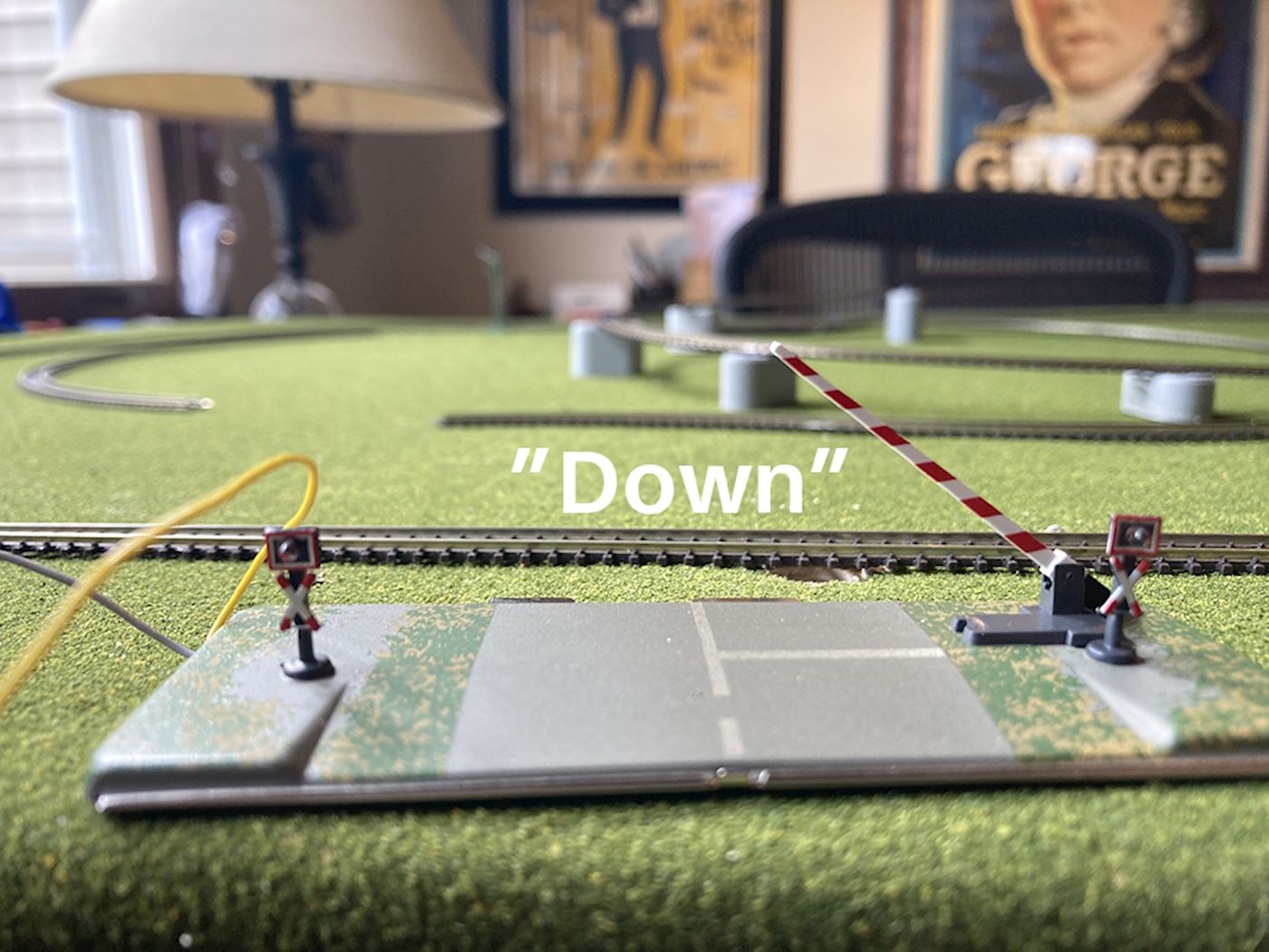

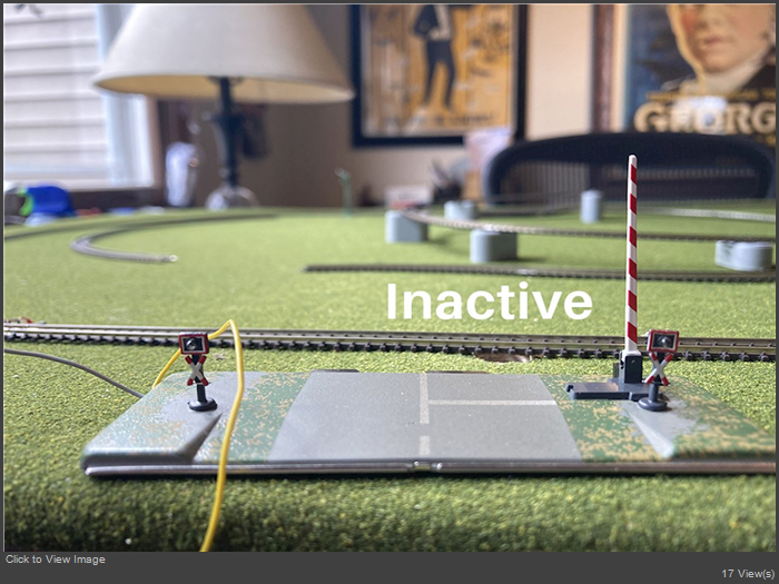

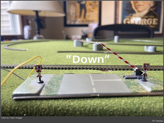

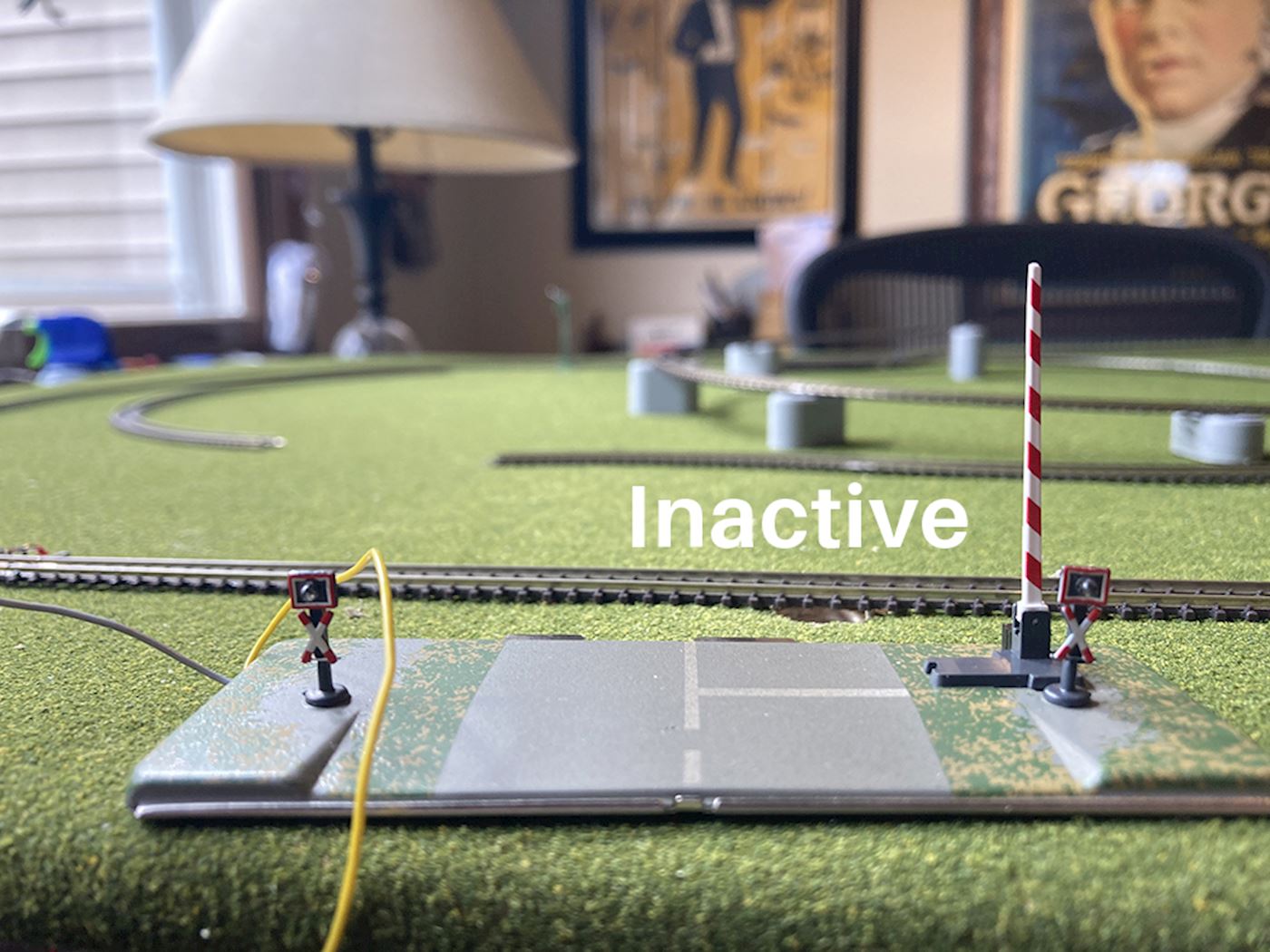

Hi. I'm brand new to the hobby, and just bought and connected a brand-new grade crossing set (8992). The gates activate when the train passes the circuit tracks (yay), but they only go halfway down (boo), and hold there until the second circuit track is crossed, at which point they pop back up (yay). Has anyone else experienced this behavior? My set is analogue, and I'm using the big old blue transformer (6727). Thanks!

These gates are brand new. The clips are properly seated, and the upward and downward movements are smooth. The problem is that when descending, they stop partway down. Here's a video.
Both gates exhibit this exact same behavior.
I think they may have been incorrectly calibrated at the factory. They have a full range of motion.
eric
