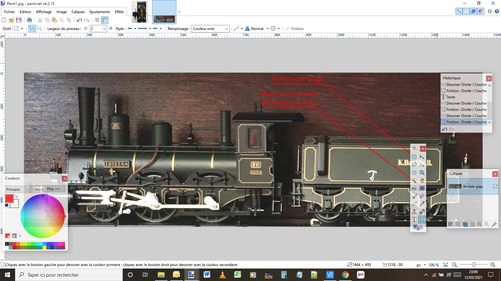

There is a simple way to process loco pictures (side view) and transform them into icons.
I suggest to use a freeware called paint.net and a photo of the loco wuth a solid colour back ground
You frame the picture to contain only the loco itself (top left symbol) then CTRL/c to copy the image inside the frame
Then CTRL/n to start a new empty picture and CTRL/v to copy the loco image
The Magic wand allows to select the background and erase it
Then image / resize allows to create a suitable icon (height to 32 to 49 for a CS2 and 100 for a CS3
Note: when uploading a picture from your PC, your web browser and the IP address of your CS3, before the transfer to be finalized you may down size the picture so that no CS3 memory is wasted. You may store your pictures on a SD memory card (32GB) plugged into the CS3

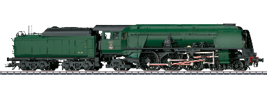

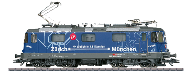

Here are two examples where the CS3 has done the cropping and downsizing. the images are downloaded from the CS3 to the pc again. (background made transparent in Paint.net in under 10 seconds) The 39480 file was originally 1500x1069 and 769KB, when transferred, and the CS3 reduced it to 384x143 and 60KB
