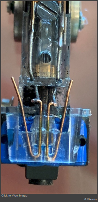

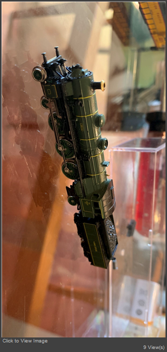

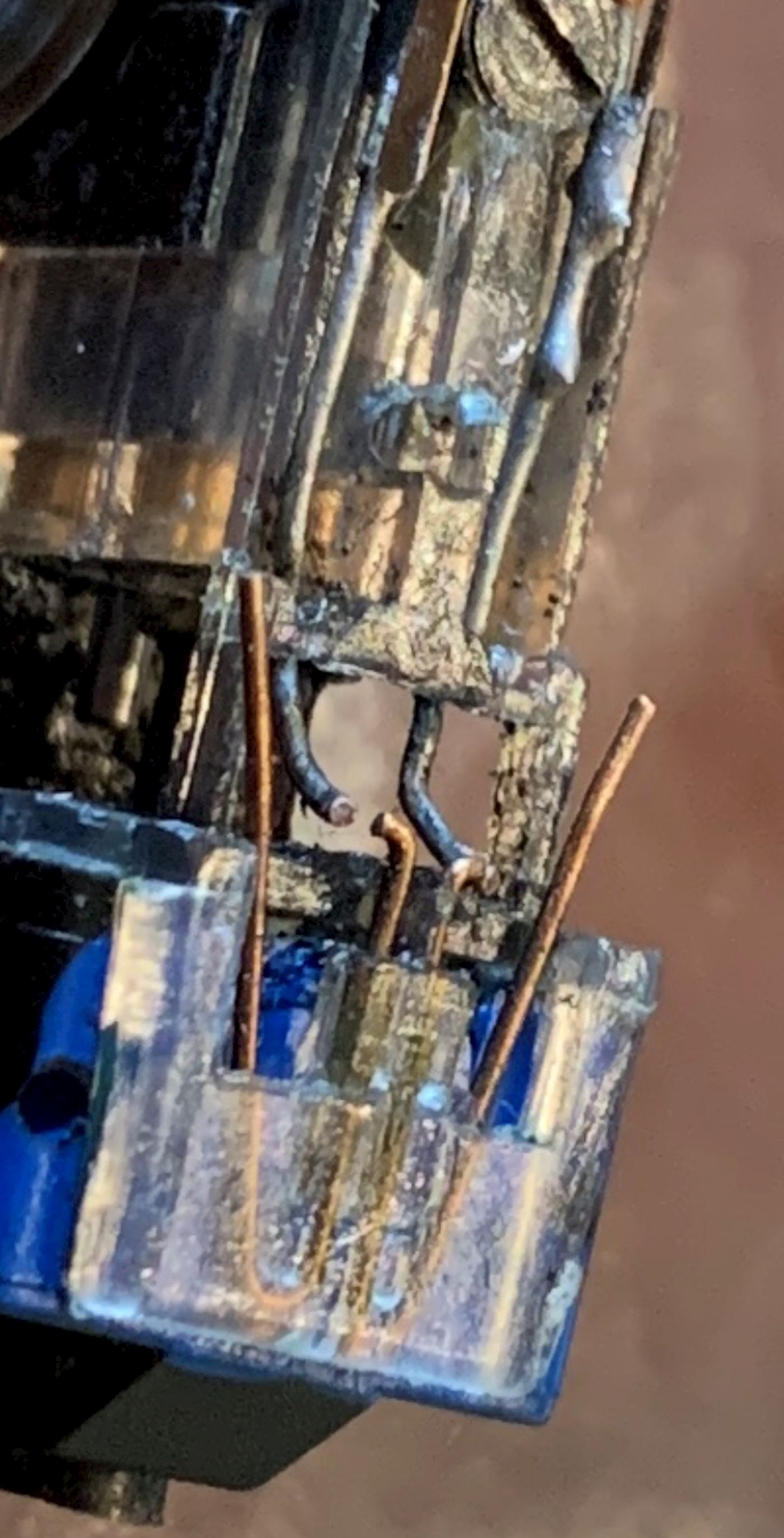

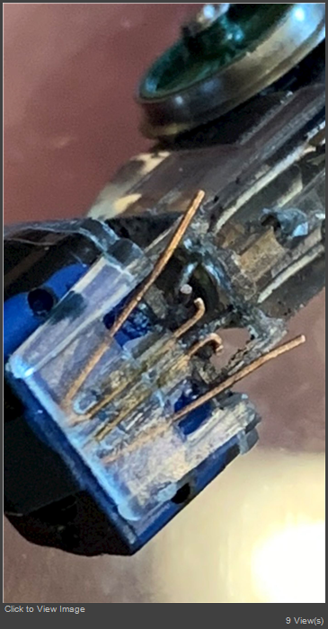

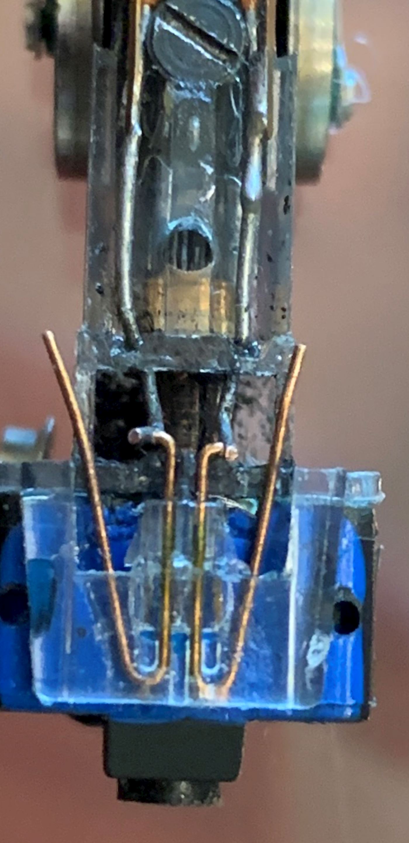

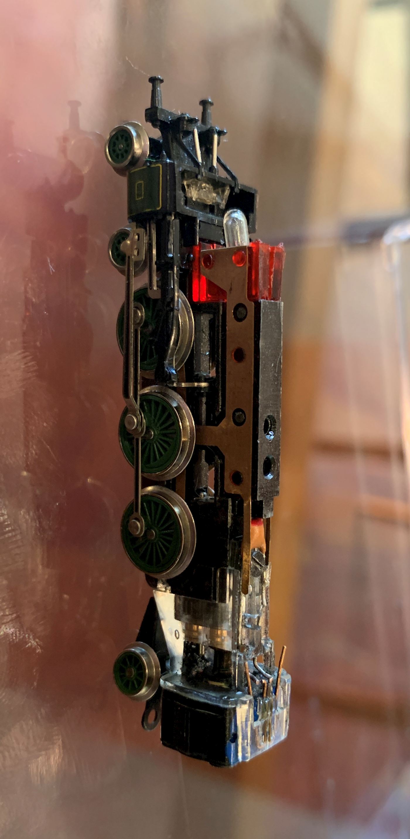

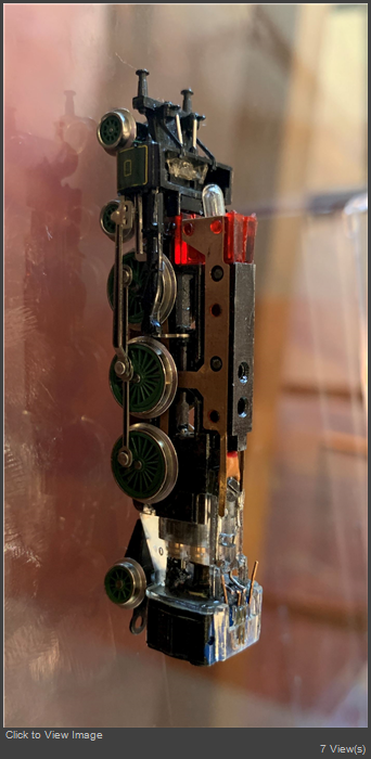

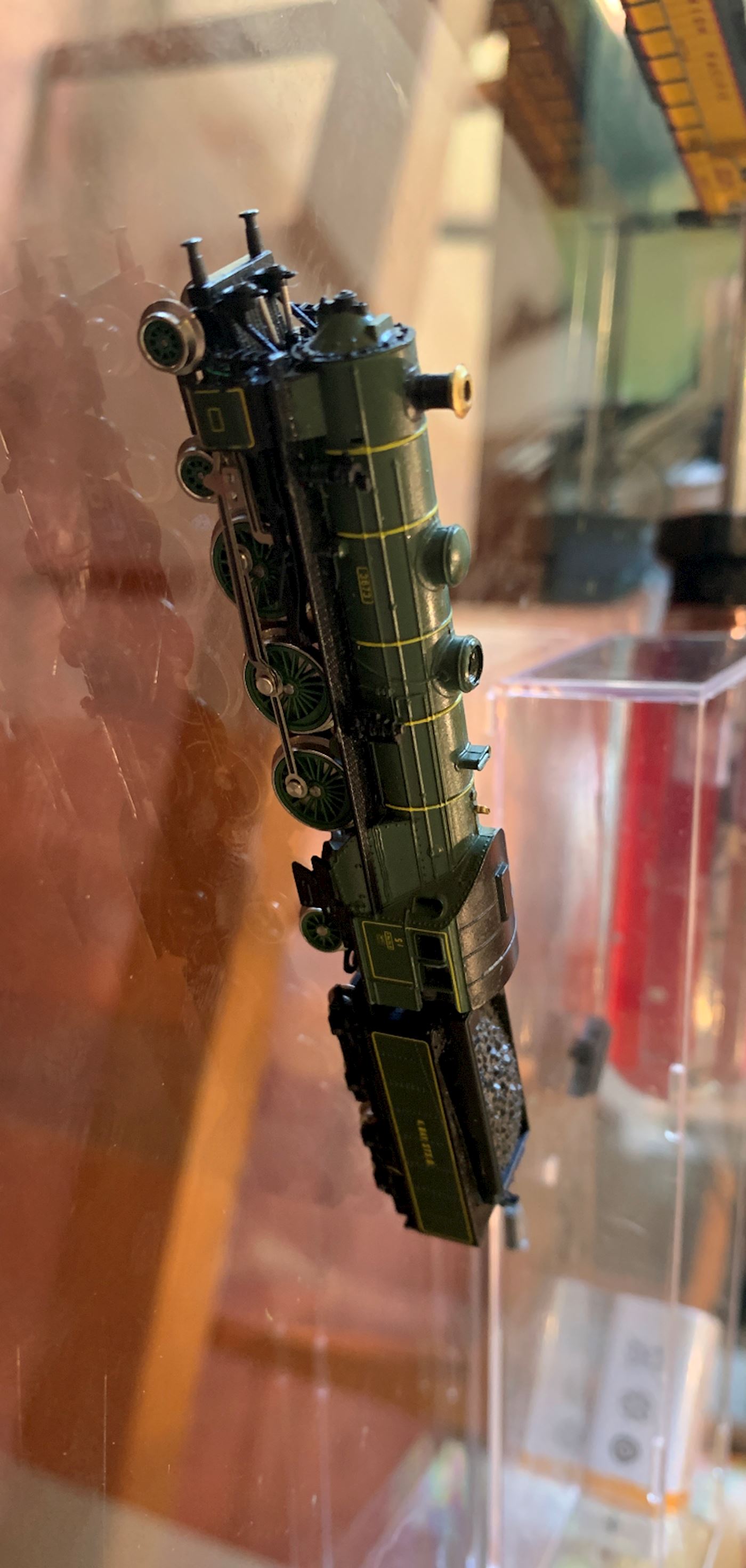

I recently acquired a Märklin Z scale Bavarian S 3/6 locomotive (Märklin 8892), but I’m having some issues running it. The light comes on when it’s on the track, and it changes in brightness with the controller, but I can’t seem to get it to move. I looked at the motor area of the locomotive, and I saw that there were some metal pieces that weren’t connected, but I’m new to Märklin so I don’t know if they’re meant to be or not. I’ve attached photos of what I’m talking about1A1DA7BA-EAA8-4590-83F8-0ADEC688FAEE.jpeg98B2F4E8-77C9-4A32-B4E8-FD7556FFF6F4.jpeg74833364-2092-41C6-83CE-FE7742A3AB14.jpeg9BBFEC1B-3F92-4715-8612-5EE4349A8932.jpegD6139384-9236-45FB-8CB4-D0C63A1B7C4B.jpeg
Trogbahnen
I'm not familiar with this locomotive, but there seem to be two problems - firstly that there are no motor brushes (I'm assuming that you didn't just remove them to make the photo clearer) and secondly that there is no contact onto the motor itself.
You can identify which brushes are needed from here : http://www.zscale.org/articles/fivepole.html#table
In many diesel locomotives there is a pair of fine wipers which contact onto the motor. That might be the case here, otherwise it's fairly obvious where the wiring from the chassis should connect to the motor - if you can bend things to make contact a couple of small blobs of solder should do the trick.
Hope this is helpful, all the best
Chris

The metal pieces that you say aren't connected to anything are the parts that hold the brushes in place so that they touch the commutator. I attach the parts diagram that shows this (though not very well) - the brushes are part #7.
Carim Marklin 8892 parts sheet.pdf (69kb) downloaded 36 time(s).
