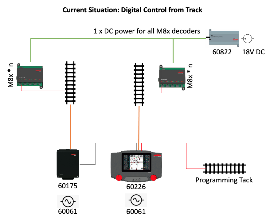

Dear All,
I am running my small layout with a CS3 and RocRail with about 10 m83/84 decoders and a few S88 feedback decoders.
Usually things are fine, but sometimes disaster strikes, typically in the form a brief short circuit (pickup shoe against high speed turnout, car derails, ...).
During that short-circuit I noticed a number of times that digital instruction (switch turnout, signal set, engine speed,..) get lost.
As a consequence I then tend to have a ghost train or a train stuck at a signal that RocRail thinks is green, but due to the lost command remained red.
This in my assessment is caused by the track carrying the commands for the decoders - which don't get there due to the short.
To increase the resilience of the layout I am currently thinking about putting the whole m83/84 control inputs onto a seperate feed, which isolates the commands from the track. Sure, that does not fix commands to the engines, but at least would keep the turnouts and signals correct.
Did anybody go down this path? Is it sufficient/advisable to maybe connect the m83/84s to the programming track? Should I invest in a booster just for the digital commands to the m83/84 decoders (feels like overkill, but would definitely remedy the matter )?

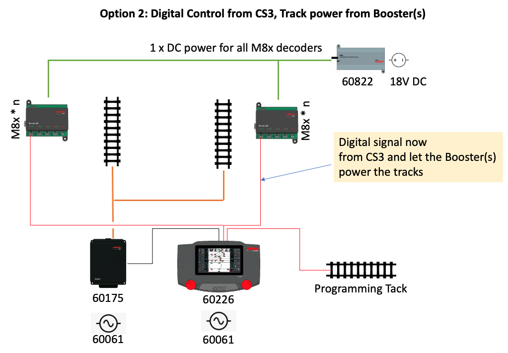

Jukka's reply assumes you have a 60125 in your device network. I don't see where you said that you did. However I also experienced the problem he talked about and replacement with a 60145 fixed it.
I also have all tracks and M83 decoders controlled by separate boosters. My CS3 and auxiliary CS2 do not power anything directly except for the programming track. From your description you could isolate things by adding one booster for track power and one for M83/M84 power.

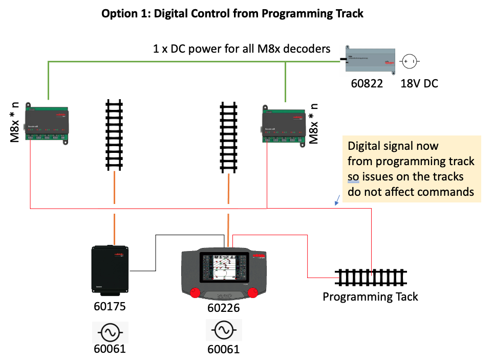

Thanks for the responses. Here is a bit more detail and rbw993 my option 2 below looks like what you are talking about?
I am really wondering if the programming track is sufficient for this purpose and/or if there are "side effects" when I use that in an "Option 1" scenario.
Notes:
  • Diagrams omit ground wiring and the switches I have to isolate the tracks. Not shown for simplicity
  • In option 2 an additional booster (+terminal) makes sense. Not show for simplicity.

Hi Tom
I think having a separate power line to all (switch & signal) decoders is better:
* you can use analogue locos while still control your switches
* sometimes a switch decoder may have an issue with the init at start, thus causing an over-current.
* use the programming track IMO is not a good idea (because you may need to program locos, because the power is limited while solenoids work better with powerful feed)

The reason I set up my device network that way I did is to isolate and protect the most valuable (or expensive) components from direct shorts or other current/voltage irregularities.

I have one booster for the m83 and m84 decoders, they have auxillary power supply with märklin versorgunseinheit.
Another booster is connected to the track, for driving the trains.
Nothing is connected to the CS3.
The idea is to protect the CS3, a shortcut blew the "endstufe" the CS3 worked perfectly normal but no power to the trains.
