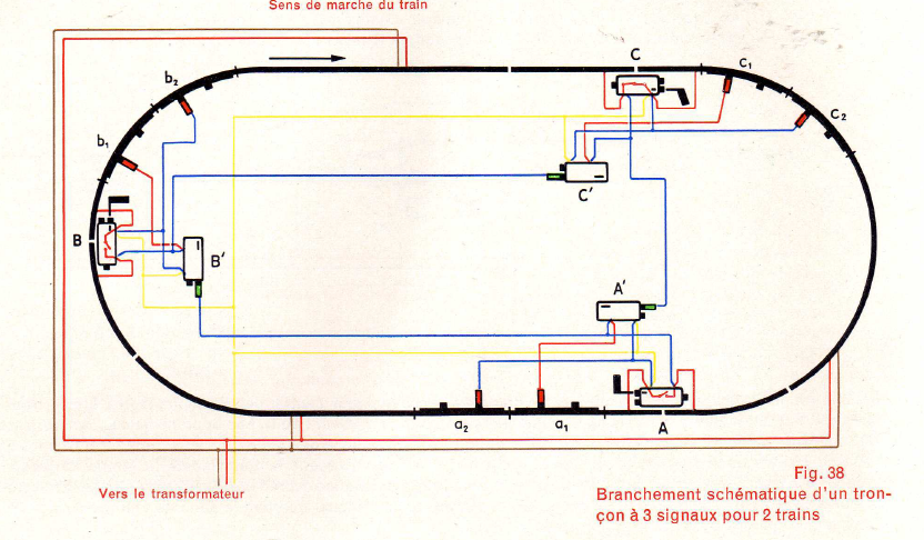

I have an analog layout with block signalling using M track. I am running three trains on a 4 block system. Unfortunately as foreseen by Marklin in p 43 of (English) version of the 0341 Signal handbook (1967) trains going at different speed eg rail-car v long goods tend to overrun the blocks.
I have therefore installed the 7045 universal remote control switches wired as shown in the handbook with each block . Unfortunately it is not working . The trains switch the signals to red on the appropriate contact rail but they do not switch the signals to green at the appropriate rail.
Has anyone used this system and can offer advice on what I am doing wrong.

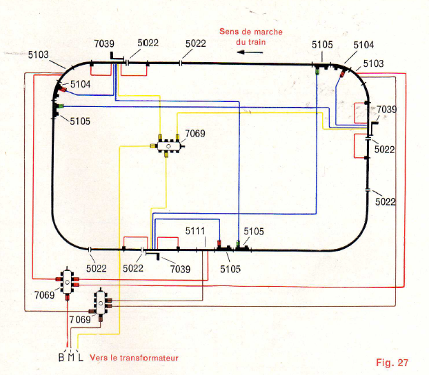

Here is the basis schematics for a loop with 3 blocks
Here is the more sophisticated loop schematics

The reason I use the 7045 is following the 0341 Signal Handbook advice , which identified that in some circumstances trains my overrun the blocks and catch up the train in front. This was happening on my layout due to a combination of slow and fast trains, different lengths of block stretches and possibly the location of the contact rail. The simplest solution seemed to be to install 7045 as per the diagram Fig 43 an h explanations on pages 43 and 44. I would like to be able to post that here but I have not yet mastered including illustrations on this site!
At the moment the second schalt glens is functioning correctly and switching the signal to redbud the first schaltgleis does not turn the signal behind at green as a the handbook says it should do.
I may try sending an email with attachments to show what I mean, as I see an email link below your post.

Thank for those diagrams , I think I may have deleted one by mistake , but the important one is the Fig 38 you sent. (Fig 43 in the English version I have.) This shows the block system with the 7045 . (The 7045 are the ones marked A’ B’ and C’ in the middle of the circuit) I have installed them as per that diagram. When the train at C passes over C1 nothing happens, though the instructions say that it should, through the 7045, change Sig B and C to Green and release the train at B . On my circuit Train at C does go on to C2 and change Sig C to red thus stopping the following train coming from B as required.
It would be interesting whether the French instructions suggest this is how it should work
If auntmartha is following this Jeans Fig 38 is the one I failed to email!

Offline Martti Mäntylä
#11 Posted : 17 February 2021 22:49:10(UTC)
Martti Mäntylä
Joined: 15/11/2018(UTC)
Posts: 436
Location: Uusimaa, Helsinki
I have not used this circuit myself, although otherwise I have used universal switches for various purposes. Now my curiosity is awakened so that I may actually try and build a test circuit to see how well this one works.
This is a fairly complex circuit which is easy to get wrong, so please double check the connections. If indeed, say, the circuit track c1 fails to turn signal B and universal switch B' to green, the simplest explanation is that the cable from switch C' to the B and B' is hooked to the wrong output socket of C'.
It is also a good idea to test that the switch outputs work as intended; sometimes the contact surfaces inside the switches need a bit cleaning to establish a good connection.
I just add that, as you may have noticed, the Märklin diagram (Fig. 38 shown above in Jean's post) has a small error: the red cable from switch A' should be connected to the first connector of the switch track a1, not the second.
- Martti M.

#12 Posted : 17 February 2021 23:24:17(UTC)
Posts: 3,696
There are no principle explanations with the French booklet.
How it works
* each signal (& stop section) is followed by 2 contact rails
* the first contact rail sends the impulse to the previous signal green and the previous relay green trough the relay while in green position
* the second contact rail turn the signal into red and turn the relay into red thus interrupting the command green to the previous signal and previous relay
The net result is no matter how long the trains are and what their speeds are, the signal is turned to green only during the period starting when the train reaches the 1st contact rail and till when it reaches the 2nd one.
On the other hand the signal is turned to red by each car rolling on the 2nd contact. (Red is activated for a long time while green is activated during a couple of seconds).
Of course, it is easy to connect the relay the other way around which result in not turning the signal to green.
This schematic is a clear demonstration on how the circuits were complicated before digital.

As I indicated earlier, I decided to implement the circuit to see how it works. The test setup is shown in this short video:
For my purposes, two signals and two 7045's were quite sufficient. (Actually, one of the switches is a former signal that had lost its mast and got a new job.) Indeed this is a bit tricky to get to work, especially as my circuit tracks took a bit time to warm up for proper work. Also one of the signals had initially precisely the kind of contact issues that I alluded to earlier.
Whether the circuit solves the original problem David had remains to be seen.
David, I save my photos to imgur.com to post them on the forum. I find the service well suited for the job. Probably other similar services would apply equally well.
- Martti M.

1 it would be great if you could do some test circuits and let me know how you get on.
2. On your point of wrong connection - I have wired it as per the diagram in the left socket opposite the manual change lever. I will switch them over and see if it make a difference!
Incidentally the way I have followed the diagram is to take the lead from C to C2 and also from C’ to C2 and joined them both in the C2 socket ..and so on with the other blocks. I assume that is what they want!
3. I would like to test the remote switches to see if the solenoids function- etc. Can you advise how to do this? Using the manual levers does nothing?!
4. Well spotted on the mistake in Fig 38 A’ and a1 v a2. I did not however duplicate that on my circuit.
One other thought. I have taken the yellow leads to lighting trafos not to the trafo taking current to the track? Would this make a difference?
Best Regards
David

Maarti just seen your test circuit after my last post.
Well done ! One difference is you seem to have two cable going to the remote green socket - one from signal in foreground? Where does the other one come from ?
Otherwise I think you do take a red to contact 2 direct from signal and the other from the remote is that correct?
Not sure how to save pics to imgur.com, they are on my iPad. Will have a look
D
#18 Posted : 18 February 2021 22:49:18(UTC)
Martti Mäntylä
Posts: 436
One cable goes to the previous signal, and the other to the previous remote control. E.g, the green socket of A' is connected to both signal C and remote control C'. This allows a1 to turn both C and C' to green (on the condition that A is green).
Yes. With this, c2 can turn C and C' to red again, for instance.
The brief experience of building the test circuit suggests that the main difficulty is to get the circuit tracks to operate properly. My circuit tracks have been unused for a long time, and they needed some attention before they started to work. The V200 shown in the video did not always manage to engage with the switch in the circuit tracks solidly enough to make a good contact.
Like I mentioned, one of the signals failed intermittently to provide power to the stop tracks due to poor contact. This is fairly common and can be fixed by cleaning and adjusting the contact surfaces. Of course, also the remote controls can have this problem.
I test the contact surfaces by hooking the 7045's to a 7074 lamp to see if I can turn it on and off by engaging the manual switch. You could equally well hook the 7045 to the red plug of a 5103 feeder track, place a passenger car with interior lights on the track, and flip the manual switch. Of course, signal contacts can be tested the same way.
- Martti M.

- Connect the red cable of 7045 to the trafo.
- Place a car with interior lights on the feeder track.
- Apply some voltage with the trafo.
- Now you should be able to switch the interior lights on and off by moving the small hand lever of the 7045. While at it, switch the red cable of the feeder track to the red output of 7045 and test it too.
- If you want to test the solenoid as well, connect the yellow cable of 7045 to the trafo. Also connect the ground socket of the 7045 (on the opposite side of the green and red outputs) to the brown of the trafo with a short cable.
- Now you can engage the solenoid by touching the rails with the plugs of the two blue cables. Or, if you prefer, use a 7072 switchbox to control the solenoid.
- Martti M.

Martti,
Quite a sucessful day , tested four 7045 as you suggested and working ok so buil test track with three blocks. The relays are workin but unfortunately I am having to use old signals from my spares box and they are sticky and not always changing as required. I hope to get some new Signal sons , but I learnt enough today for me to now dismantle my main layout blocks, test the relays and rebuild checking all wiring.
So many thanks, will let you know when it’s working!
Best Regards
David
#23 Posted : 20 February 2021 21:58:38(UTC)
Martti Mäntylä
Posts: 436
Hi David,
Very good!
Do not despair with the sticky signals. Much of the time they can be re-invigorated just by cleaning the contact surfaces with isopropyl and/or adjusting them. I also use electronics cleaning fluid that can be used even to make the solenoids more responsive.
- Martti M.
Offline David240945
#24 Posted : 24 February 2021 21:56:34(UTC)
David240945
Joined: 10/01/2020(UTC)
Posts: 39
Location: England, Swindon
Martti, SUCESS , having proved the system with the test track and got that working well, with a few changes of signals and sticky slider contacts, I redid the inner circuit of my main layout and rewired and tested signals, relays and contact rails. Some relays were grubby. Today I got it working well and three trains now run well on a four block circuit. The blocks are of varying lengths and the trains different speeds and loads and the blocks with the remote relays are managing them well. So a great step forward!
BUT - I found some locos a bit sticky, so went to give them a run in on the three block test circuit, which had been working perfectly the day before.... only to find some of the circuits were not working. The layout copied the one in the manual and contact a2 was not releasing Signal A to go and contact c2 was not releasing Signal C to go.
I switch over the green plugs on relay A’ and B’ and that seems to have solved the problem. But I can’t understand why the normal wiring has failed or why switch over the plugs worked ! ?
In the process I have noticed that when the contacts trigger relay signals A’ and B’ the solenoid operates and the manual lever moves. But it does not on relay C’, although Signal C works. I notice also, on my properly functioning main layout, none of the solenoids/manual levers move when triggered by the contact rails but the signals change OK.
Have you any thoughts on this?
My next step is to dismantle the test track as I need the relays to get the outer circuit of the main layout working. In the process I will test them again and give them another clean.
Best Regards
D
#25 Posted : 25 February 2021 02:08:18(UTC)
Martti Mäntylä
Posts: 436
Nice to hear that you are making progress. Nevertheless, the cited description above gives me a bit uneasy feeling.
The contacts a2, b2 and c2 are intended to turn the signals A, B, and C as well as the relays A', B' and C' to red = stop, respectively. The task of turning the signals and relays to green = go belongs to the contacts a1 (for C and C'), b1 (A and A') and c1 (B and B'). This was nicely explained above by Jean in post #12 of this topic.
If the signals operate as intended, but the solenoids of the relays stay still, the circuit is not working as intended. The relays are permanently on green or on red; in latter case, the related signals will turn to green if their green plug is inserted to the red output of the relay.
Please check again the wiring. Make sure that the green outputs of the relays are connected both to the green controls of the previous signal and the previous relay.
- Martti M.
Offline David240945
#26 Posted : 02 March 2021 21:18:33(UTC)
David240945
Posts: 39
Martti,
Thanks for your last post, I double checked all the wiring and it was ok, but I still had problems. Eventually they seem to be a combination of sticky solenoid and sticky camshafts on the 5146 type remote control contact rails. I have now dismantled the test track as it has served it’s purpose and taught me a lot, thanks to you.
I have to say I find that the Slider type contact rails are very unreliable, more than 50 % of mine are unusable and they have hardly been used. I prefer the old contact rails despite the risk of burn out if a train is sitting on them. Unfortunately with outer radius tracks one has no choice
I have had success though in getting the inner circuit of my main analog layout working well with a three train four block system. I have noticed however that if, the trains and blocks get out of sync, which can happen with a sticky contact rail or a derailment etc, that it takes a few circuits for the system to get working properly again. The key is reliable remotes, signals and contact rails.
I am now working on getting the unreliable 7045 and signals cleaned up. Some had quite oily contact plates
- Do you bathe the whole item in isopropanol ?
- Do you have any advice on removing the solenoid - it seems possible if one bends the metal stop that sticks up from the base plate, but I am reluctant to do this if there is no point.
- any thoughts on how to get slider contact functioning better, I have tried dismantling them and oiling the cams at the base end , bending contacts slightly etc.... with no good result!
I now have to turn my attention to getting the other circuit working. Unfortunately it has a short somewhere which will take some work to eliminate as the wiring is complicated and parts rather inaccessable but that’s another story!
My best wishes
David
